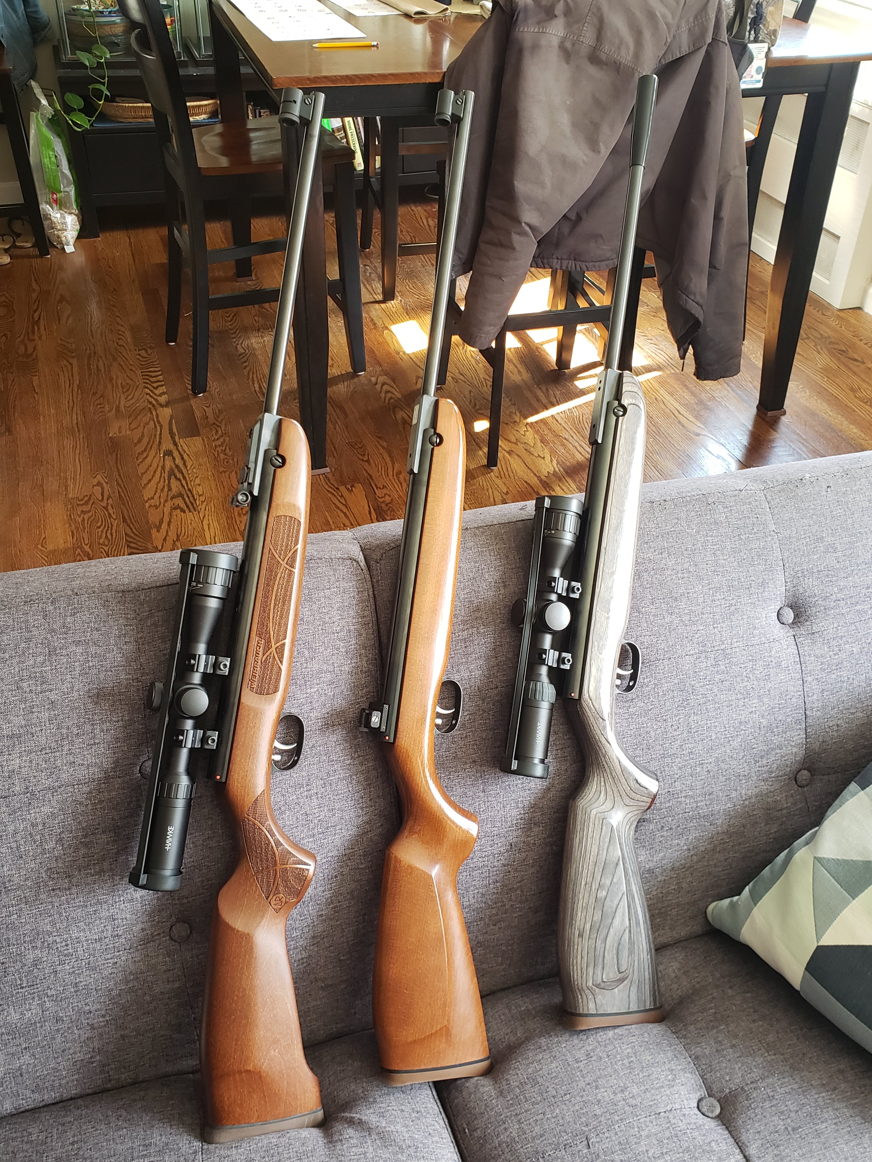

Hawke Airmax 3-9x40 on my Beeman R7 .177. Could have easily left the open sights on it and not seen any ghosting from them in the bottom of the scope,, but had an Apex muzzle weight I wanted to finally try so they came off and safely stored away. Just gave it a lower, smoother look.
Also have an older R7 in .20 with the same scope on it, although that one has a bit higher rings and I left the open sights on.
