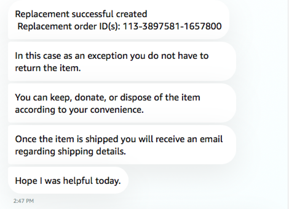

Here's the important part of the chat text:

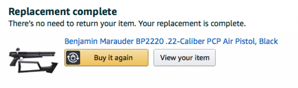

Here's the old gun:

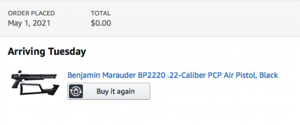

Here's the new one:
