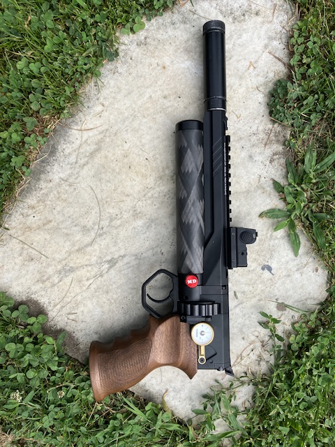

I have the Huben supressor for my .25 cal. It is still a bit louder than I would want for my yard with neighbors 50-100ft away. I want 4/5 on MrP’s scale in above post and I’m at 2/3. To me it sounds like striking a piece of rebar with a hammer. I could try turning down the power but accuracy suffers under 800fps. I probably should have bought the .22 cal because the .25 is more power than I want to use in my yard anyway.

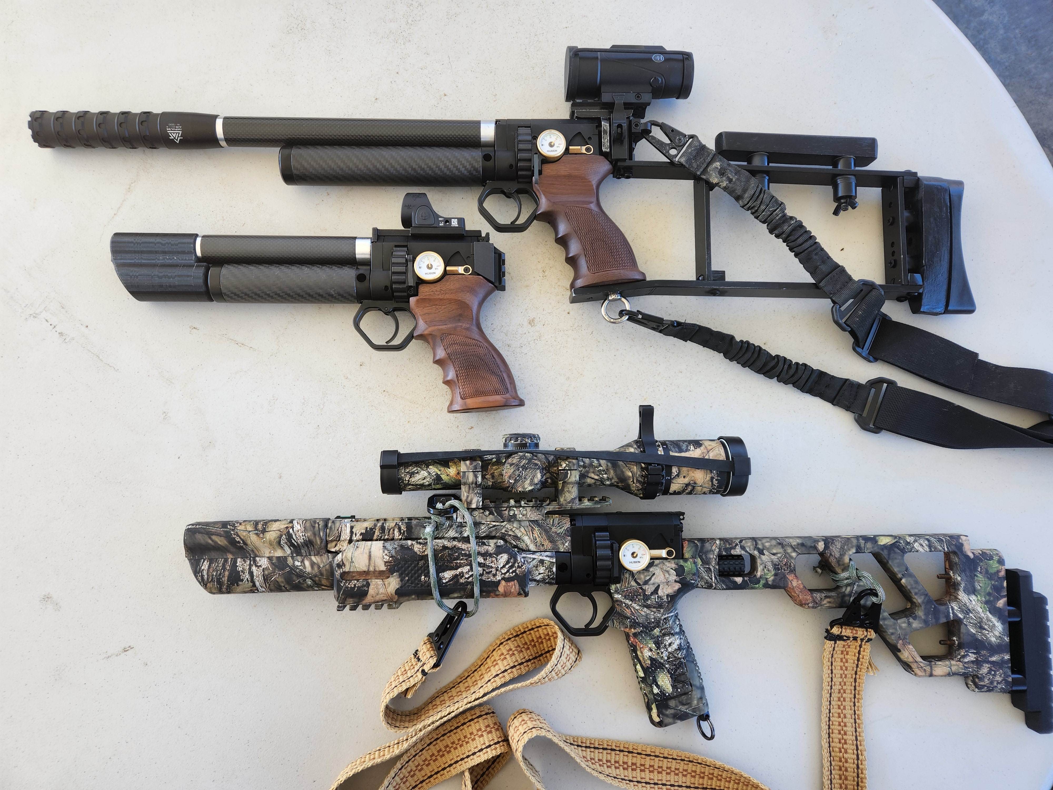

Humad mod 40? Or mod30 I can't remember which one, it's the shorter one that's a 3 piece with the kevlar. That's been amazing on mine from 20fpe up to 72fpe on my .22gk1. At 20fpe from 5 feet away it sounds like the action is moving. You could likely take off one of the stacks if you're gonna shot 12fpe and be more than quiet enough.
