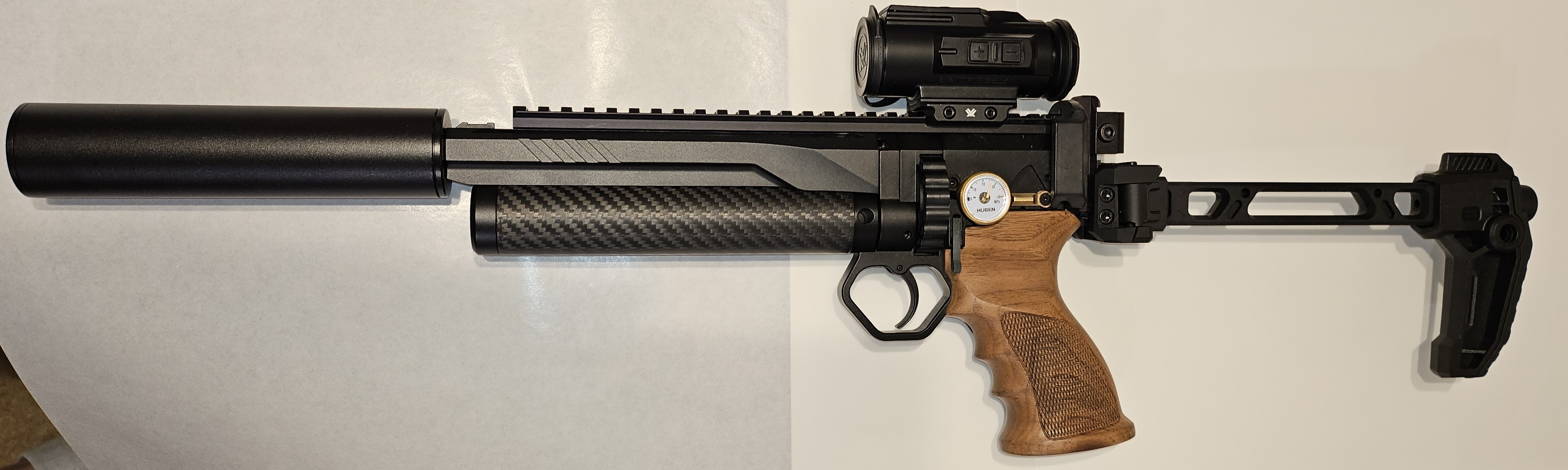

I think I am going like this 1X Raider. I set it back this far because it will be closer to my eye when I don't use the stock. I have been shooting it without glasses setting the diopter. Very clear. It's so lovely to look through compared to a reflex. I have not stretched it out yet. But I have been hitting nickle size spinner every time over 20 yards. Also, I had to remove some material to make the T-bar flange flat. An angle would be easier. I can see the front part of the Impulse at 6 o'clock, which is not enough to be an annoyance. So, I could not mount the Raider any lower. I am going to shoot some more. :) I have a 1X PA & this is more pleasing for me to look through, maybe just me.

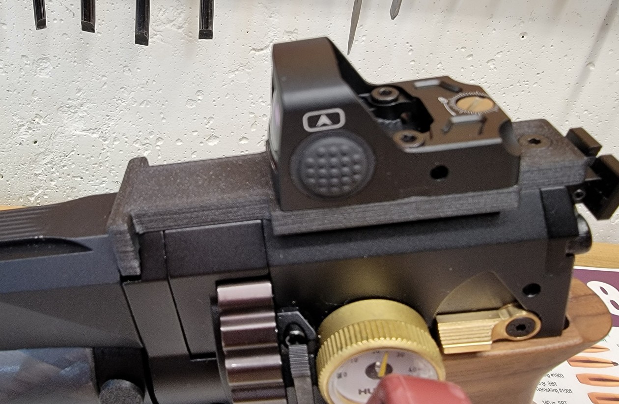

There is an idea in this pic which isn't fully formed: an upside-down L-shaped adapter with pic rails on both outer surfaces and 3 sunk holes - 2 for the receiver back cover screws and 1 for the sight screw.

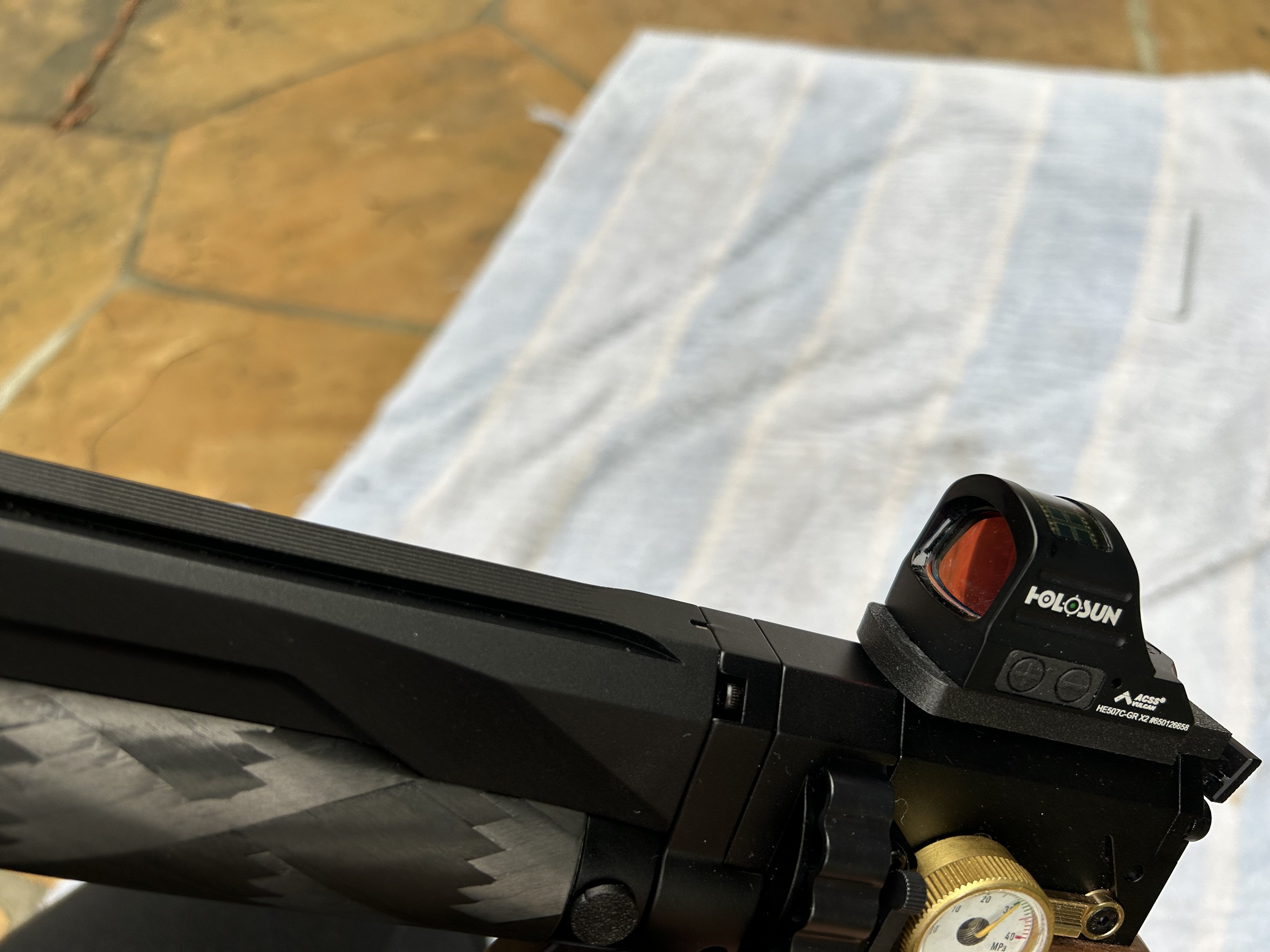

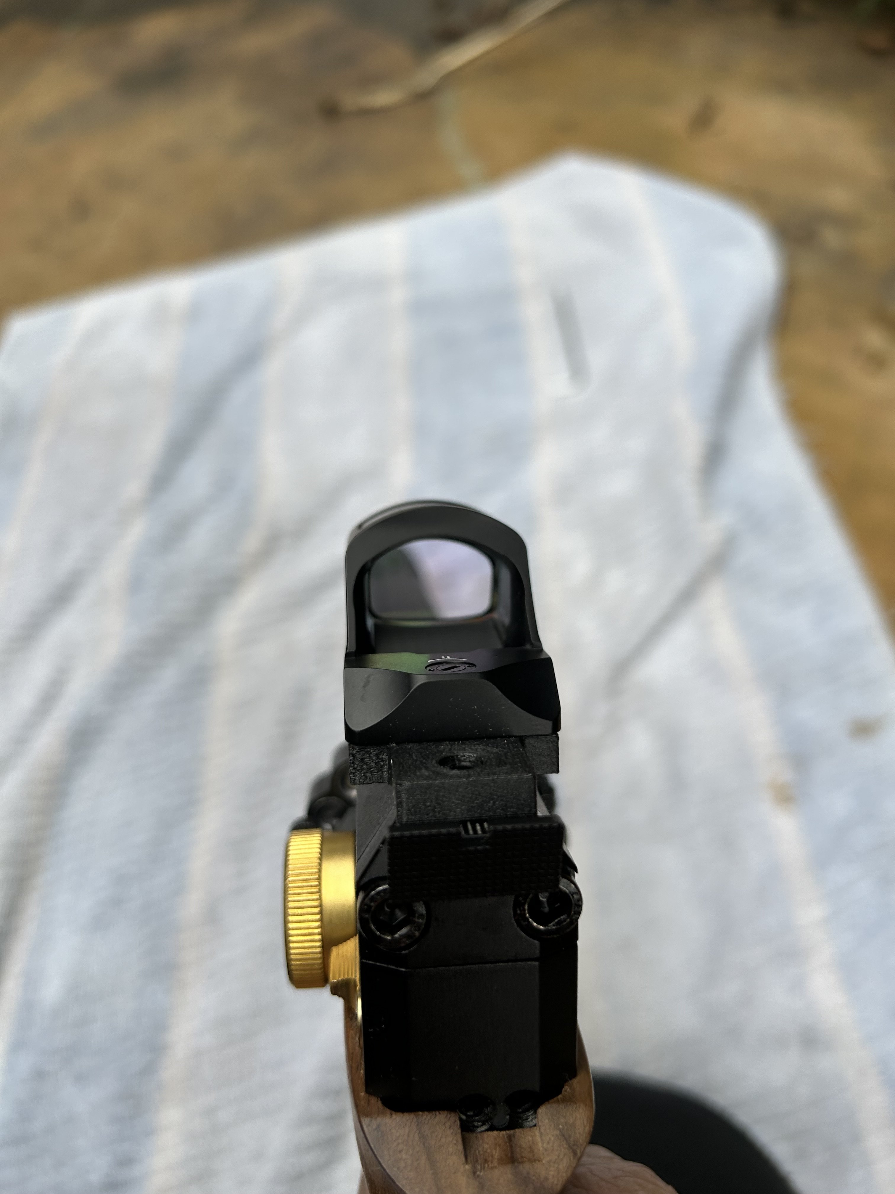

Here's another reflex sight on one of the @M0ist0ne sight mounts. Nice and solid 3D printed mounting solution, and his easy access loading gate is pretty sweet as well. Found here...

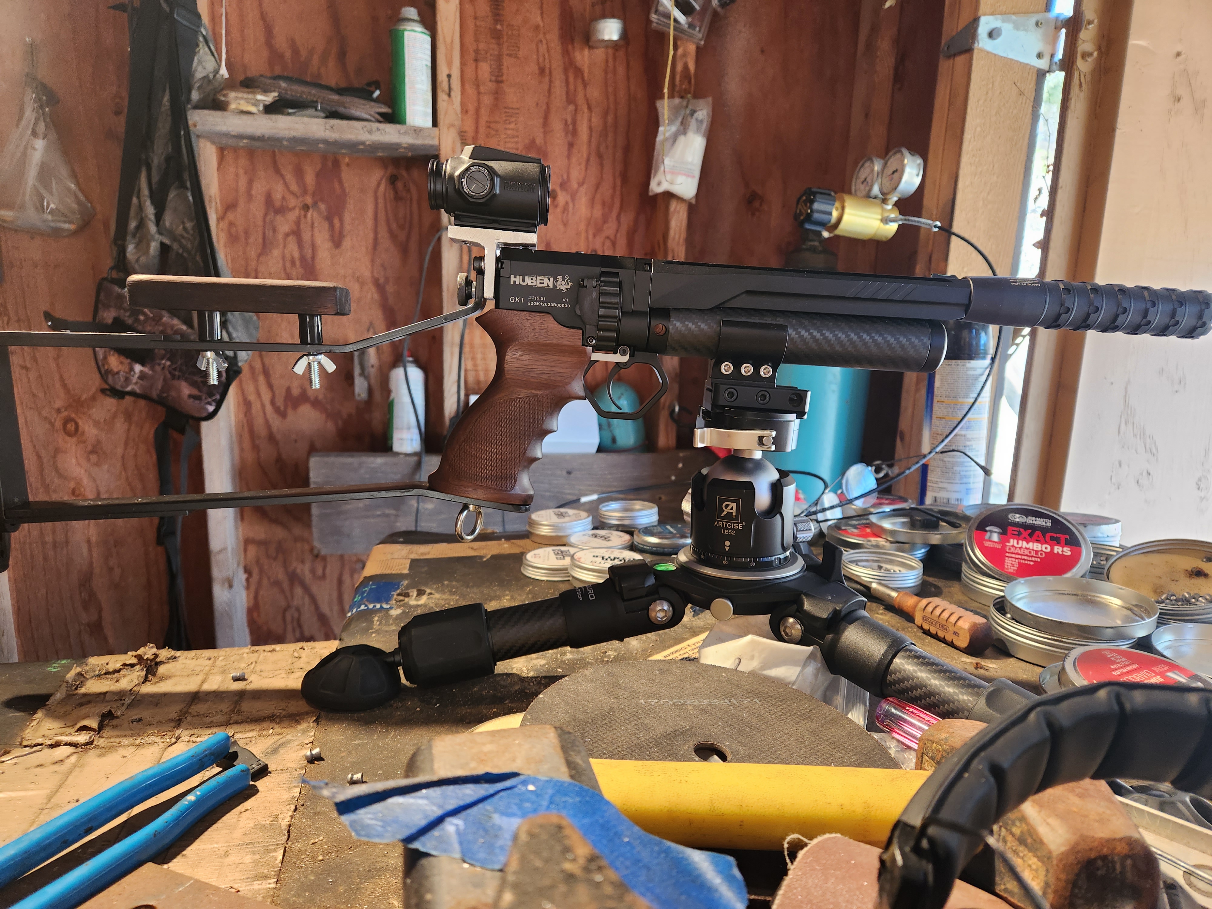

I have my red dot and magnifier mounted to my GK1 (check my previous posts for information about the sight and magnifier). It’s a lot heavier than I’d like, but it’s accurate so far as I’ve shot it. I’ve only been able to shoot two magazines of pellets—and only at about 10-15 yards away—because of the weather being lousy (I live in Newark, NY; basically right in between Rochester and Syracuse), and being busy with life. Along with the picture of my Huben, I’ve included a pic of three H&N Baracuda Hunter Extreme pellets (The first two pellets are face up, and the third pellet is face down). The first one hasn’t been shot; the second one, I think went through a piece of thin (approx. 1/4”-3/8”) OSB; and the third one went through a squash (you can see a bit of yellow-orange from it) that was probably 6” thick where it penetrated. Both pellets were retrieved from a pellet trap placed behind the targets that is generously layered in duct sealant, thus allowing me to retain them without further deformation occurring beyond what resulted from hitting the targets.

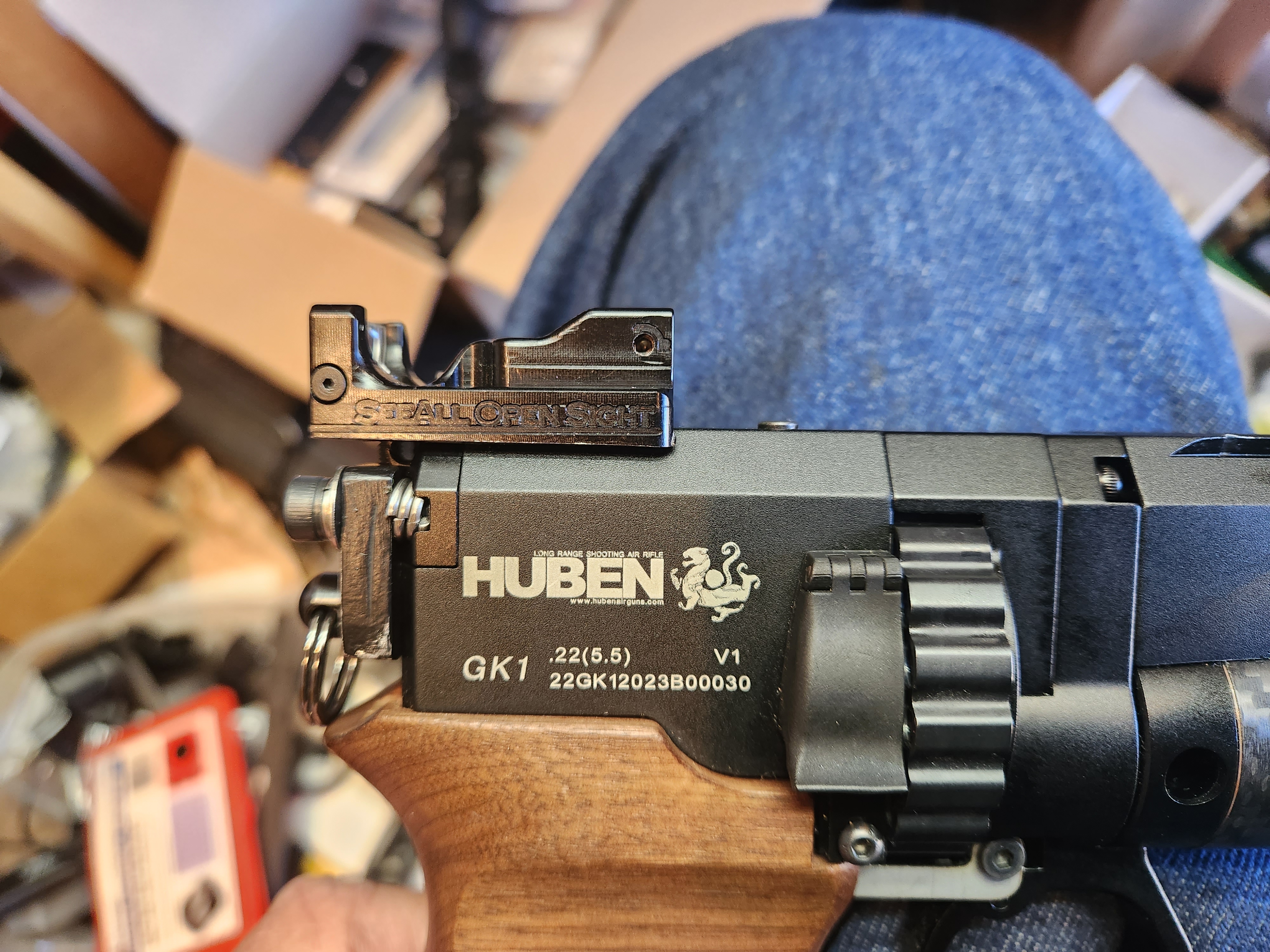

How did you mount that see-all to the huben??
I drilled two holes in the sight. I utilized the hole that is used for rear sight elevation. I drilled another hole in the rear tab that I had made. So, I had two screws securing the sight. I had to file down the bottom of the sight for it to fit as you see in the photo.

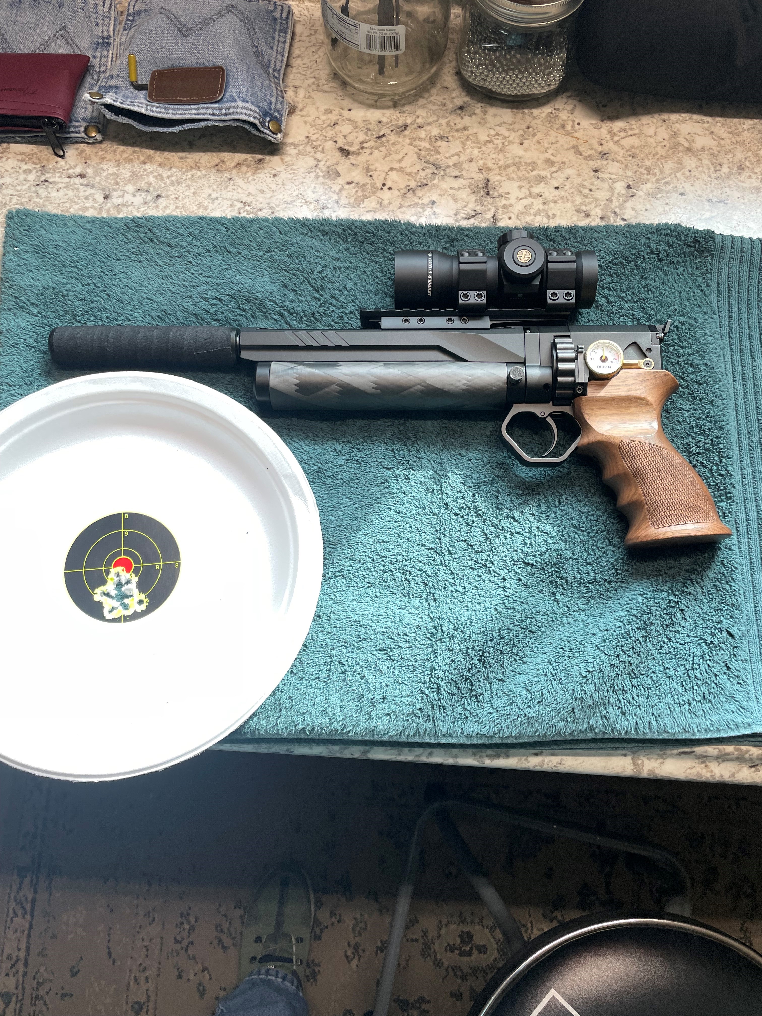

It‘s my favorite sight. I like the 1moa dot. The target in the picture is 23 measured yards off a rest….17 shots.
I have two shrouds each set up with several different sight systems. I’ll take pics and post when I get some time….maybe this weekend
