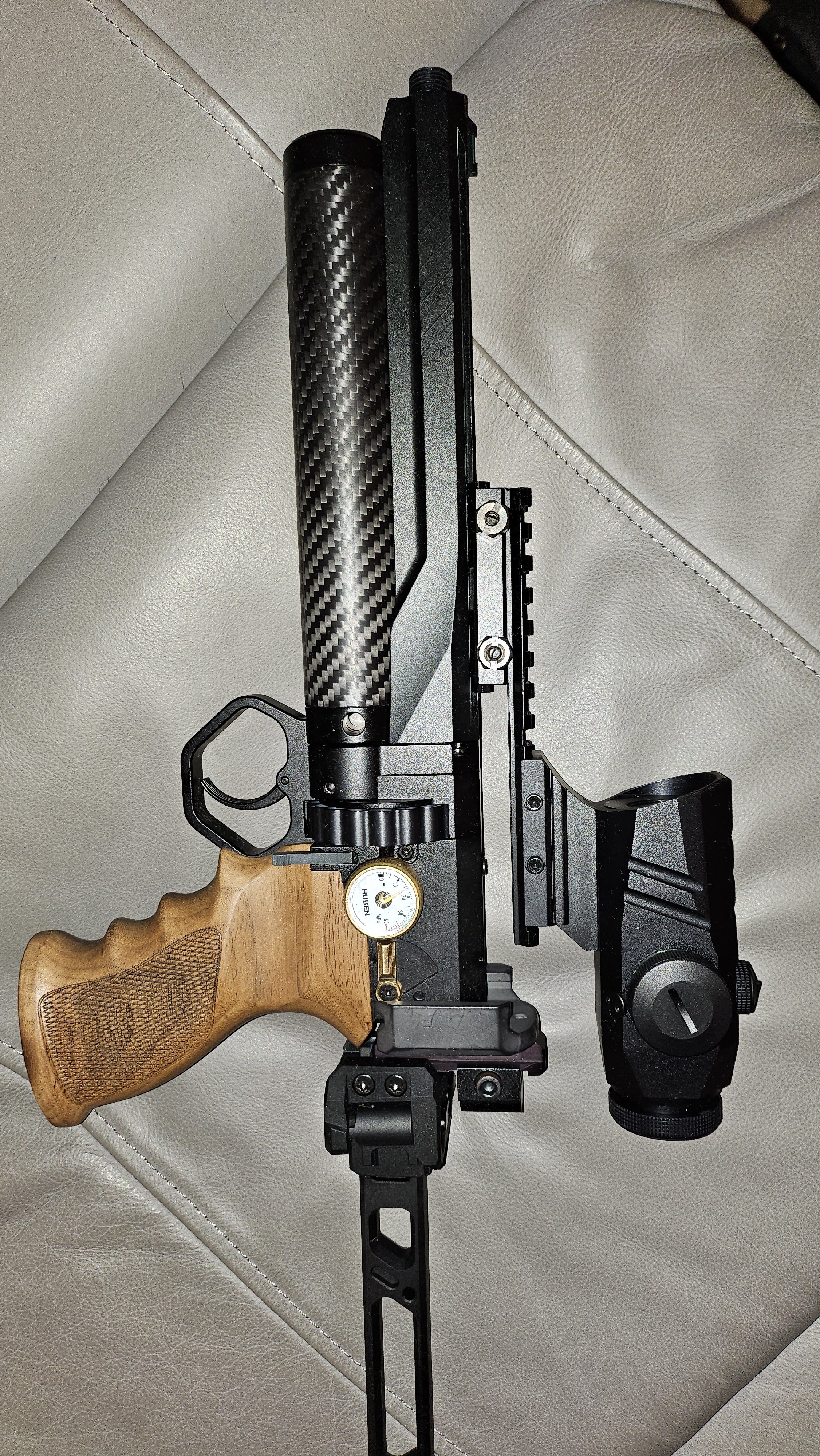

Another option to mount an optic farther back is a cantilever
Btw, I don't like this monstrum. It doesn't have the 6" claimed. Also, it is too dim.

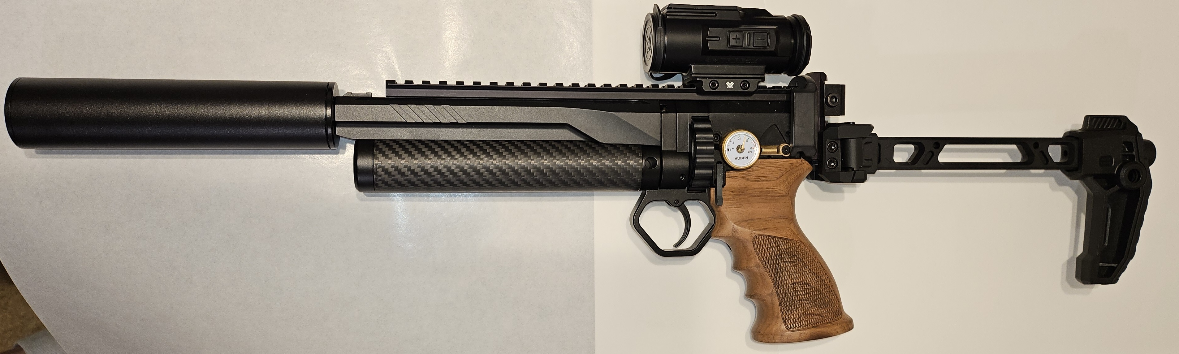

Will have another mounting option soon.
Is that a folding stock attached to your pistol?! How did you mount that?!?!

Franck404. I drilled holes in the shroud and drilled in the rail to match the existing bolt at the back for the sight.
With the shroud removed, After much trial and error, I bolted the rail to the shroud. There is very little room next to the barrel, so I ended up with the bolt heads inside the shroud and nut on the rail mount holes.
Thank you for the answer.
The result is superb but I won't risk drilling the shroud.
