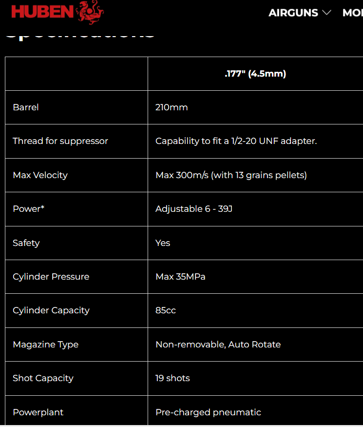

Huben GK1 .177
Will you get a GK1 .177? Why or why not?

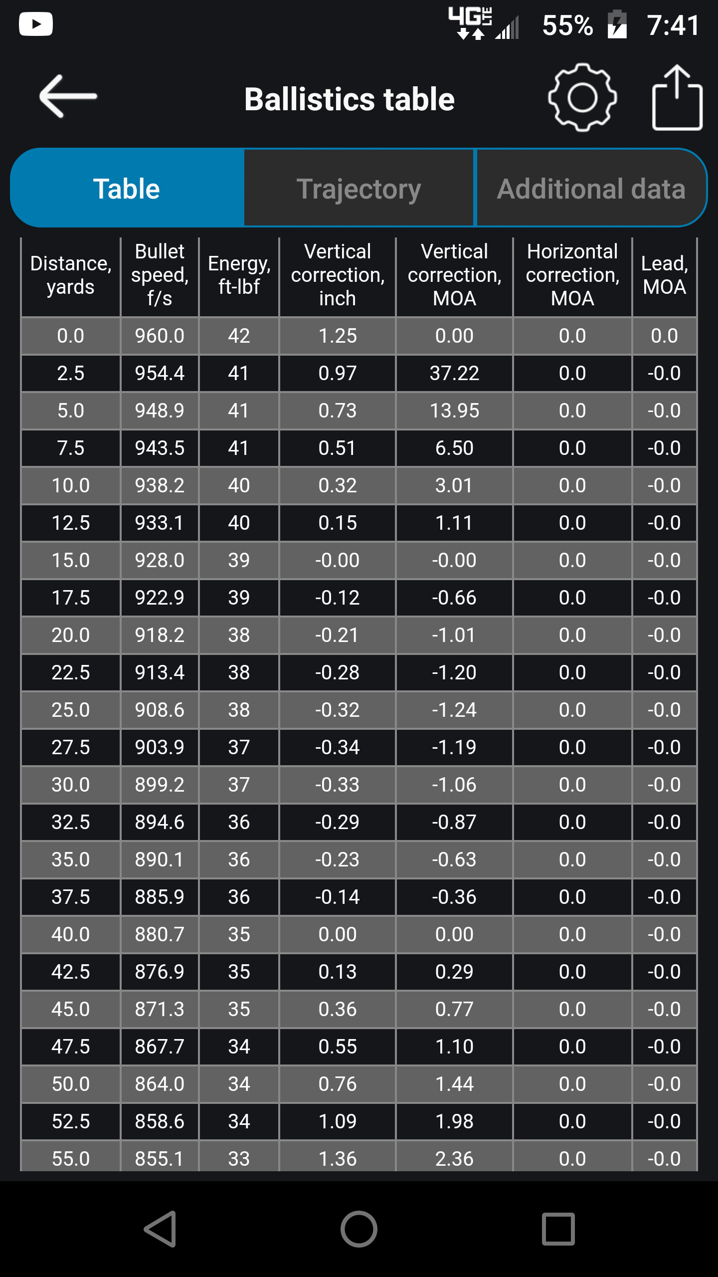

Shot with rws supermag 9.3. From 300b to 160b
JSB .177 7.33 gr
Weather: 84.7°F 3.4mph clear sky 1014hPa/mbar 29.94inHg 63%
Shot count: 113
Low: 494
Hi: 629
Avg: 561
STD Dev: 34
Spread: 135
9/16/24 9:40:56 AM,626,FPS,6.4,FT Lbs,
