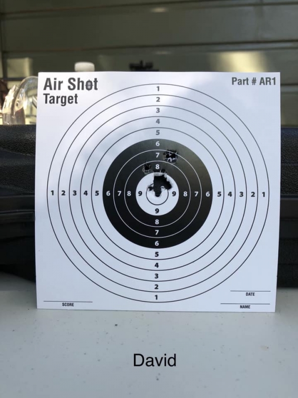

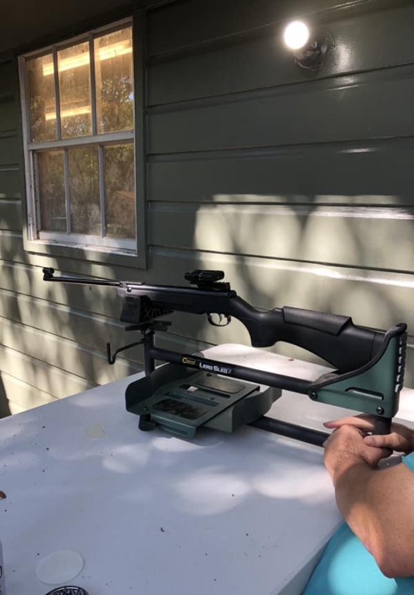

Weather was finally good enough to shoot the HW30 for the first time. My body is to crocked to use a scope currently. Instead, I mounted a green laser. We shot at 10 meters. We used the JSB Exact 8.44 .177 (4.53) straight out of the tin. I'm not sure I need to do any pellet testing at this point.
I have now ordered a cheap scope camera mount and camera to try and improve accuracy.
Lots of improvements needed to get a fully functioning handicap setup.
1. Better bench for benchrest shooting. The table is to shaky. Since it doesn't have to be transportable it should be easy to build.
2. Better gun rest to provide easier vertical and horizontal movement. Thinking about the NOTA Professional Benchrest.

Biggest problem is the farther out you go the bigger the dot gets. Even at 10 meters with the target I used above the laser covered the 10 ring and part of the 9 ring. I will try to capture a 20 meter picture for you with a scale on it.
