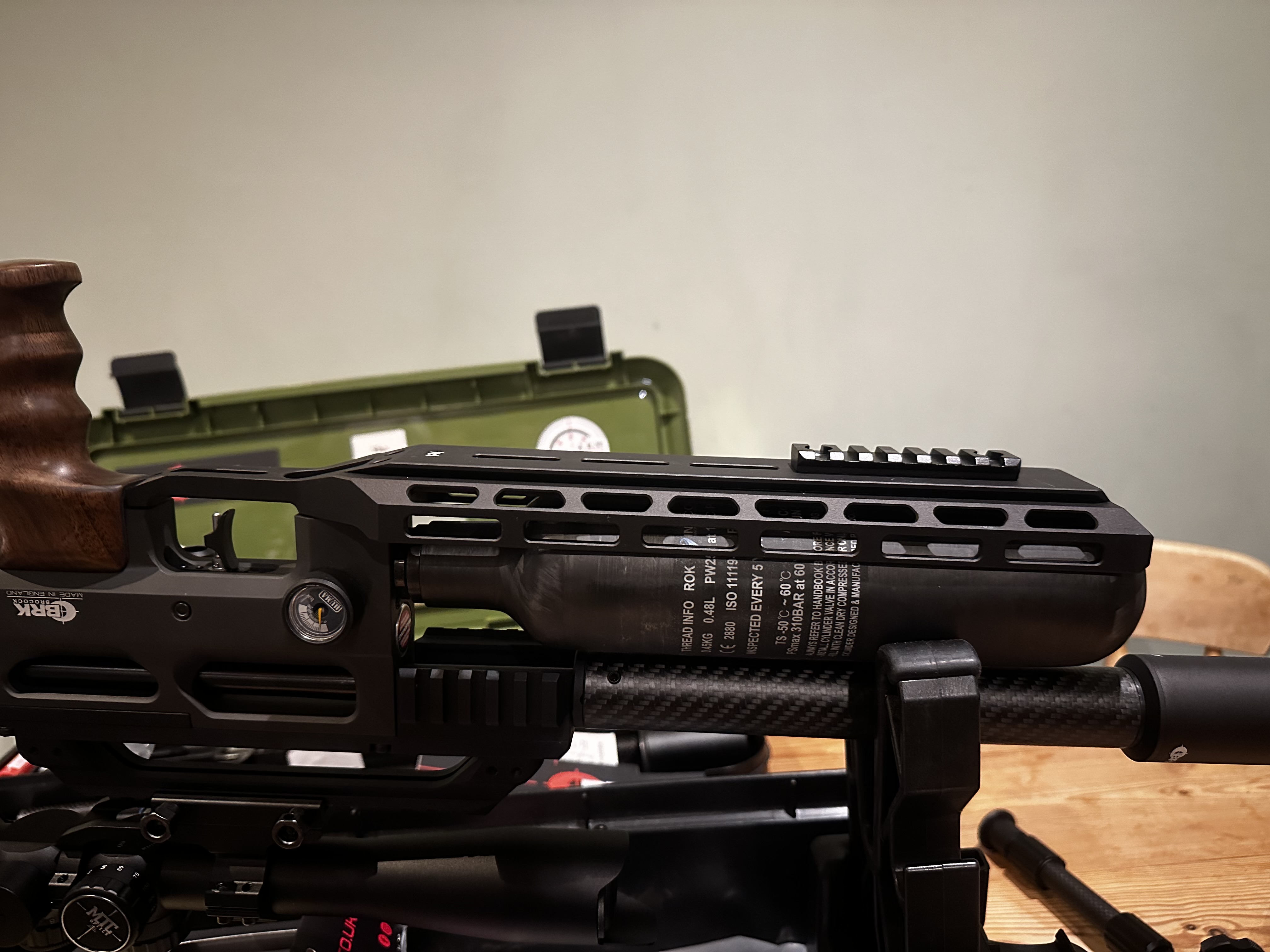

I’ve been using the PRS lower extension rail on my ghost for as long as I’ve had my rifle, well today that changed. I’ve upgraded to the BRK M-Lok / Arca rail. The design is certainly spot on for what I want and need. Adds a nice bit of protection to the whole underside of my 480cc bottle. I always thought the original rail was to short and the PRS rail helped a lot being about 1/2 the length of my bottle ( I’ve included pictures of all 3 rails to show the lengths ).
The extra weight of the rail is noticeable but not over the top, I don’t really do many free standing shots as I use shooting sticks or my bipod.
The weights of each are as follows-
Original 38g
PRS extended rail 252g
BRK M-Lok / Arca lower rail 348g.
Overall I’m try happy with how it looks and the quality is second to none! If anyone is thinking of getting one, just do it !!
