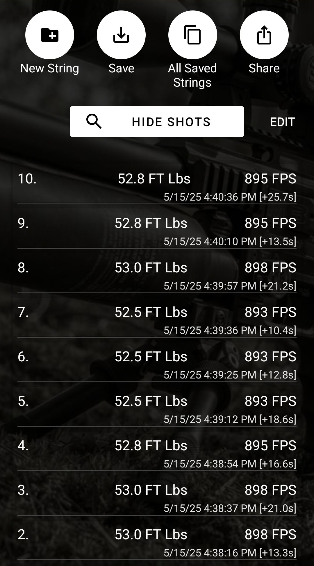

Ok ok, now onto the tune. This is with JTS 29.63 gr .25 , I think she's pretty right.
Also, pictured is a 30 shot groups on said tune at 50 yards. Running on 2 hours of sleep in 40 hours, I'll take it :)

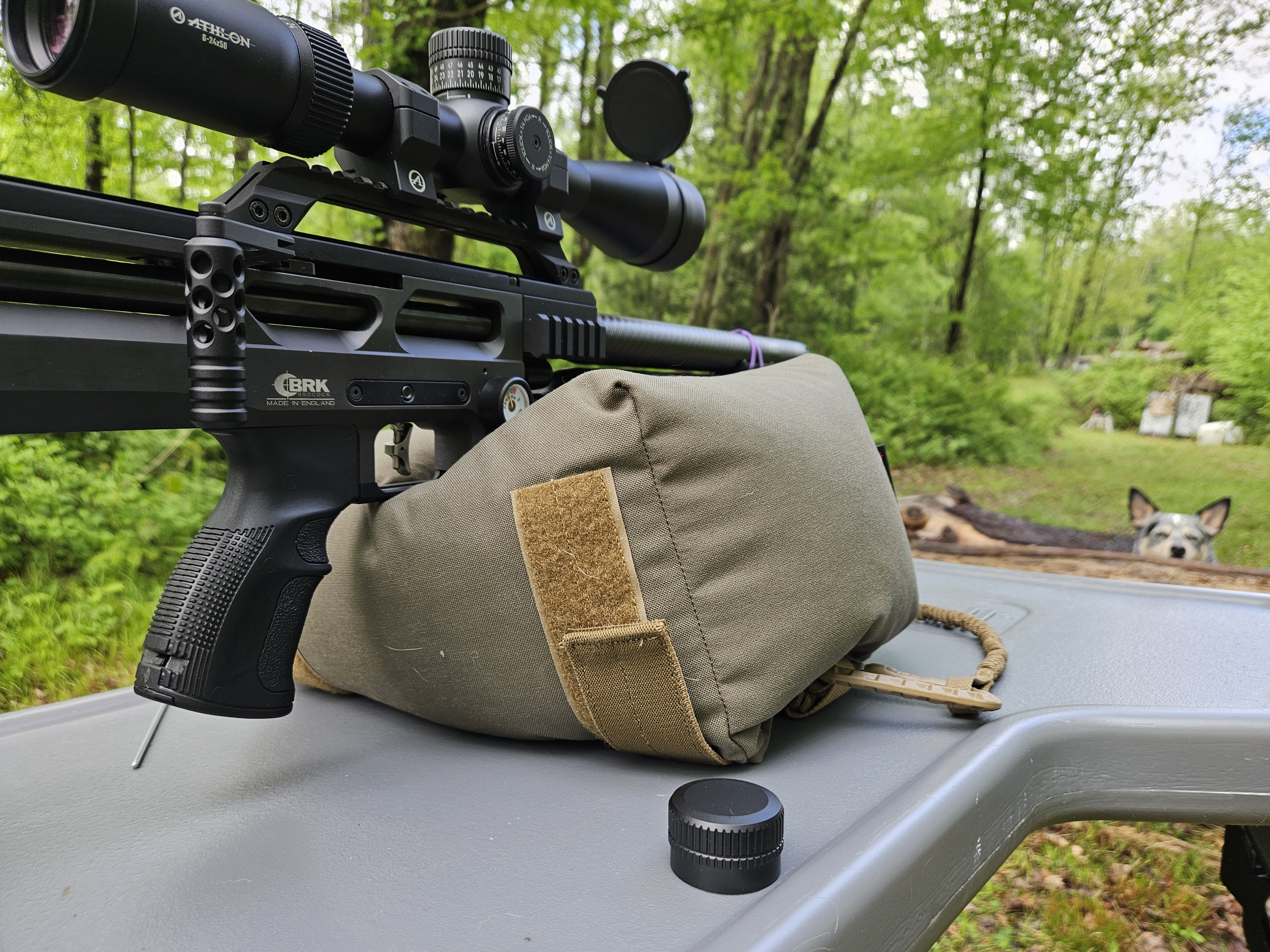

So , after grooming the Holey Fridge range. I said damn, let's see if this thing is as easy to tune as everyone says it is.
IT IS.
I wanted to do this out on the shooting bench to test this, well unscrewed the bottle quite easily, dry fired the air left in the rifle out, wallah, downward adjustment here we come.
I love it , seriously too easy for a rifle that can't be adjusted under pressure.

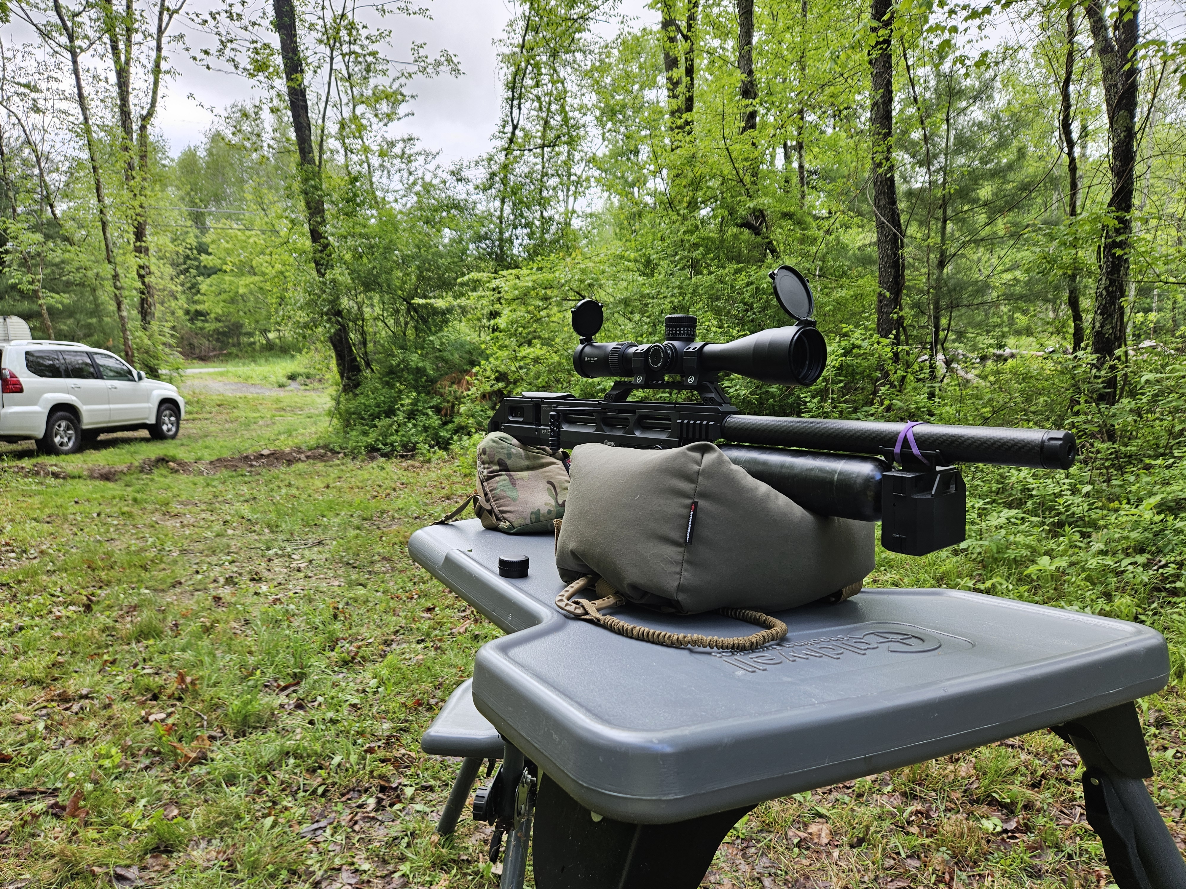

I am waiting on a sabertactical picatinny extender so I can use my Goliath, shooting at the bench off a bag seems so unnatural , although my Armageddon fat bag makes it better than my last outing. Shooting off a bag when pesting feels right, just not here 🤷‍♂️
View attachment 562918View attachment 562919

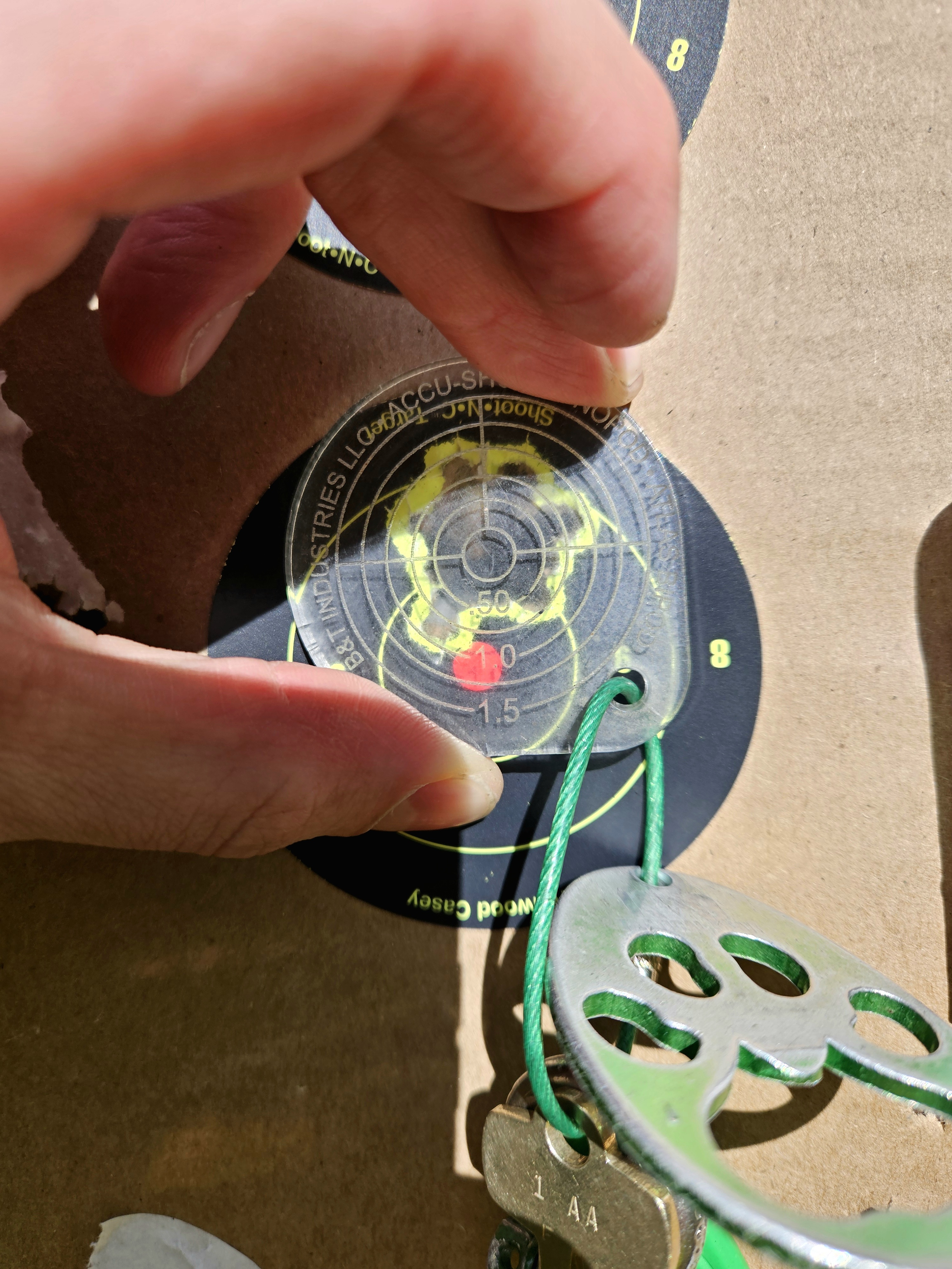

View attachment 562920View attachment 562921
