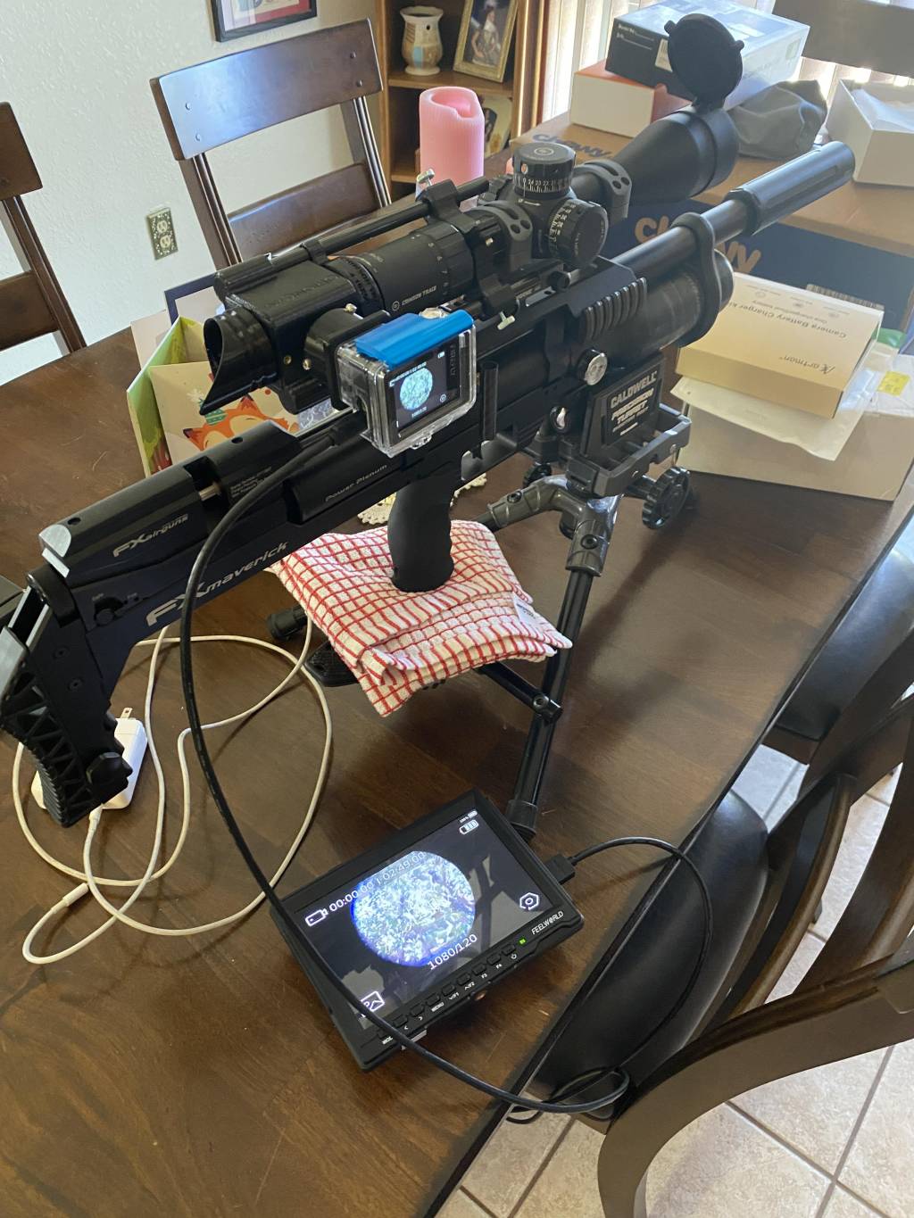

My son has some physical limitations but loves to hunt. I have been working on a plan to get him involved more than just being with me hurting. Noticed he always had a hard time seeing the critter and always asked "did you get him". I wanted to give him more of a POV look it to the process even though he can't quite shoot himself. Came up with this idea.
Take a go pro or firefly and hook it to the scope normally and then hook up a mirrored high definition monitor to it using HDMI cable. Now he can hold the monitor, see what I see through the scope, and enjoy the hunt 100 fold compared to before. I want to thank Orion for helping me with this idea! As you can see in the picture he holds the monitor and sees what I see. Just an idea for the next person that wants to get out with their little guy that can't do it on his own. #dadwin
I would personally use a lens on the camera that are more "zoomed" into the reticle, all the black around the circular picture are a waste in my view.
Using wifi to connect / preview what a camera see, these days are okay though there still are a little latency, but at least now we are talking fractions of a second where it use to be / have been well over a second, so with targets that do not move fast or much i do consider it viable.
