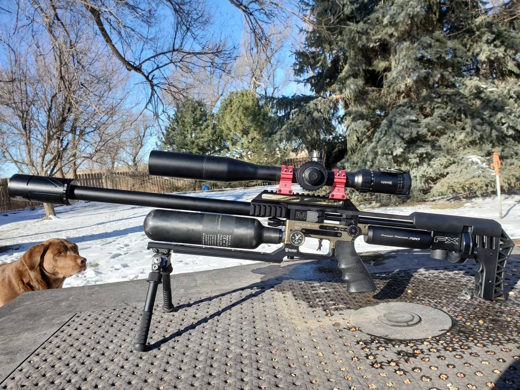

After loving my compact .25 wildcat mk3 for a year I decided I wanted more power and bought a .25 700mm Impact M3. The wildcat and I had been through a lot together and I knew it like the back of my hand. I tried some nsa 29.5gr slugs in it and got them shooting EXTREMELY good. But after using my first batch of 29.5s up my second batch of the same slugs left me unsatisfied. They were'nt shooting near as good as the first batch, so I went back to pellets, tuned down the power, and have'nt looked back at slugs in my wildcat compact. The ole wildcat pellet combo killed a lot of invasive species around the farm! Even recorded a 136 yard shot on a sparrow. (that's a good shot for me in Kansas wind)
Fast forward:

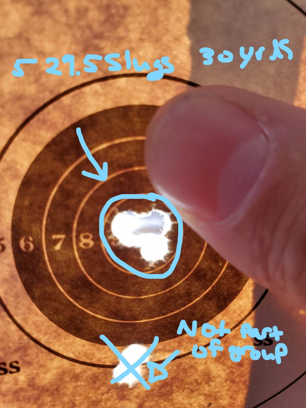

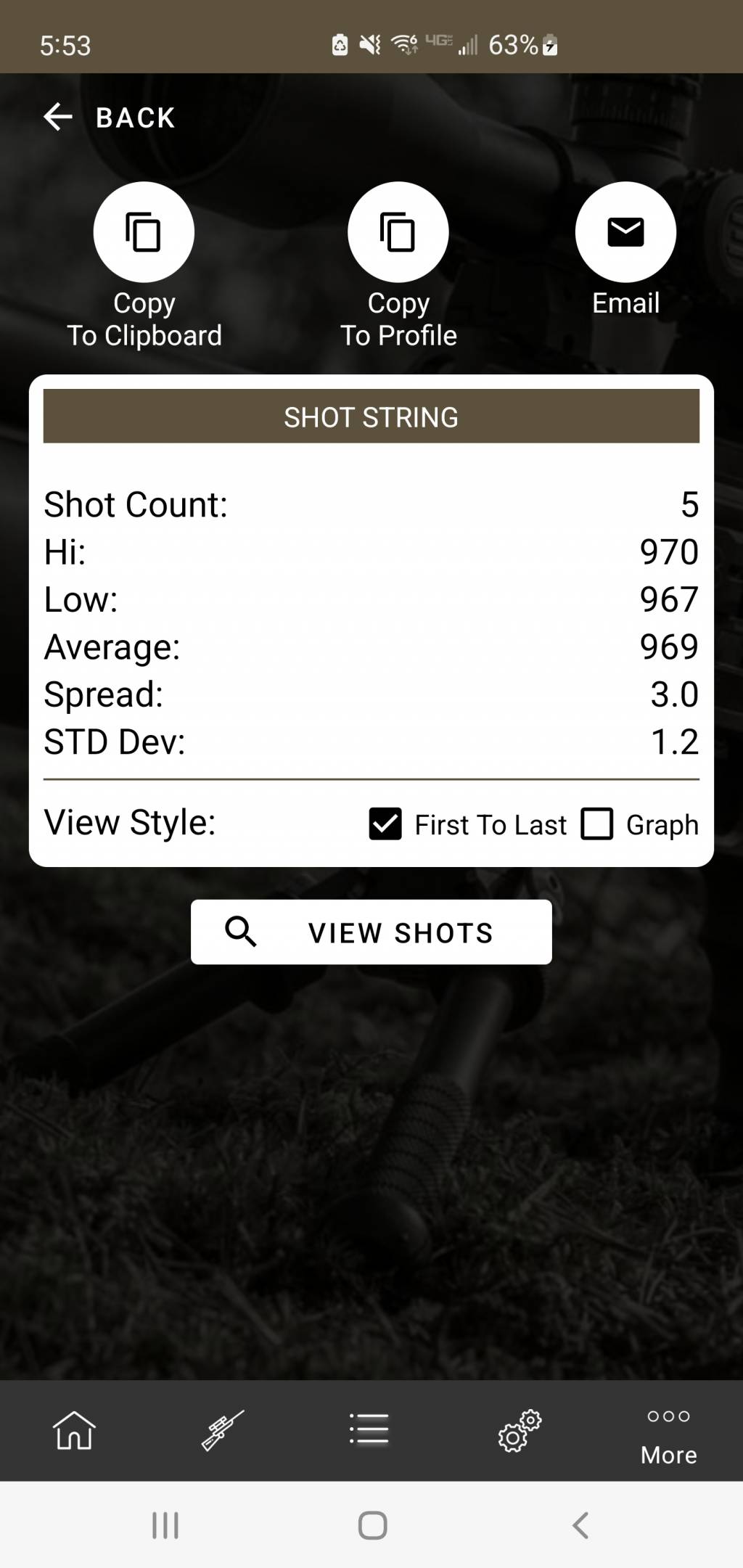

I really wanted a slug shooter for longer range hunting and cutting through wind better. So I bit the bullet and got the m3. Bought some more 29.5s because I had some success in the past with them (also I believe Ted mentioned they shot good as well out of a standard superior liner like i have) and I figured with more power and tuning capability I could get them shooting good. When I got the gun I loaded up the leftover 2nd batch 29.5s I had used in my wildcat (that wouldnt shoot) and setup at 30 yards. It really did'nt matter what speed I shot those slugs at. They were just stacking in one hole!!!! 5 and 10 shot groups that were as good as my wildcat pellet groups! With chronograph numbers like ES of 5 and SD of 1! I could'nt believe it! I thought "not sure what these guys on this forum are talking about, this slug thing is easy" LOL. Never got the chance to try them at longer distances because that was the last of the old batch. Just enough to get me tuned to a nice high fps and scope dialed in. Then it all fell apart hahahaha.
I then loaded up the new 29.5s that came with my M3 and I thought "what the hell just happened?". The groups opened quite a bit. It wasnt spraying them like ive seen some guns do and it was grouping but not good enough to hunt even to 50 yards. So I went on the "tune chase". A box of NSA 29.5s later I still dont have any better results. Now I feel the pain of some of the guys on here haha. Absolutely amazing the difference in batches of the same gr slugs. I had the magic batch for the first 50 shots.

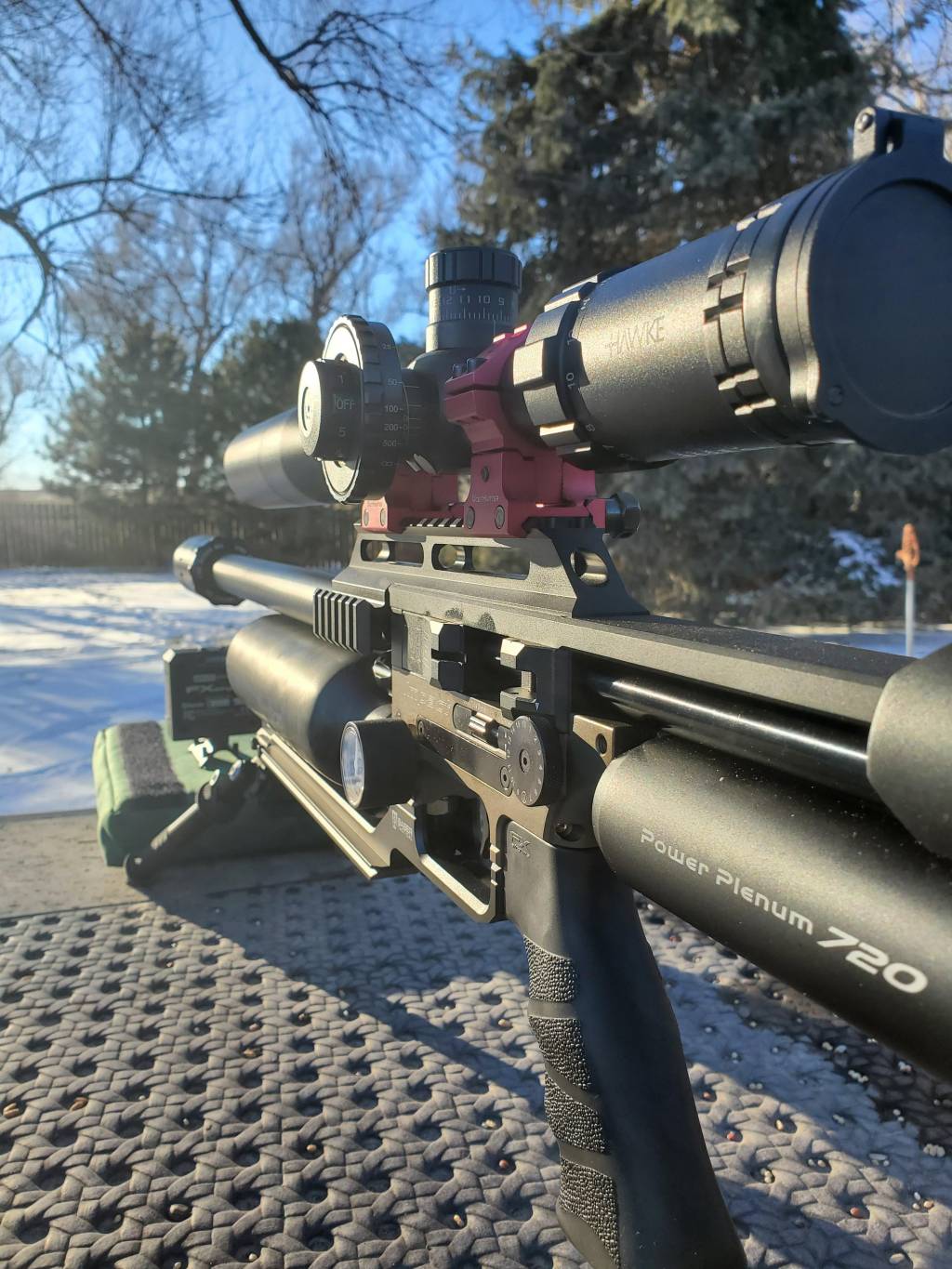

1st reg: 160bar. 2nd reg: 110bar. Micro dial hammer: 4.5. Macro Hammer: 16. Valve 4 1/2 lines out (max). 700mm Standard Superior Liner. This got me to 970fps with the first batch of 29.5s with extreme accuracy. Ive now been all over with the adjustments trying make the new batch of slugs work. From 1030-860fps. 860 works ok but I want the higher fps.
