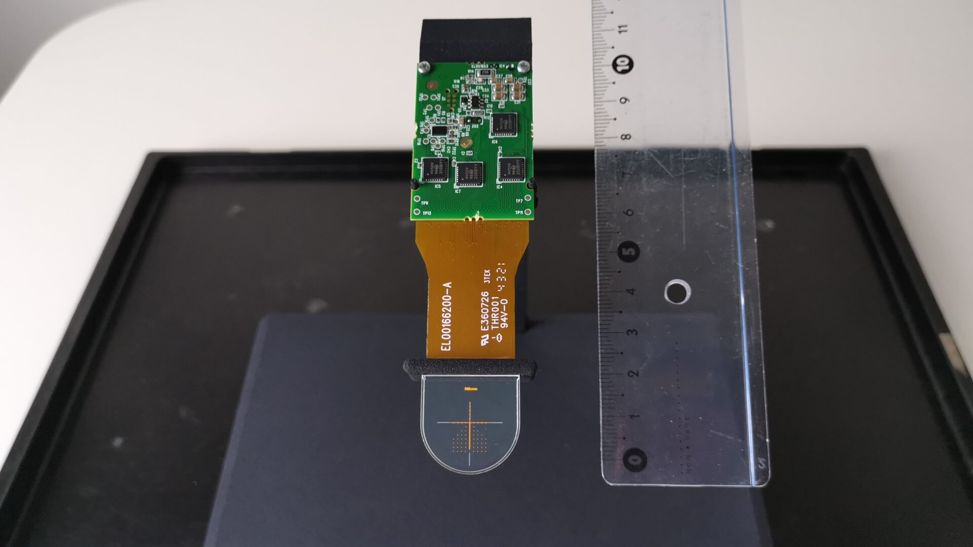

just got a reply from Konus scopes
They said their scopes " uses same standard turrets that operate in the same way as a traditional riflescope. With every click these turrets move the LCD screen onto which the reticle is projected, but mechanically there is no difference."
So clicking the turrets mechanically moves the LCD screen.
  • Sad
Reactions: JungleShooter
Please correct me if I am wrong, but with a projected reticle wouldn’t you still need a mechanical way to move the projector, which would not solve the problem?
I think you would need a stationary reflection of an LCD screen, with the reticle digitally drawn (updated) on the LCD. However, getting an LCD screen that is small enough and has a high enough resolution to look decent when magnified seems difficult to do…
