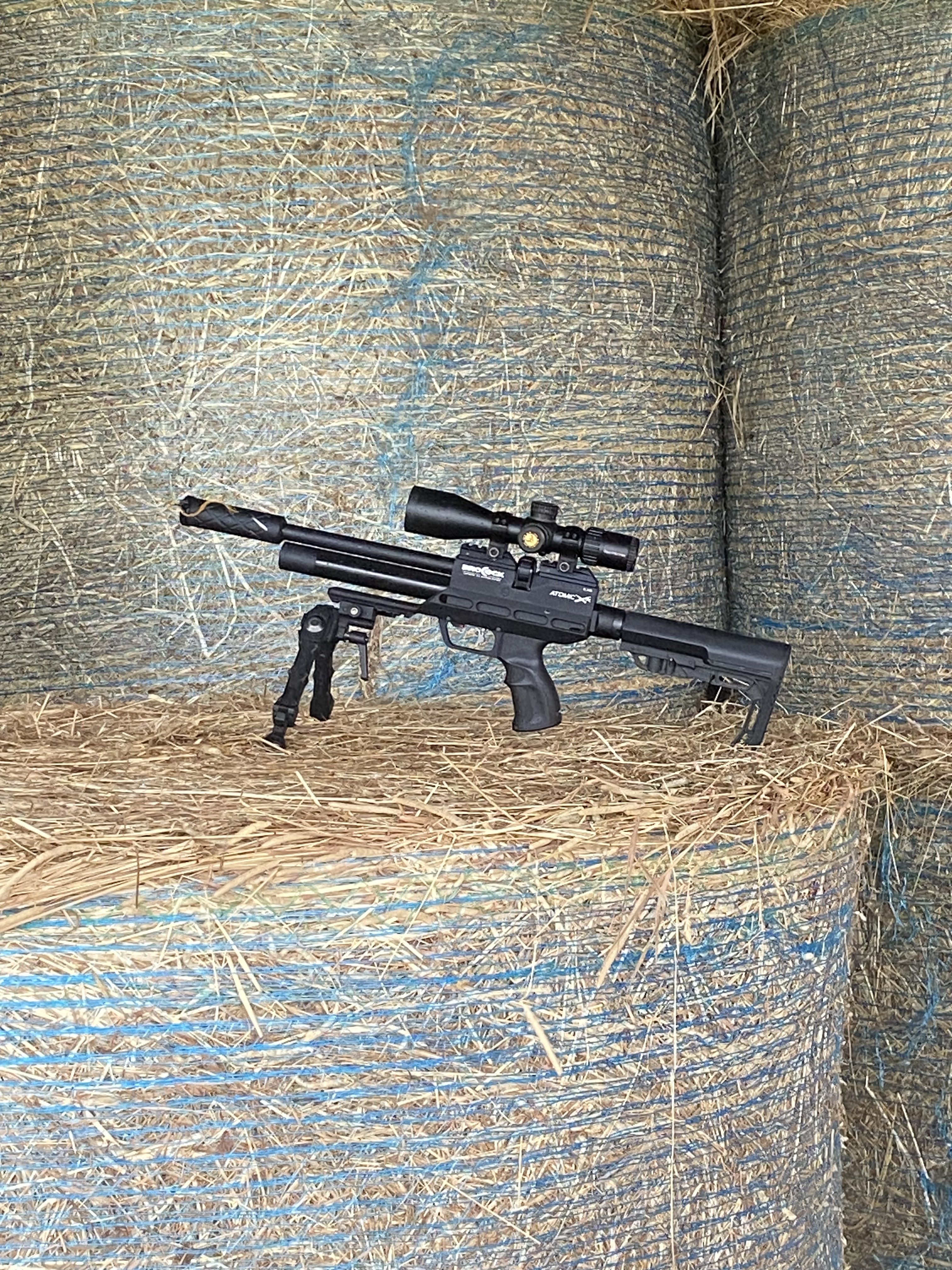

Gentle shot cycle… After reading the post by @cavedweller I decided to pull my Atomic XR out of the safe and have a shooting session after work. She simply is a gentle beastie to send with. The targeted pest don’t see her as gentle, more like murderous…🙈 At 17 fpe she quite polite, I can see in most instances, the pellets on the way to my POA/POI. In good conditions I can make repeatable hits on objects the size of a chipmunks head from 15 to 50 yards, consistently. I have found my nirvana with my sub 25 fpe PCPs.
