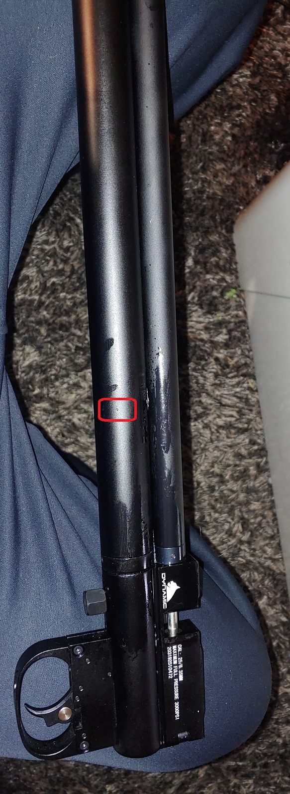

I got my dar 25 today. Decided to get on the hype train.
Mine came with a leak. There's a tiny hole in the air cylinder and it is leaking there. We'll see how this goes with the support folks.

Slow leak or fast leak? Was there air in it when it arrived?
Leaking there means it’s one of the two O-rings on the regulator body. Pretty easy to replace them but I can understand not wanting to work on a new rifle. I would because dealing with a return usually takes as much time and I can be shooting in an hour. If they didn’t change the size in the gen 2, they are size -117.
