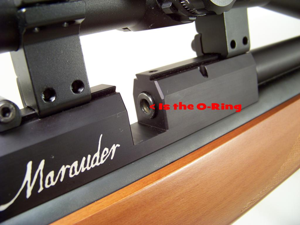

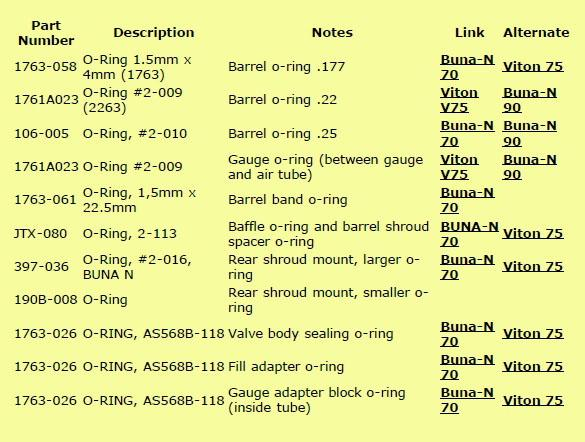

Make sure your breech oring is present, the stock ones rarely live a long life...
My guess is that is greatly effecting your FPS and spread...ask me how I know :rolleyes:

Searching for reasons my velocity is in the 600's and I can't tune it to get above 760's....my O ring is absent. Hoping the one thing will resolve my 2015 Marauder's velocity issue. Thank you
