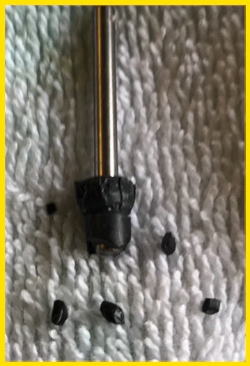

Years ago I sold my .25 mrod and the buyer inform me the gun was leaking air. I tried to rap my head around what it could because I had this gun for years. The buyer had motorhead work on the gun and what he told me the problem with the gun was the poppet was leaking. Not sure if that it's the same problem with your gun but it's something you can look at
Lol ... Poppets are wear items and have a limited life based upon cycles / impacts against seat. Gen 2 guns are much harder on poppets due to the seating surface profile in those valves which is similar to the rim of a volcano. Said raised rim seat cuts into the sealing face of poppet and will in time shatter / fracture it. Gen 1 gun in time also will fracture there poppets as well.

The poppet could be the problem but when my poppet on the .25 went, it went right now...like a lithium battery.
I replaced the poppet on the 1720T last year because of daily leaks and the Gen I .25 last week.
