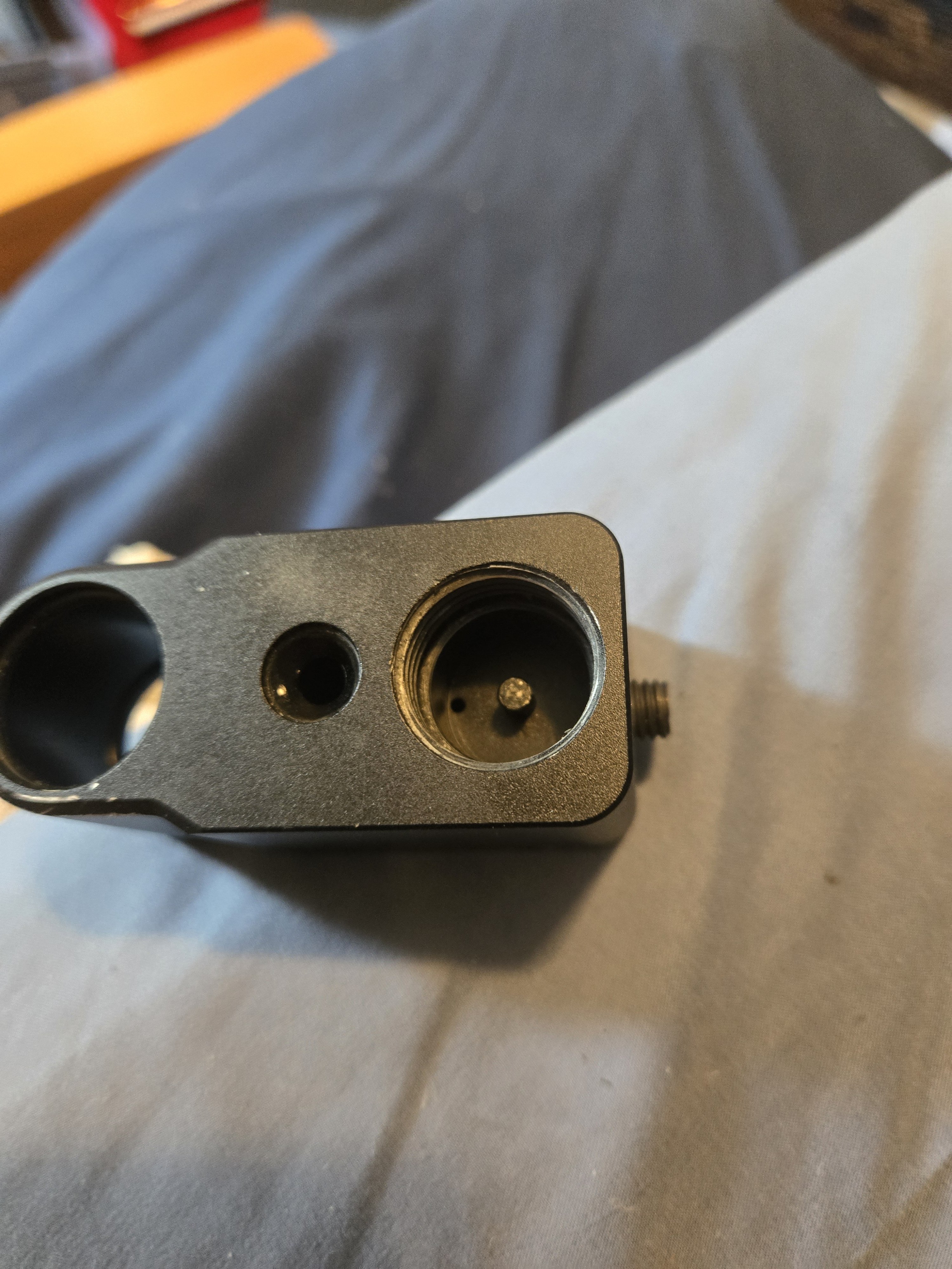

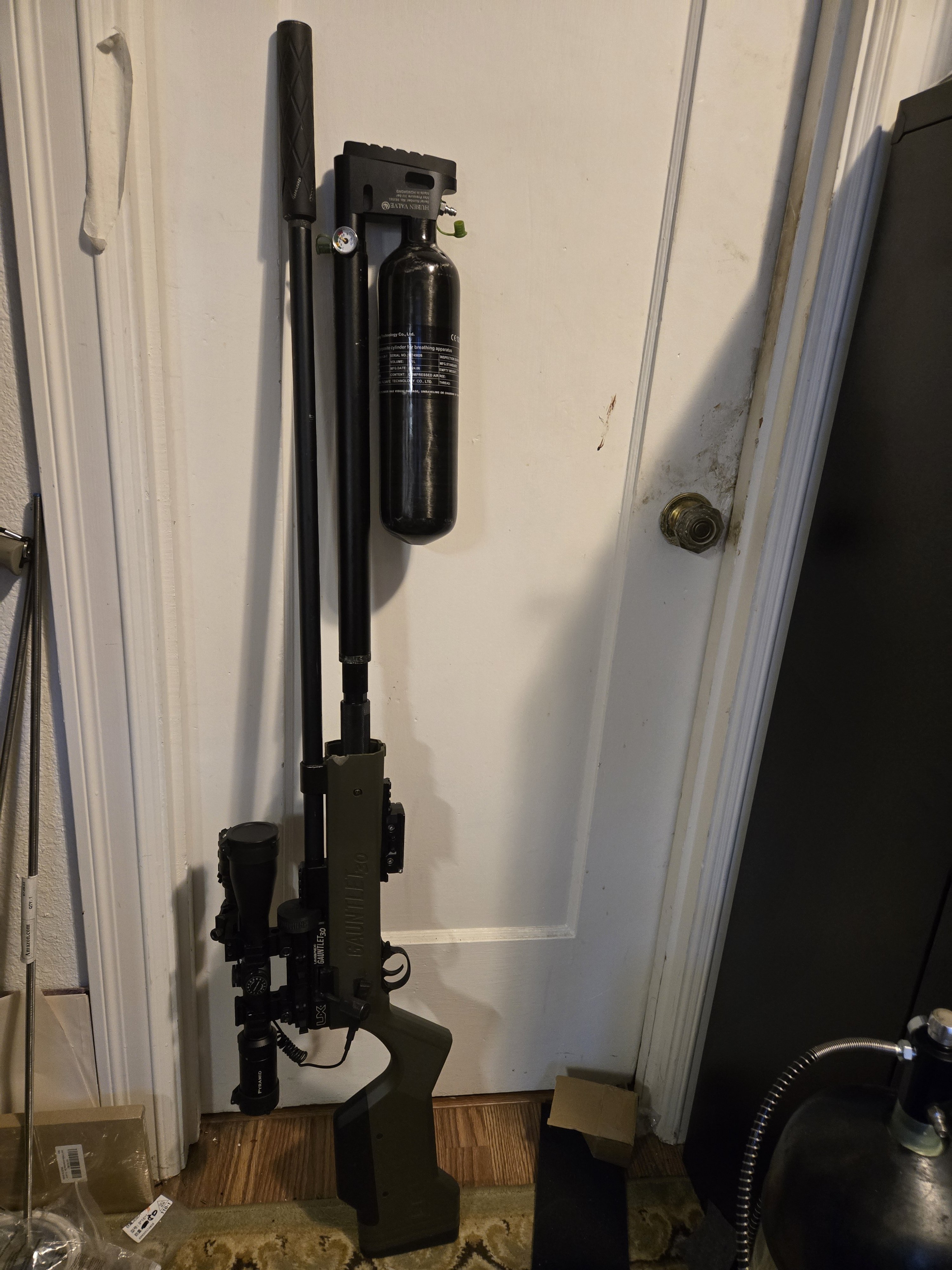

Since I'm here, I built up a 240cc plenum setup for my G30. Tested before 957 FPS at 2900PSI. Took the regulator and put it on the 40cm tube, u adapter and bottle. Tested that setup 961FPS.
The reason is the port from the regulator into the gun is only a few mm diameter. So having a plenum on the otherside of that small hole is pretty fruitless. I'll tear it down again and see if that port can be enlarged. Maybe over the 4th weekend.

It seems weird that a regulated gun of the Gauntlet power would have such a tiny port.
I doubt that Umarex ever imagined someone would do this to a Gauntlet.
As is my special skill the Gauntlet now weighs several pounds more.
800cc Alsafe bottle
Huben Power U adapter
Huben Power Cricket Regulator 1/2
Shan Bao 40CM 3000psi aluminum tube
Two 3 inch extensions to get the U adapter over the end of the barrel. Otherwise have to remove the barrel to mount the U adapter.
800cc Alsafe bottle

But it does not work. No difference before and after. Going to have to tear it down and see if i can enlarge the port. May have to have a new port fabricated. High pressure so the port size might be small for a reason.
Put essentially the same setup on my Evanix .30 Sniper X2 and was able to reduce regulator pressure 500PSI for the same 850FPS.
