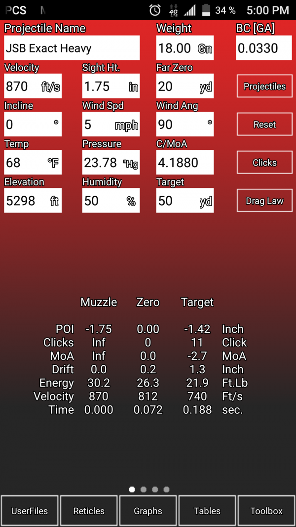

Hey guys it's probably just my guess, I just bought a guantlet in .22 sightted at 20 yards and at 50 yards it just have a drop of 1 3/8". I don't have a chrony, but the according to the chairgun app it's shooting the jsb 18 gr. At 870fps that's 30.2 fpe. Is it possible?

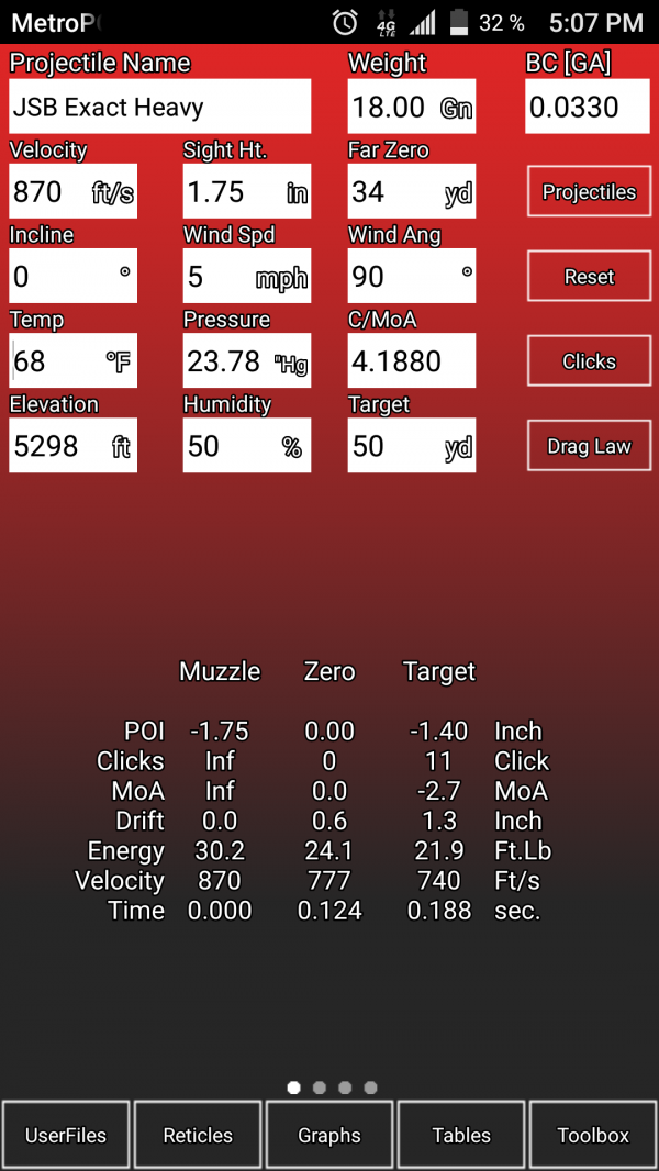

This is what chairgun show me.
At 20 yards is zero, (haven't checked my far zero) and my point of impact at 50 is around 1 3/8"
That's how I came out with those numbers
