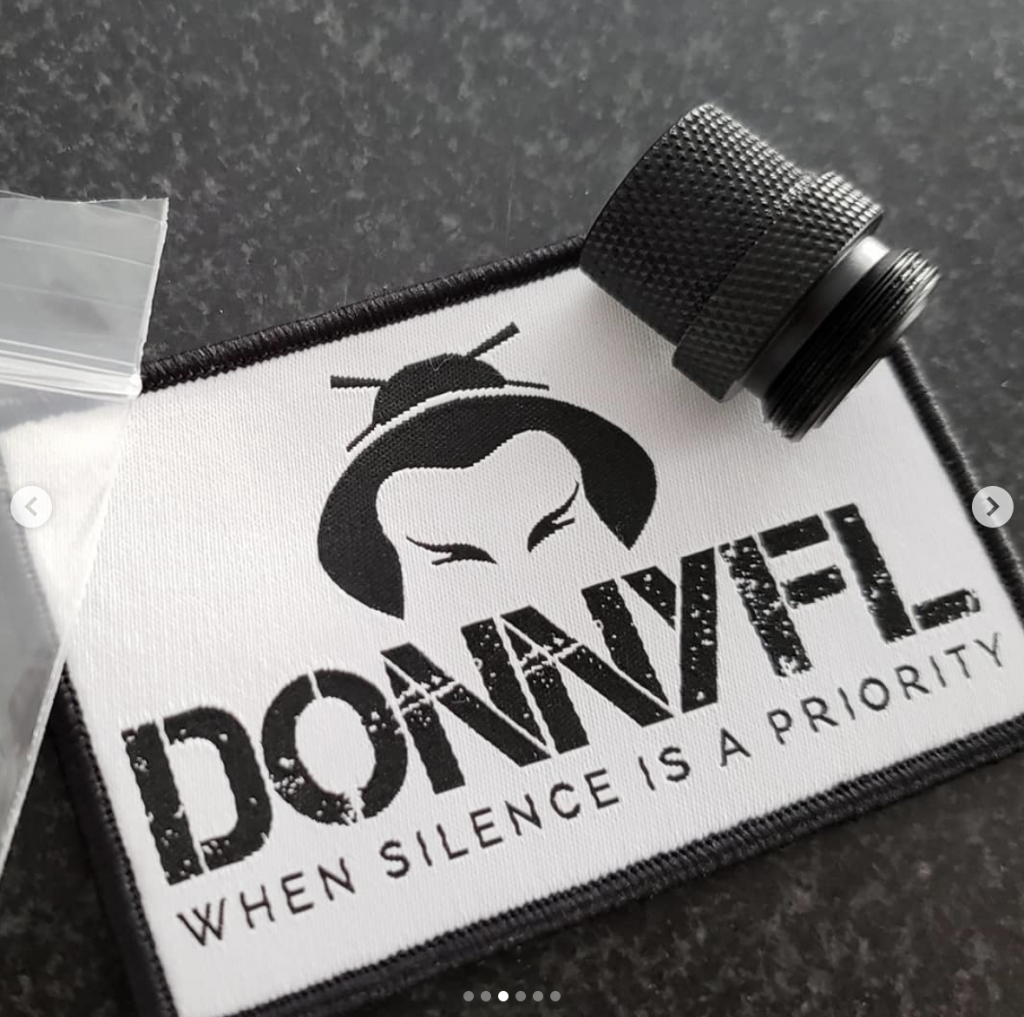

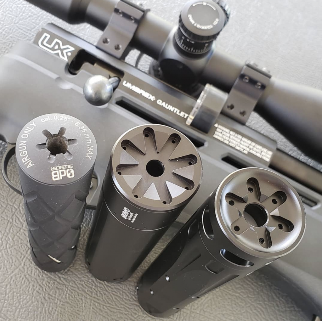

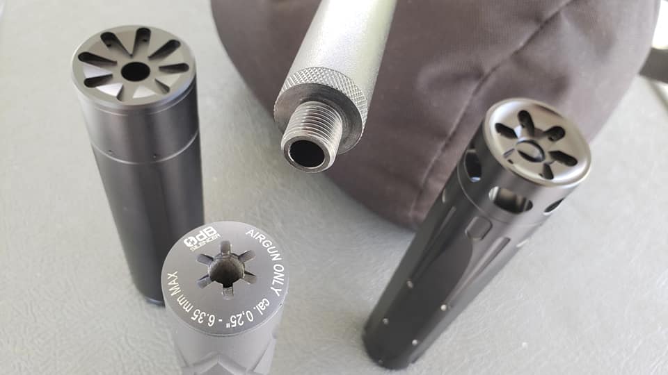

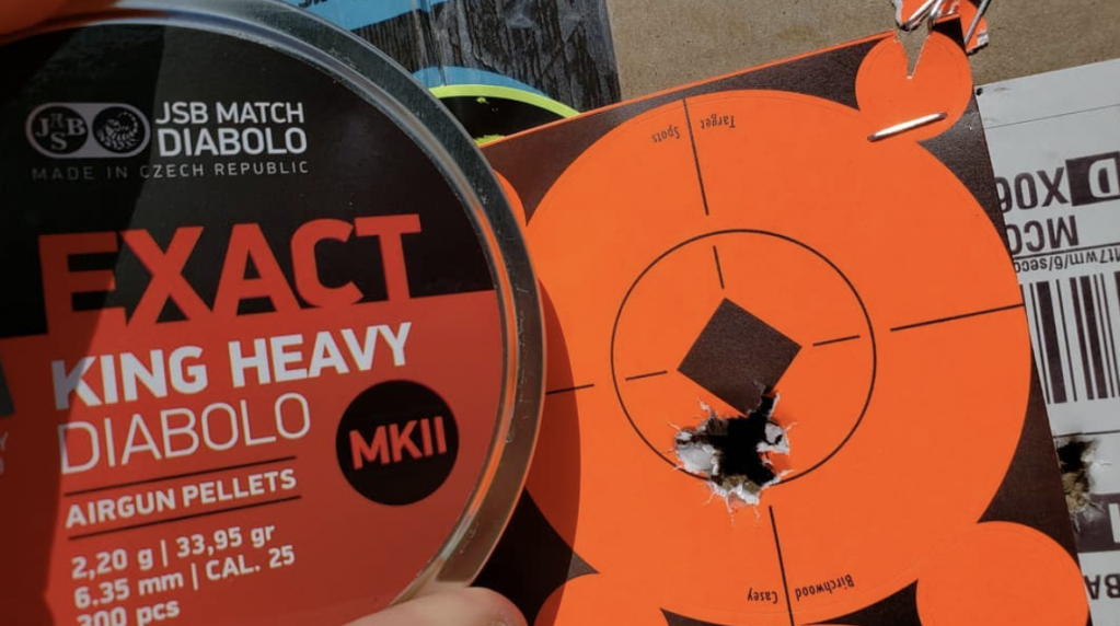

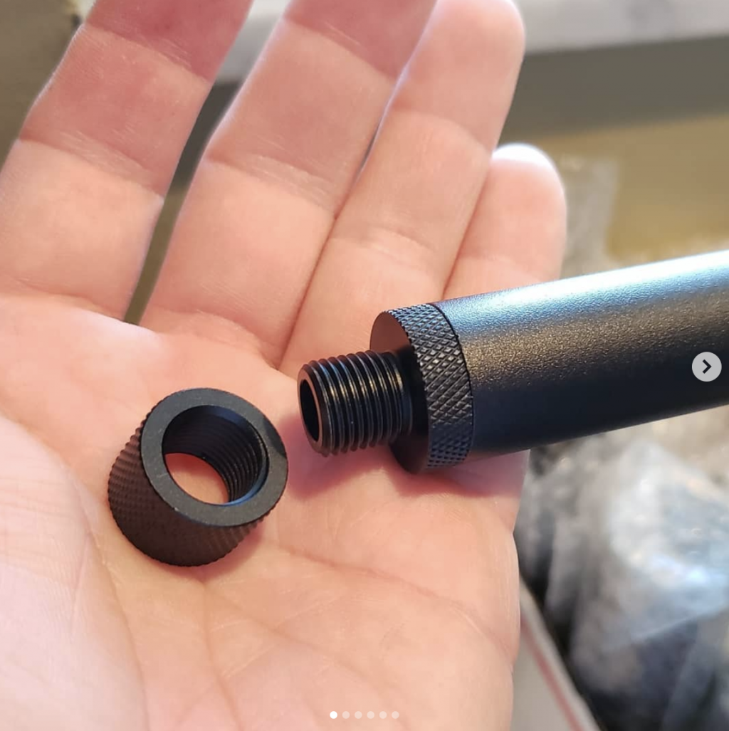

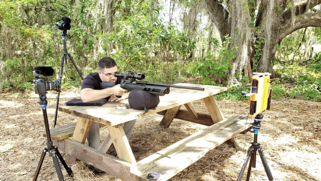

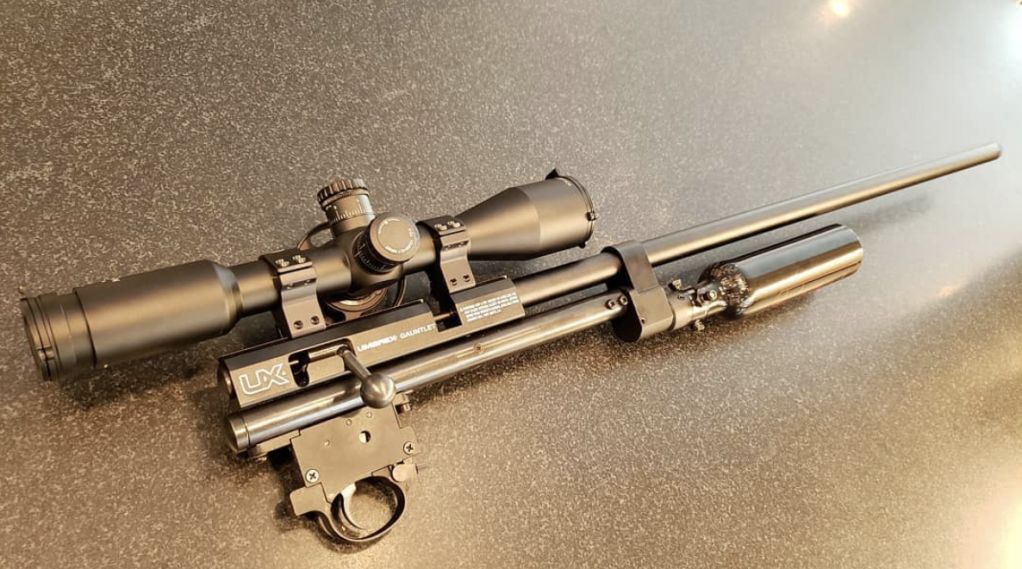

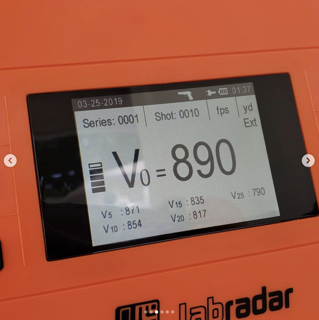

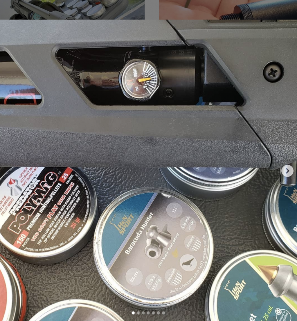

Steve's been hard at work learning the .25 Umarex Gauntlet, culling pellets, and testing aftermarket sound moderation for ya'll. I pulled these pics off of his FB & IG pages. Check them out for more juicy details:

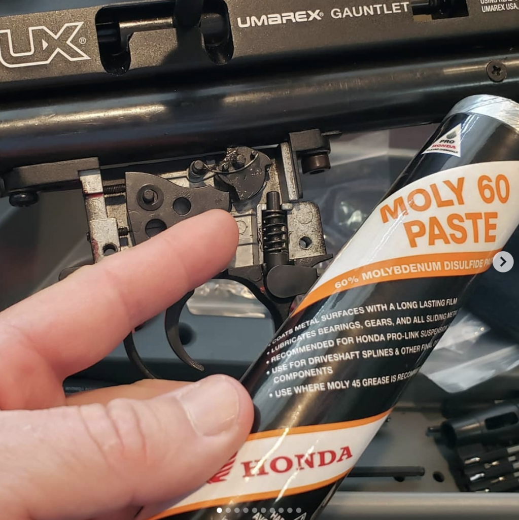

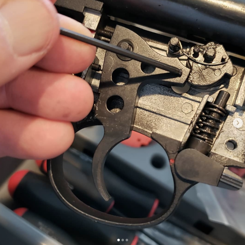

Watching with interest. Most interested in the trigger and overall long range qualities.
Those to things are directly linked. There's no sugar coating it, the trigger is still a challenge but its pull seems quite a bit lighter in weight than the .22 I reviewed last year. Right now it's about a 7-stager, lol. They're easy to fix however. Ya think I should before I get to the 50 & 100 groups? I'm thinking so but I'm not sure.

I have one. I added a 380 cc bottle and upped the reg to 2000 psi. Not sure what Umarex did with that barrel but DAMN. It's mad accurate from 25 to 100 yards with the polymags, the 25 jsb and the Nielsen specialty slugs. Pushing right about 930 fps with the jsb and polymags. A quick shootout to Hajimoto and his fine work. I adjusted the crunchy trigger to even it out some, polished the ports, ported the shroud fixed the barrel o-ring and it's so much better.
