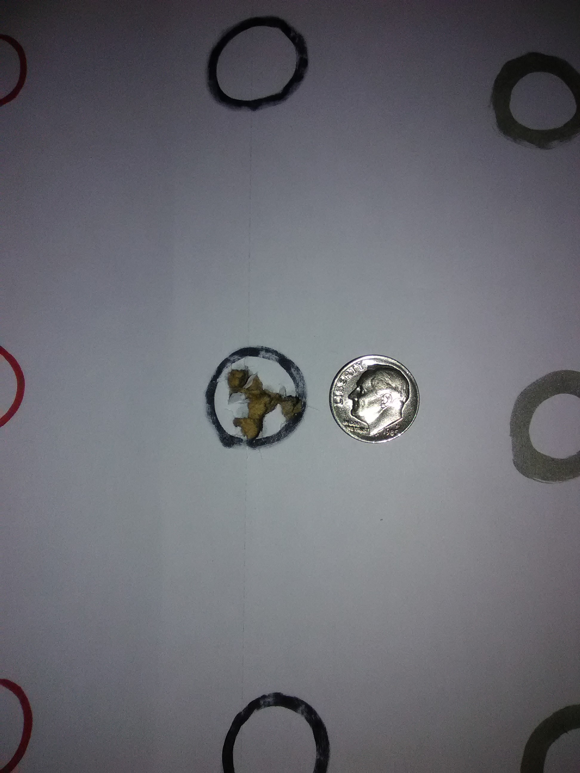

After settling the yearlong Airacuda Max .25 saga, finally got around to addressing Gauntlet concerns. Always highly accurate with JSB 33.95s @ 740 FPS, I decided to upgrade to larger bottle and 2200psi regulator, up from OEM 1900psi one. Best laid plans of mice and men, accuracy was no more. Installed Terminador's HS adjusting adapter ($30, eBay) and drilled access hole in stock. Also, drilled vent hole in shroud per Hajimoto YT video. Decided to tune Gauntlet for JSB 25.39s since original plan to use surplus in Airacuda Max changed when her preference for accurate shooting of JSB 33.95s (MKII) @ 766 FPS, SD of 1.1, was revealed. Gauntlet shot this group today @ 50 yards, 860 FPS, SD 6.7, 41.7 FPE. Question is, with Airacuda and Gauntlet back in line, what am I gonna fuss with now?;)
