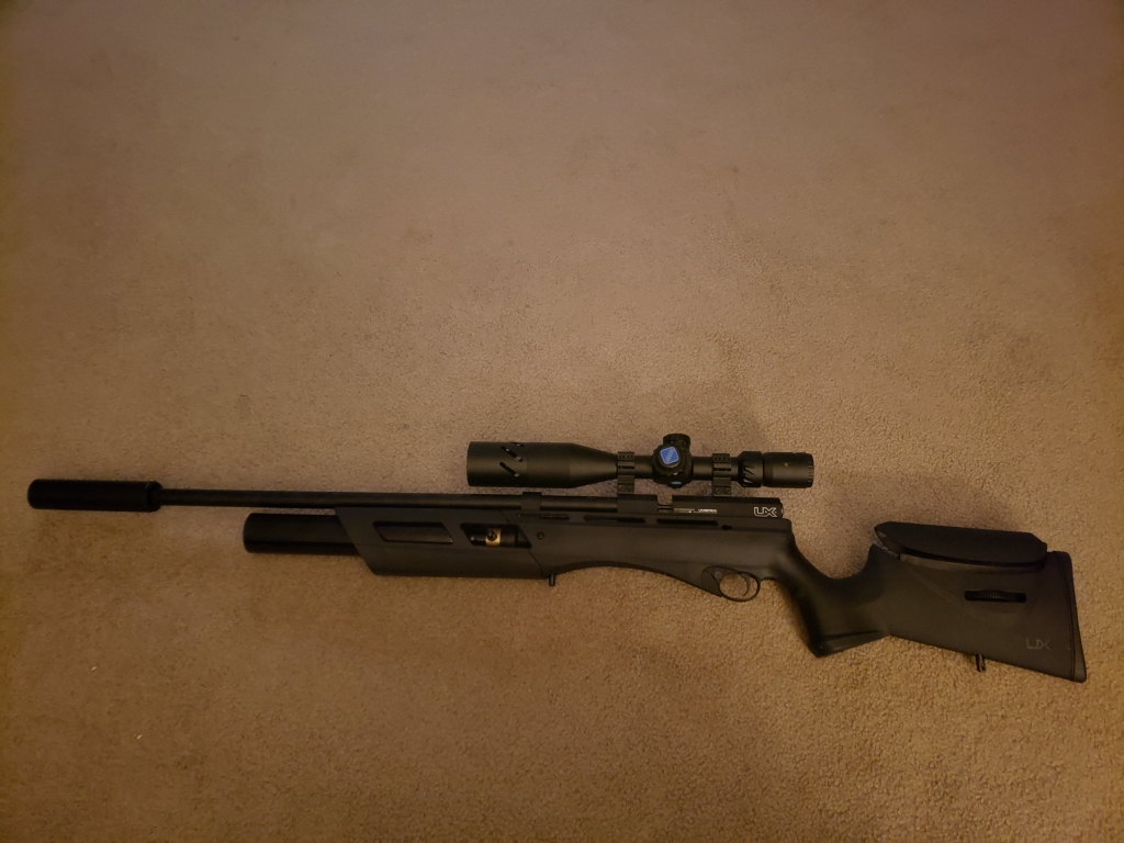

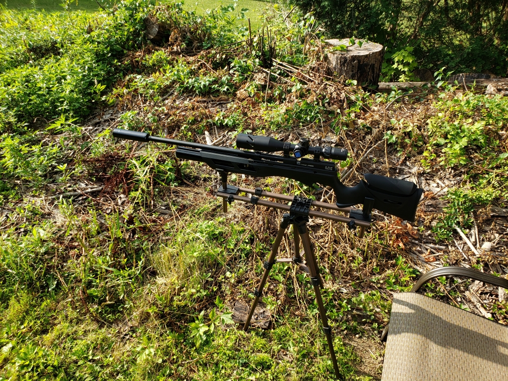

So i have had my gauntlet for a bit now I have always shot with the donnyfl sumo and sighted in with it on it has the barrel band but I feel like every time I have it zeroed my left to right is off the next time I shoot usually around 4 clicks, this has happened to me 3 or 4 times already. Here is a picture had it dialed in took out 2 squirrels and a chipmunk and thought hmmm seems like it was off from where I aimed the picture of the chipmunk is flipped I shot him facing the other way. I wasn't able to check until yesterday and went shooting and it was off 4 clicks any ideas.
