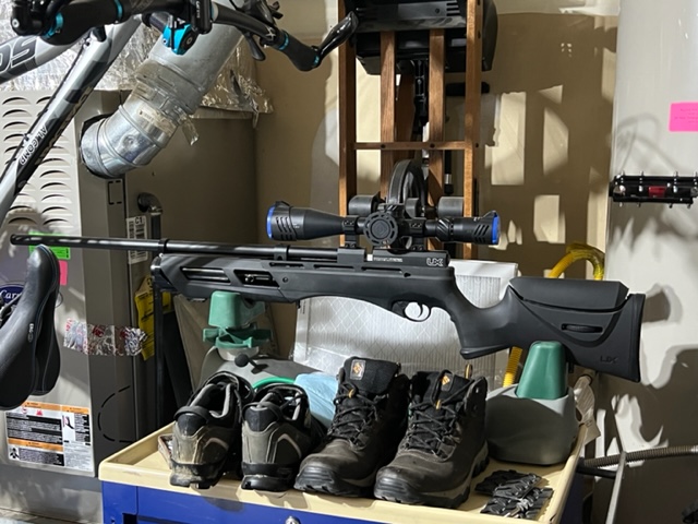

I purchased a .22cal Gauntlet 1 from a gentleman on the forum in early 2020 with intent to use it immediately. Well, Covid happened and my profession as an RN took all my free time. Since I had no time, I tried to sell/trade it but I think PCP rifles intimidate people. 2 years later and I'm looking to get started...again. Time is still limited as I'm completing my MSN but, before I decide just to sell it, I'd like to at least see how it shoots.
I live in Albuquerque and the gun has been stored in my temp controlled garage since I received it. It has never been charged so my question is do I need to check anything before doing so considering the lack of humidity?
Thanks for your insight...

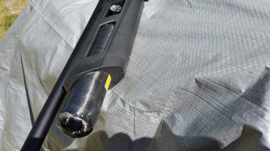

The Gauntlet is a pretty robust gun and 2020 isn't that long ago, just try airing it up and see what happens. You'll know soon if you've a problem. I've the same style gun in .25 and I notice you have a barrel band (looks OEM) that only came on the .25. I know a Hajimoto upgrade could include this barrel band, however I thought he used his own style band. Best of Luck, WM

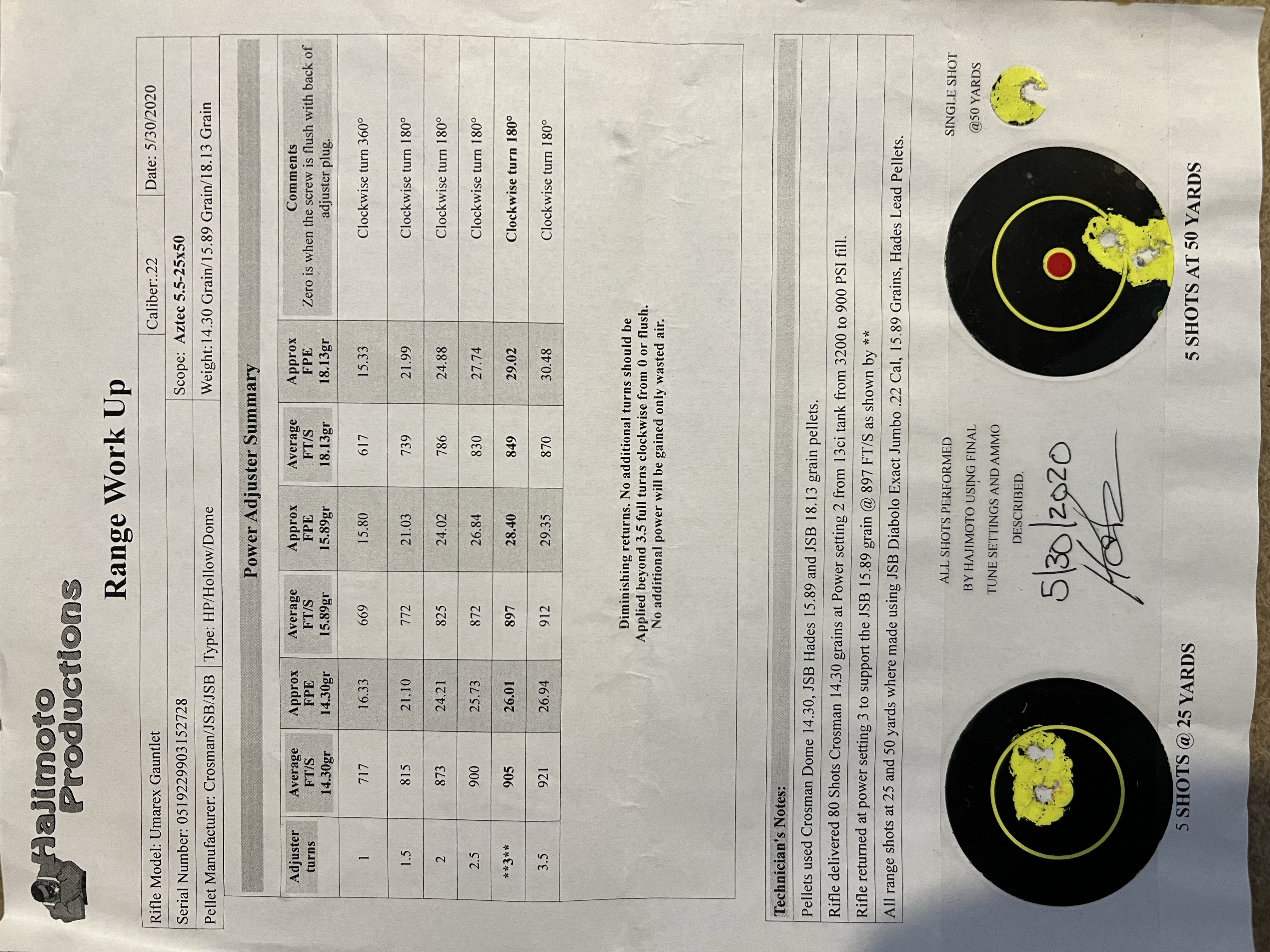

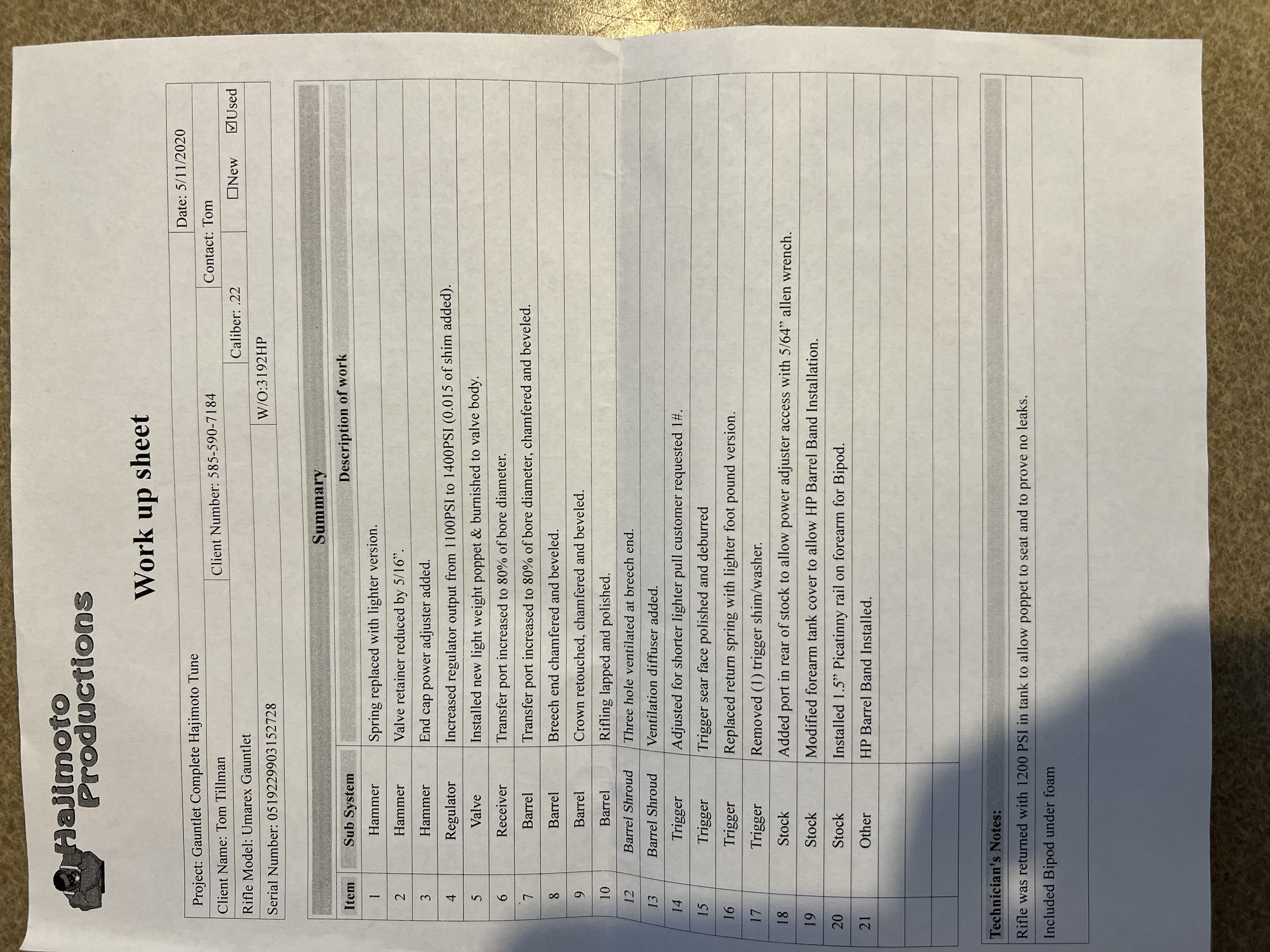

Documentation from the original owner

Agreed, hand pumping a Gauntlet isn't that hard, it's how I started. Read the original owner paperwork you posted; think you've got a pretty good setup. Got me wondering, though, how much more value does a Hajimoto-worked Gauntlet have over a stock one? Anyone in the know would prefer his upgrades, just how much they'd pay for the privilege, is curious to me. Best of Luck, WM

The discovery scope pictured was included in the price. I paid $800 shipped. The optics are very nice and modifications are in line with the purpose I have for the rifle. I'm not sure how it stacks up against a 2nd gen Hajimoto, right now I just want to resole the leak and zero the scope.
