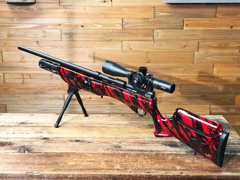

I was on the same course but saved my energy back in July of 2019 when I talked with my friends at Umarex the Gauntlets being brought to the Pyramyd Air Cup and again at the EBR were going to be EXACTLY what my mind's eye envisioned. Yep, That's a 4500 PSI CF tank inside the Gaunties furniture.
As you can see, Its already a done deal, the vessel is the tank from the Hammer so once that goes full release I'm sure we can make something happen.

What's the capacity of that CF bottle? Looks to be close in length to the 23ci aluminum tanks that are currently available. This definitely looks promising!
Price would be a limiting factor, somehow paying more for the bottle than the price of the gun seems counter intuitive! I've already invested in the power tune kit and baffles, at some point, you hit that point of no return and have to really consider the options...
Thanks Daniel! I see you had that info in your original post, my question was directed to Hajimoto concerning the CF tank he showed in the picture he posted. I guess I should have been more specific as to who I was asking. In any event, it appears the CF bottle Haji is referring to fits inside the stock Gauntlet Forearm with no modification to the forearm needed. I was just curious of the capacity of that bottle since it appears to protrude beyond the forearm about the same as the larger 23ci aluminum tank most folks are going with. Sorry for the confusion.

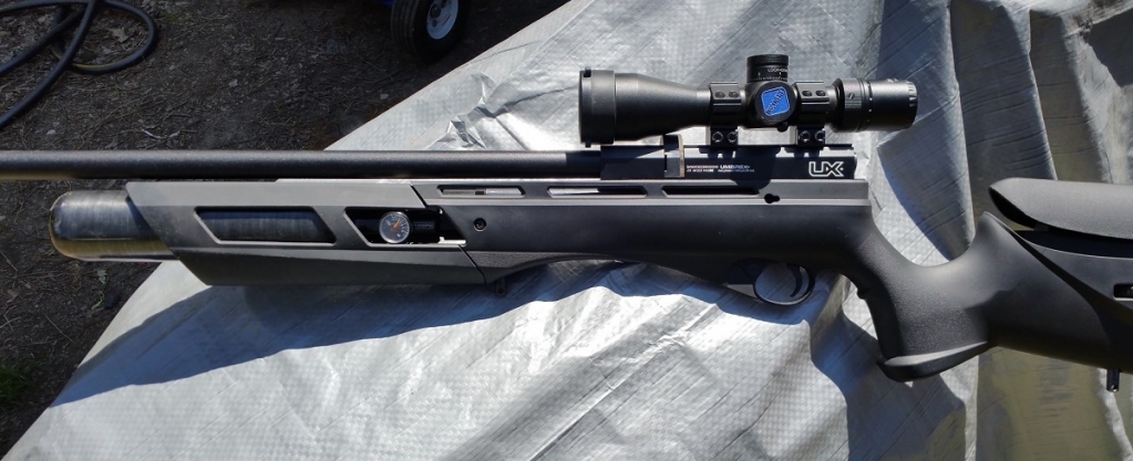

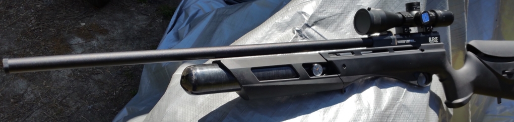

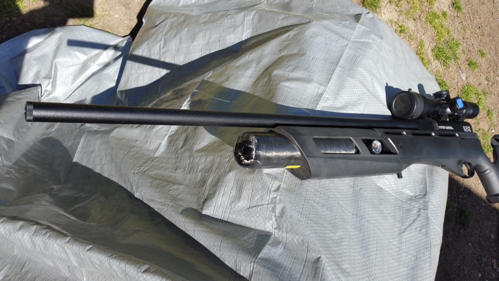

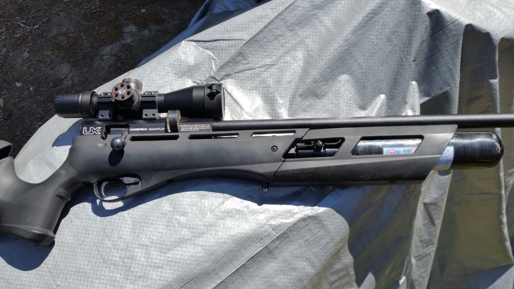

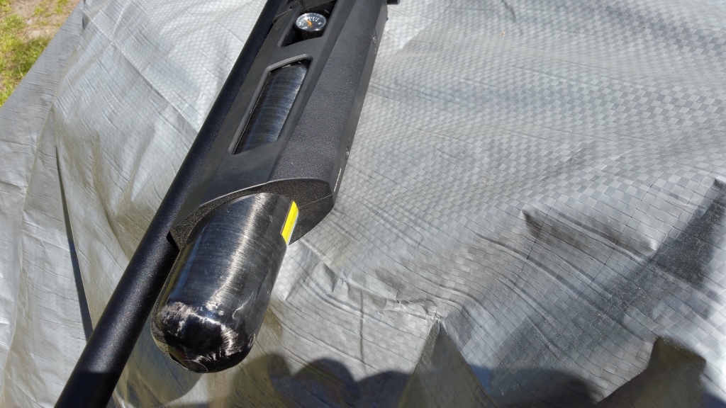

I built a gauntlet for my adult son with a 300cc 4500 psi CF bottle. That's the largest diameter bottle that can be fit inside the front stock and that removes plastic all the way down to the metal inserts that the screws go into. One of the screws had to be ground down also. I opened up the front stock with a drum sanding attachment on a drill.
