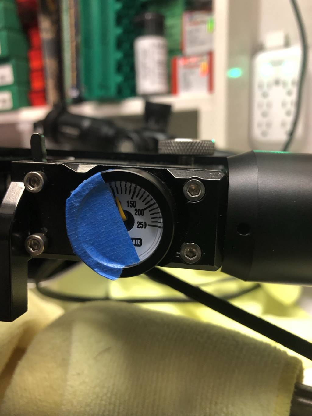

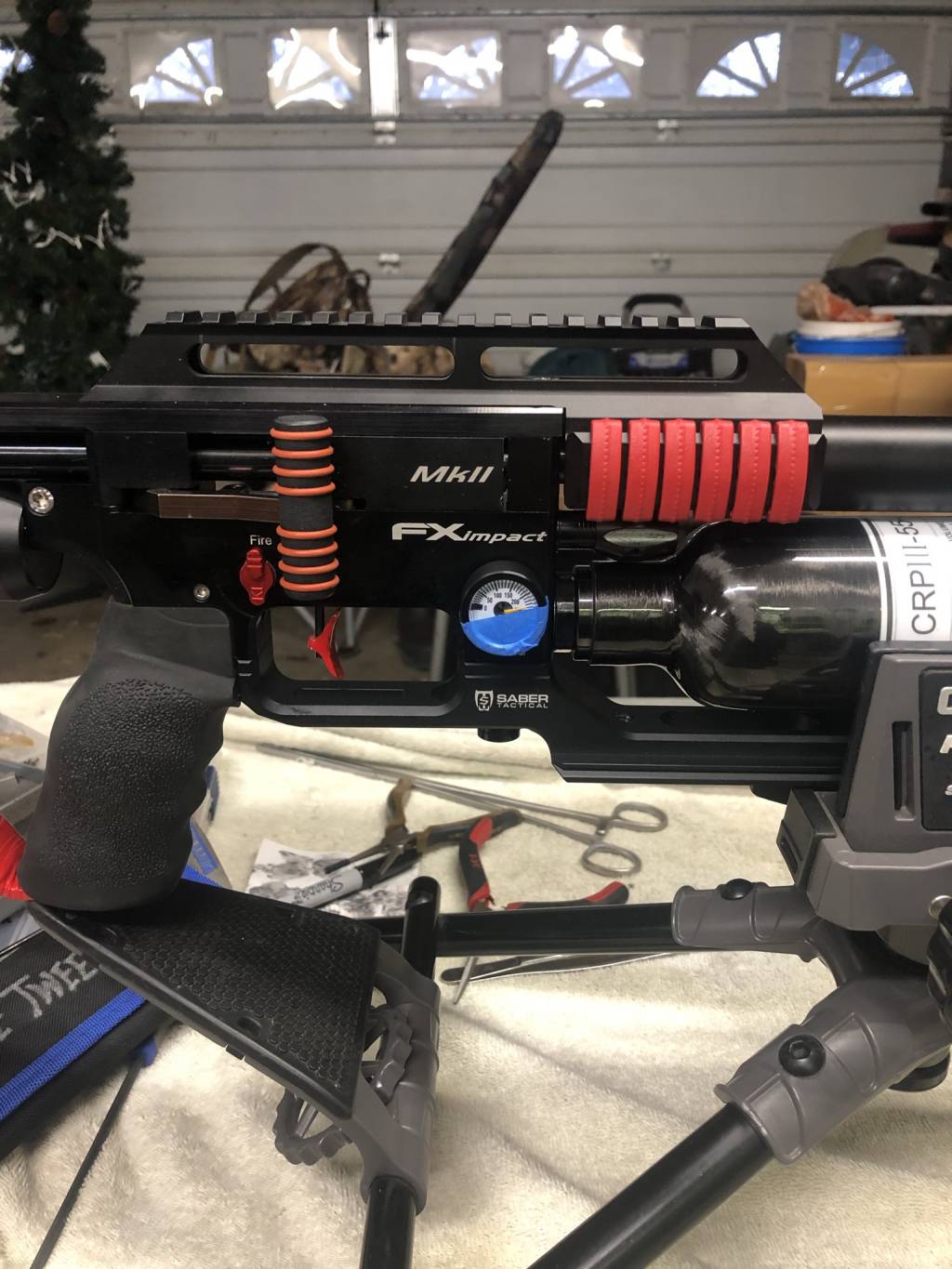

Anyone, i bought a Sekhmet digital gauge for my new M3. Box came with a metal o-ring with an inner rubber o-ring in it. No instructions were included in the box as to wether i use it or leave it off. I am installing the gauge on an FX angled bracket. Any help would be appreciated.
That sounds like a dowty washer. If there is a plastic disc in the bottom of the hole where the gauge installs then no don't use the dowty washer and do not over tighten the gauge. Just snug is all it takes to seal. If there is no other seal then use the dowty washer.
Always use same sealing method as is used in the specific location you are replacing the gauge on. On the M3 Impact there are two different methods:
1st reg - special brass washer and oring
Bottle Pressure, 2nd reg, and angled manometer bracket - xring
The dowdy seal included with sekhmet gauge is for another application.
Use new orings each time to reduce your chances of leaks. Here's the xring seal (you can find smaller quantities elsewhere if desired): https://www.mcmaster.com/90025K438/
