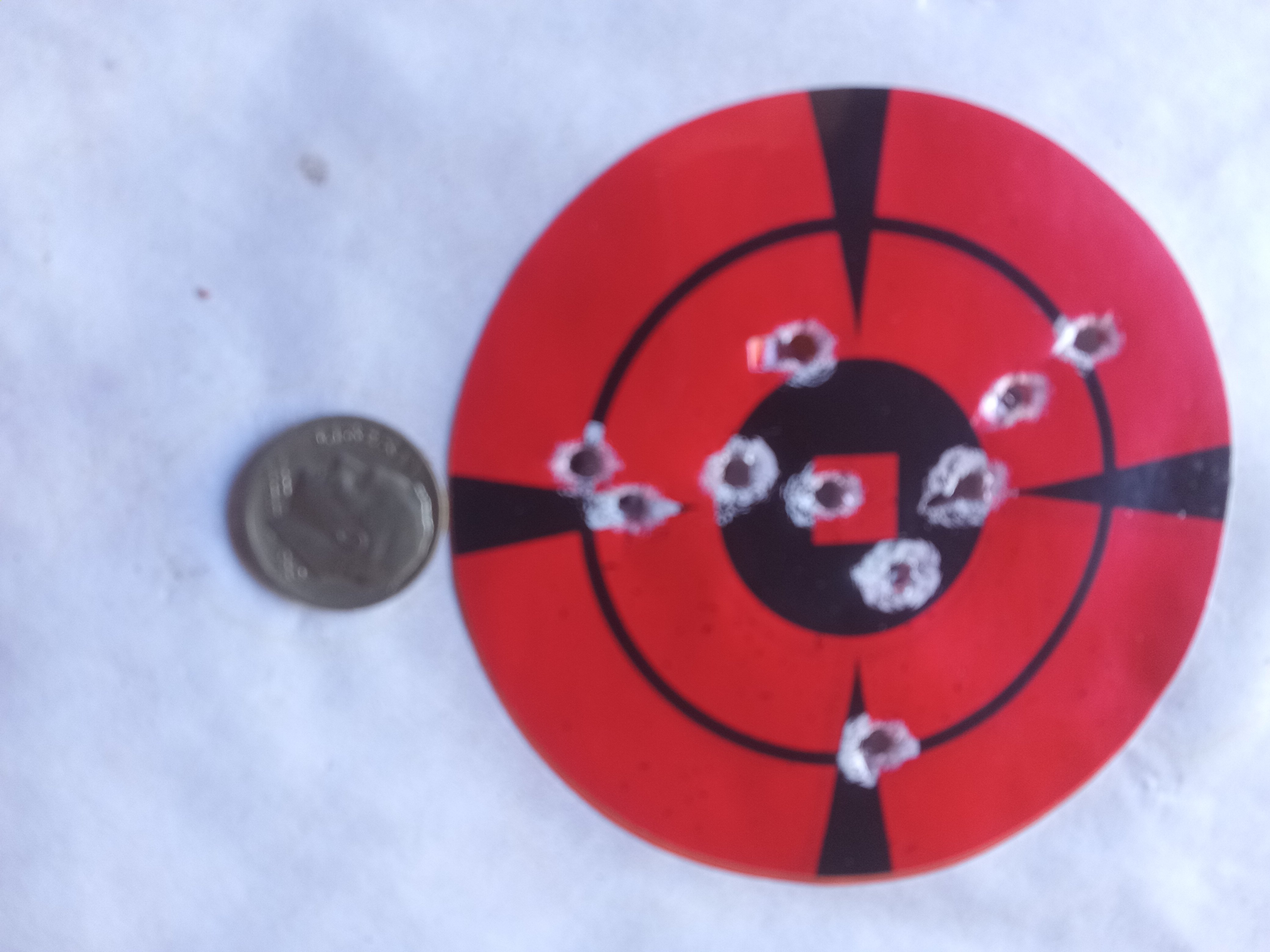

i shot some NSA 12gr .178 slugs @ 700fps from a Hatsan striker edge at 35 yards, they did better than many type pellets i had at 35yrds.
