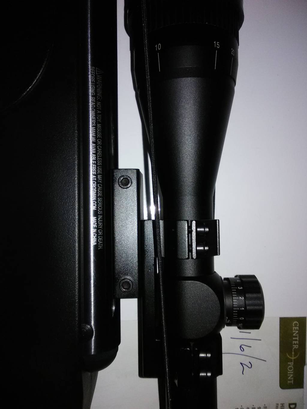

My Benjamin (Crosman) Trail NP XL .22 came with a CenterPoint 3-9x40 scope mounted on a Picatinny rail. The recoil on that gun is heavy, but, so far, so good with the CenterPoint. (CenterPoint is a Crosman brand.) I changed scope rings today since I needed more eye relief. Here's a pic.//www.w3.org/2000/svg%22%20viewBox=%220%200%20210%20140%22%3E%3C/svg%3E![]()
