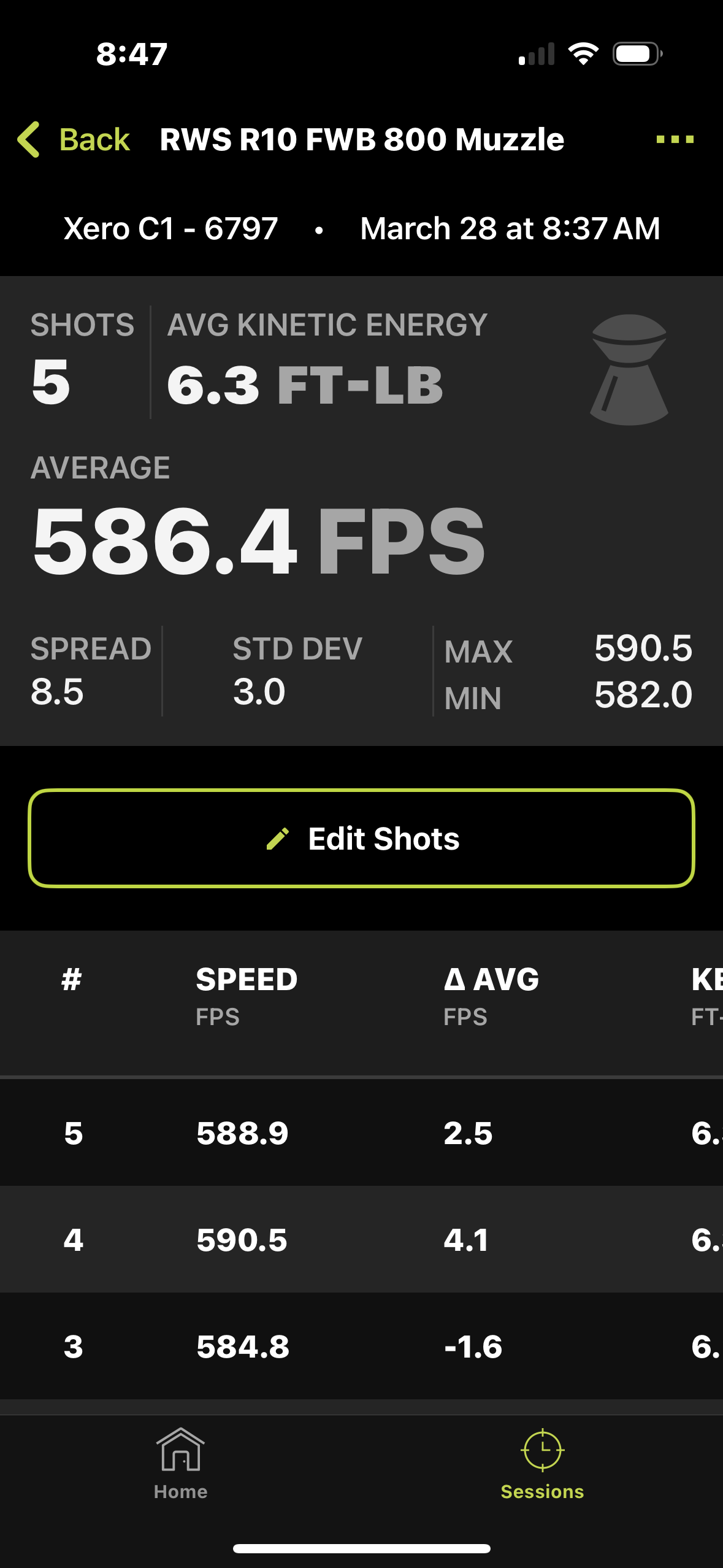

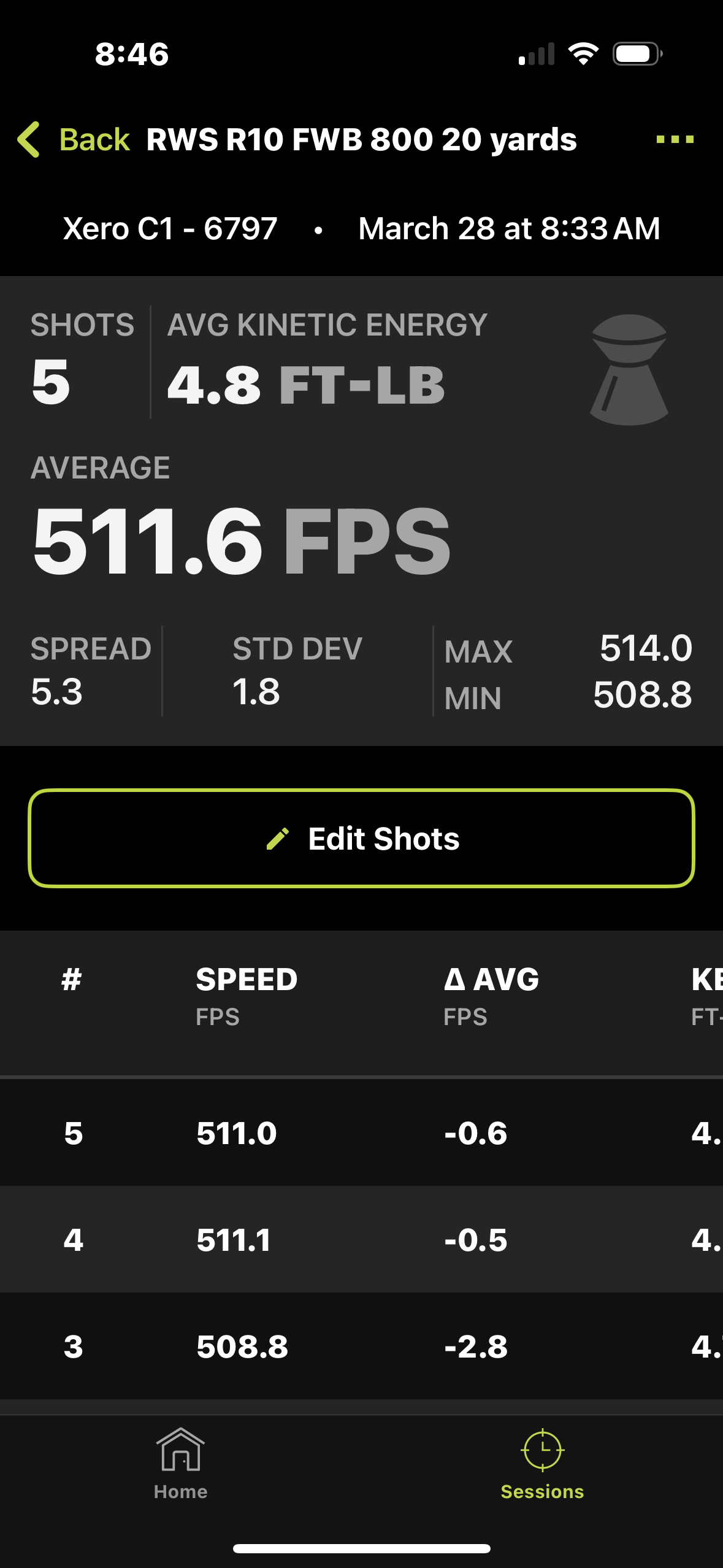

I wasn’t able to find the 3.32 update but I tried the down range feature. This is shooting my FWB 800 at 25 yards. First with the Xero at 20 yards and then at the muzzle. It’s a great excuse to own multiple units.
