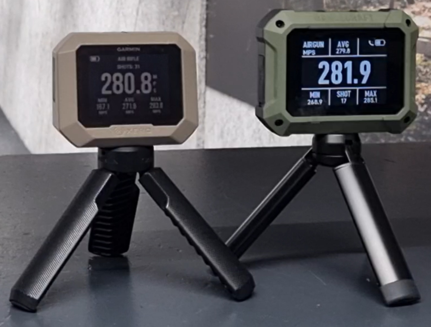

I picked up the Garmin Xero and the Athlon Rangecraft to test this week. I took it to the range and here are my thoughts.
I shot a string of 69 and both picked them up with no misses.
The difference between the two units were much closer than the YouTube video comparions I've seen. The two units were only about 4 fps off from each other.
From the unit itself, the Garmin was slightly easier to use. I think having all the buttons at the top made it a little more intuitive for me rather than the up down controls on the side of the Athlon.
When comparing the data, both have roughly the same information.
I think the Athlon screen is brighter and the text is easier to read vs. the Garmin.
In this area, they are very similar.

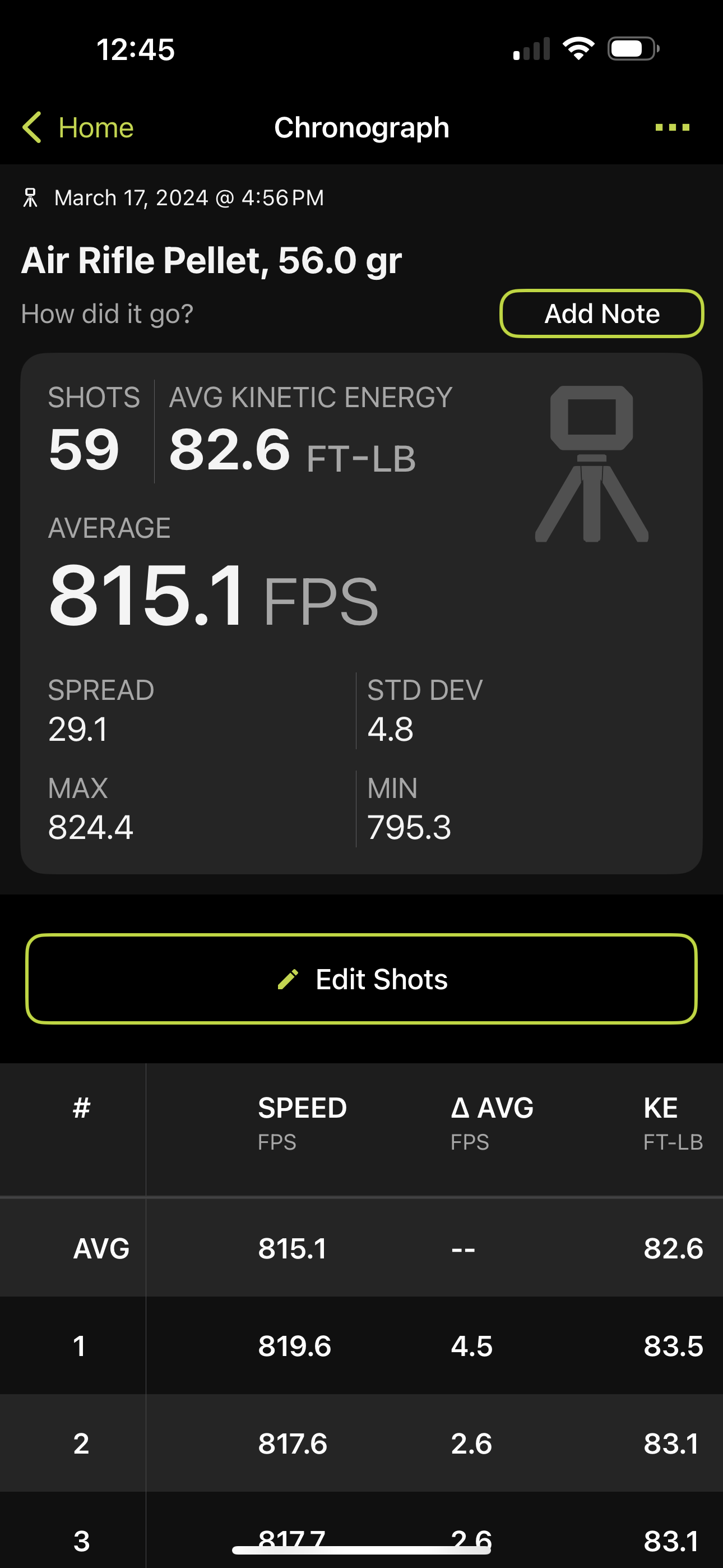

When I connected the APP's, they have much bigger differences.
The Garmin is very focused. It pulls in your shot strings, displays it very clearly and large and that's about all it does.

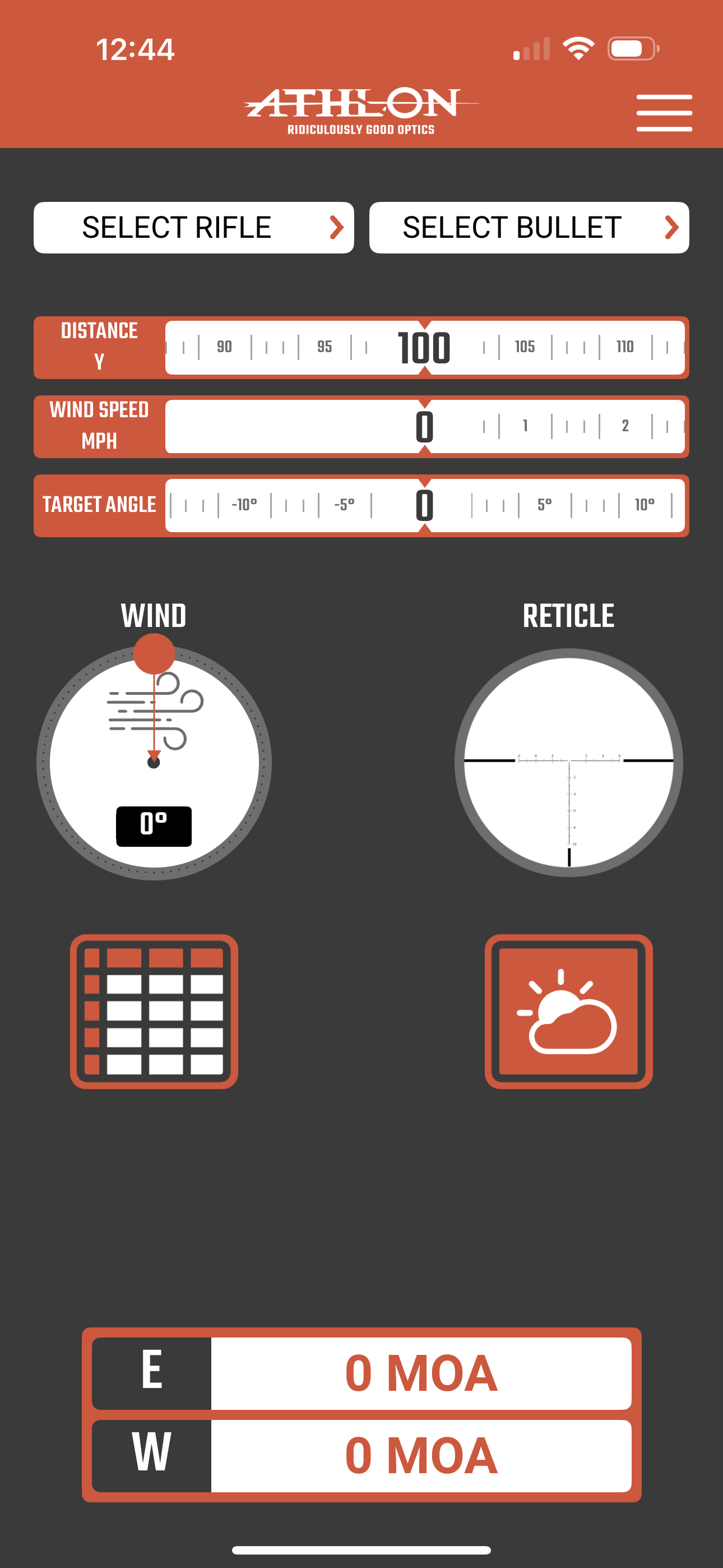

The Athlon can pull in weather data directly from the phone, wants you to add wind speed, direction and more information about your target to assist with target calculations.
The Athlon APP wants (optional) to pull in a gun profile as well as a bullet profile. I find the text on the shot data smaller than I would like.

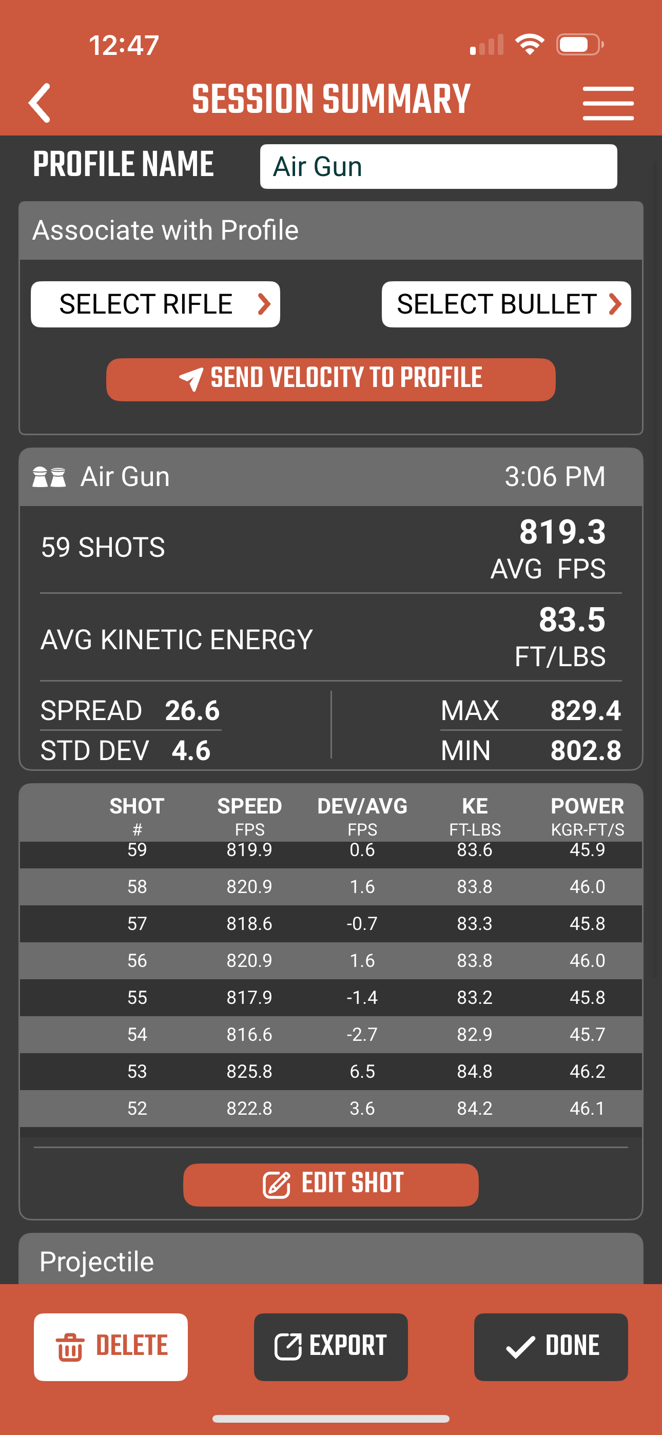

When I looked at the app reviews, there were complaints about missing shot strings being transmitted from the unit to the app for the Athlon. I didn't confirm this as I only shot one session. The app has a rating of 2 stars.
For the Garmin, it has a rating of 3 stars. It doesn't do a whole lot. It's accurate and folks export the data to do any calculations. It doesn't pull weather or any other data about the session
I just received my Athlon on Friday. I've been using it a lot since then. I think the unit itself is great, but the app is a bit funky. Fortunately, app updates are easier to do than firmware (or hardware!) updates, so I'm not too worried.
I did experience faulty transmission of shot strings from the unit to my phone. My sessions all appeared with 0 shots on the phone. I believe the issue is with selecting the Air profile when starting a quick session, instead of a rifle. All of my Rifle profile sessions transferred perfectly. Rifle is available in the 600-1200(?) fps range, so it's perfectly fine for most PCP guns.
