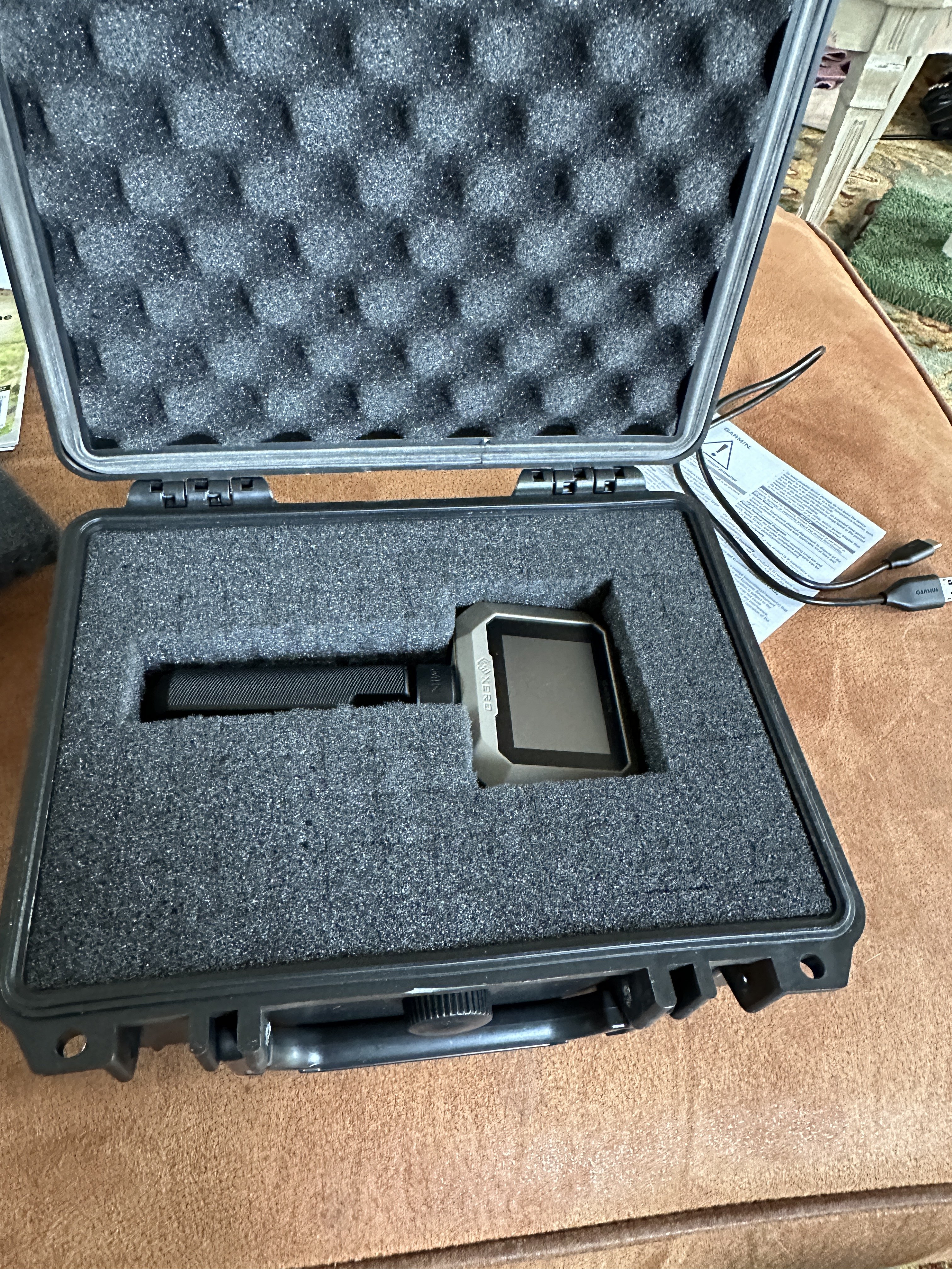

*simple setup, very, very forgiving of position relative to gun and relative to target. Setup takes literally seconds.
*tiny and easy to carry and store.

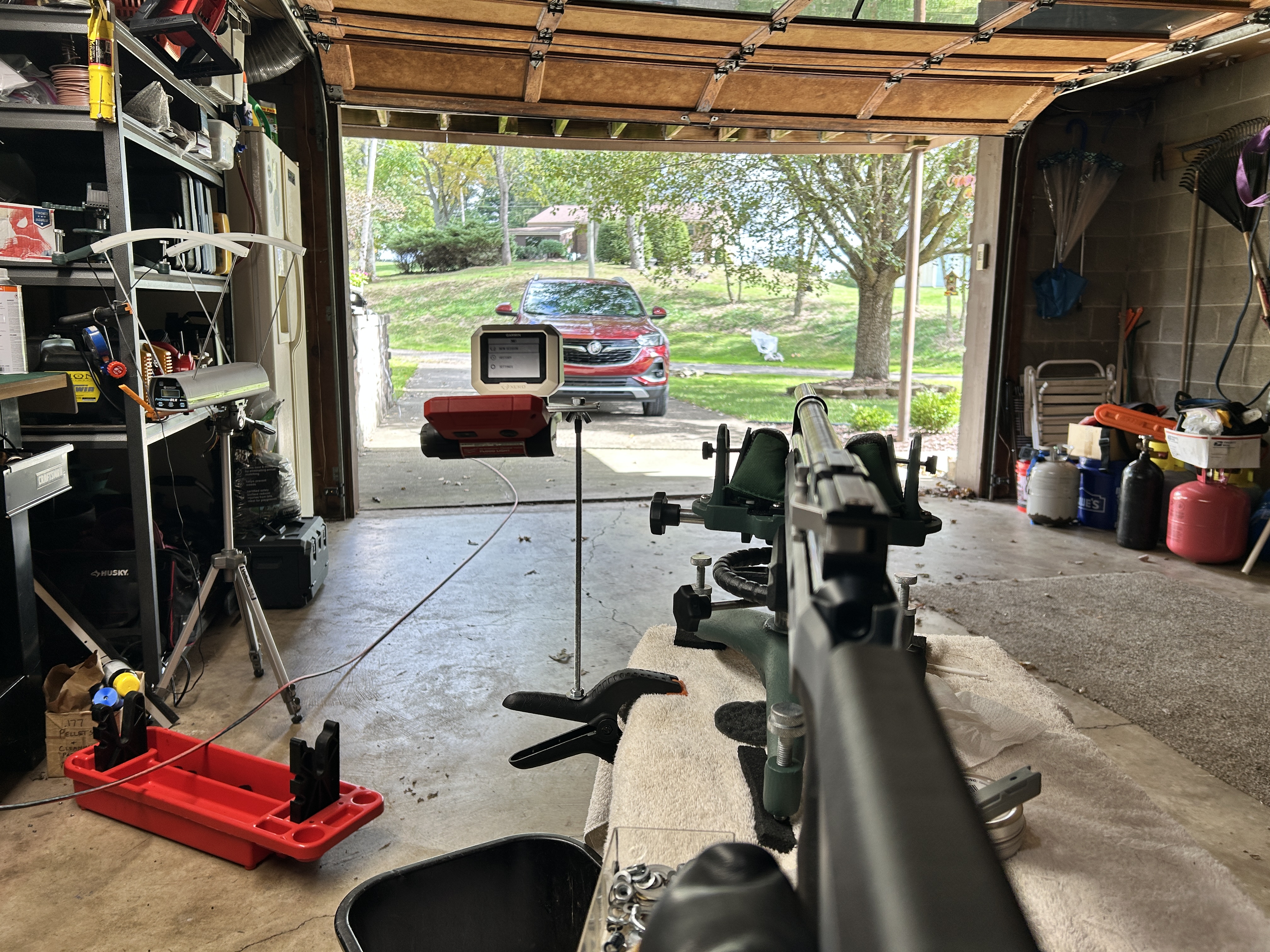

The Garmin works like magic for airguns. I normally chrono from the back of my garage for protection from weather and have a 35 yd range out my driveway. The Garmin had zero problems with the enclosed garage, deck posts and a car in the driveway and the shot path was deliberately close to the car.

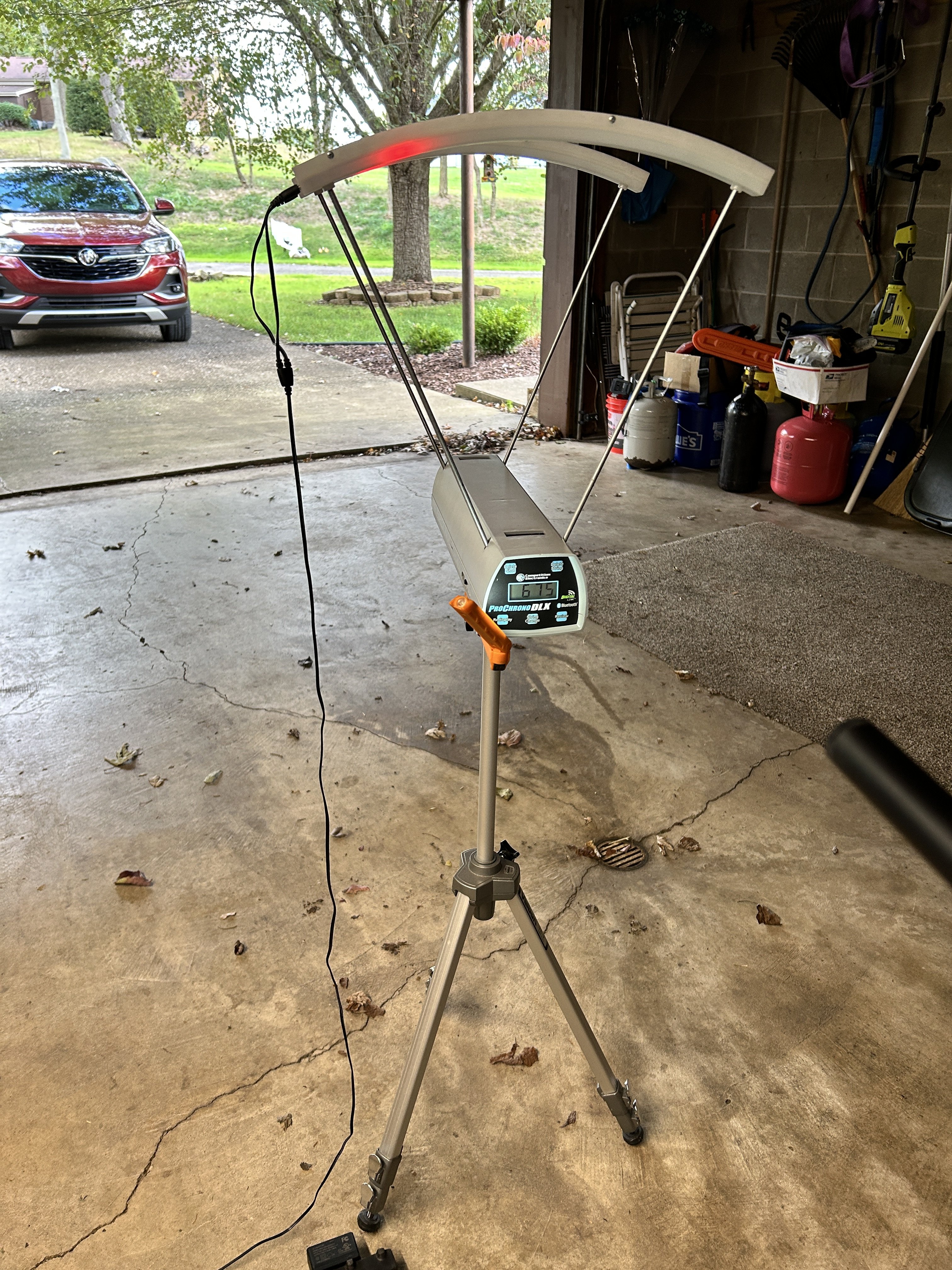

I'm pretty amazed with the first tests of the Garmin. I also have a Competition Electronics DLX and I can shoot a fairly long string, with the Garmin, in the time it takes to get the CE chrono up and running.

I just did a 20 shot comparison with my ProChrono, and I have no idea which chrono is correct, but the Garmin was pretty consistently 4 fps faster than the ProChrono, which seems pretty insignificant to me. The error between the two averaged 0.6% or just over a half a percent, which is well within my comfort zone and statistical mind. There were considerable obstructions in front of the Garmin, ... a car, the walls of the garage, the prochrono, a light in front of the prochrono, so I could see the display, etc and no problem at all for the Garmin.

I bought mine on ebay for $529, the guy had sold a lot of them. I love it, works like a champ. I've even used it in the garage at like 10' under florescent lights at night with all the doors shut, it never missed. The only time it has missed was at the range doing rapid fire, you can out shoot it, but that's to be expected. It's never missed with normal slow fire. To me this is the one to buy. LR is dropping the price every time I check..lol, the FX is over priced IMO. Oh, and buy ya a $13 indestructible case at Harbor Freight for transport and storing.

When I compared mine to other chronos, I found that it was virtually identical to my Oehler (which I consider the gold standard),which also matches my Labradar (the original unit). I have tested 3 Pact chronographs and they are always ~10fps faster than the others, but consistent with each other.
