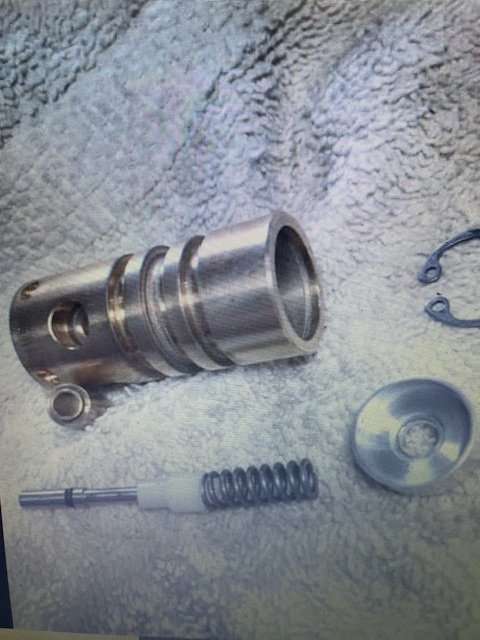

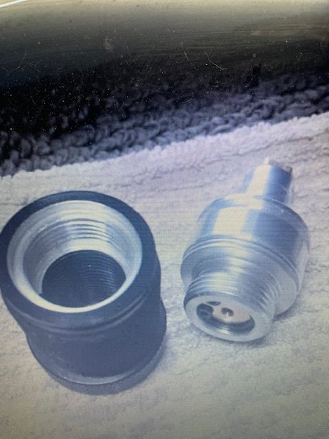

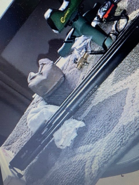

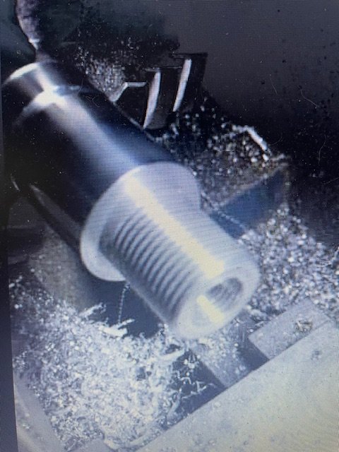

I don't have much pictures from this build other than what my younger brother took. We built it together as he want to learn. Basically I cut the Urban tube with enough left for an adapter and plenum. I then made a regulator housing using the notos piston and springs. I opened up as much as possible the valve housing and opened the T port and poppet seat to get a laminar flow. The original poppet started a slow leak as it start to dig into the seat area. So a new peek valve was made and has been working for almost 2 years now. The tank is from amazon 200cc / 4.5K rating. The barrel is tensioned and has internal baffles.

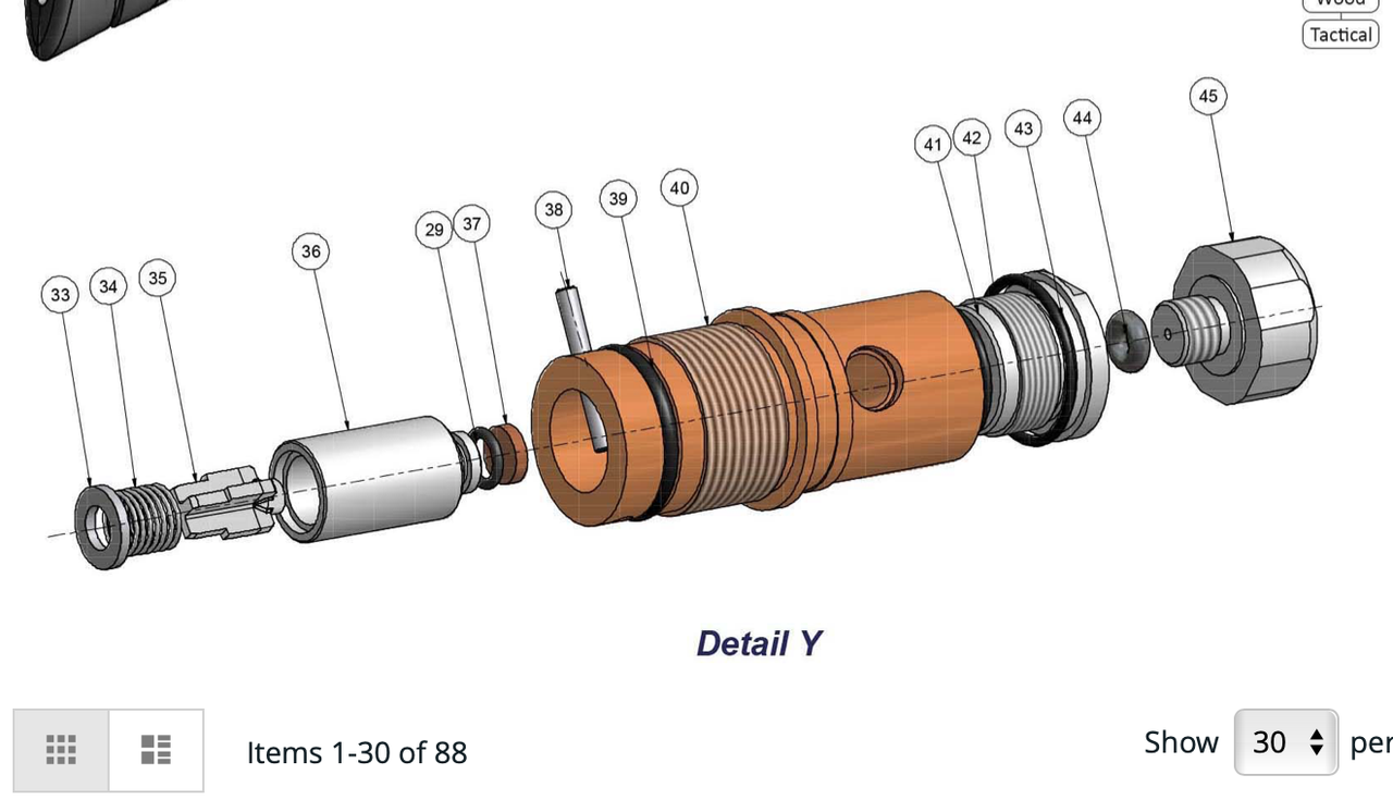

Sometimes a minor leak will resolve itself due to cycling the exhaust valve poppet and cycling the fill port each fill allowing the parts to conform to one another if those are the areas leaking. Here is the fill port assembly, O-ring under the guage (44) and the O-ring on the housing (29) and the periphery of the poppet moulding (35) that seals to the housing (36). Also check O-ring 39, clean and lube with 100% silicone grease.

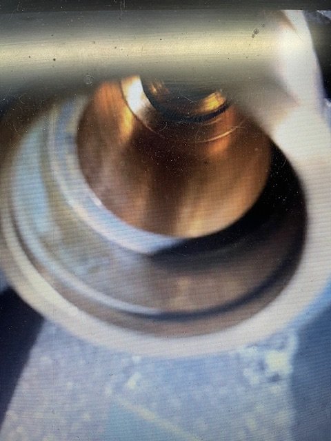

My first Urban leaked at the fill port moulding and it was contaminated with tiny bits of brass under a 10X scope. I cleaned it and burnished the plastic moulding on a varnished smooth surface. It also leaked due to scratches inside the tube, this required a one inch ball hone and a lot of labor. The rifle will now hold air until the end of time. My Urban #2 has never leaked and is perfect.
