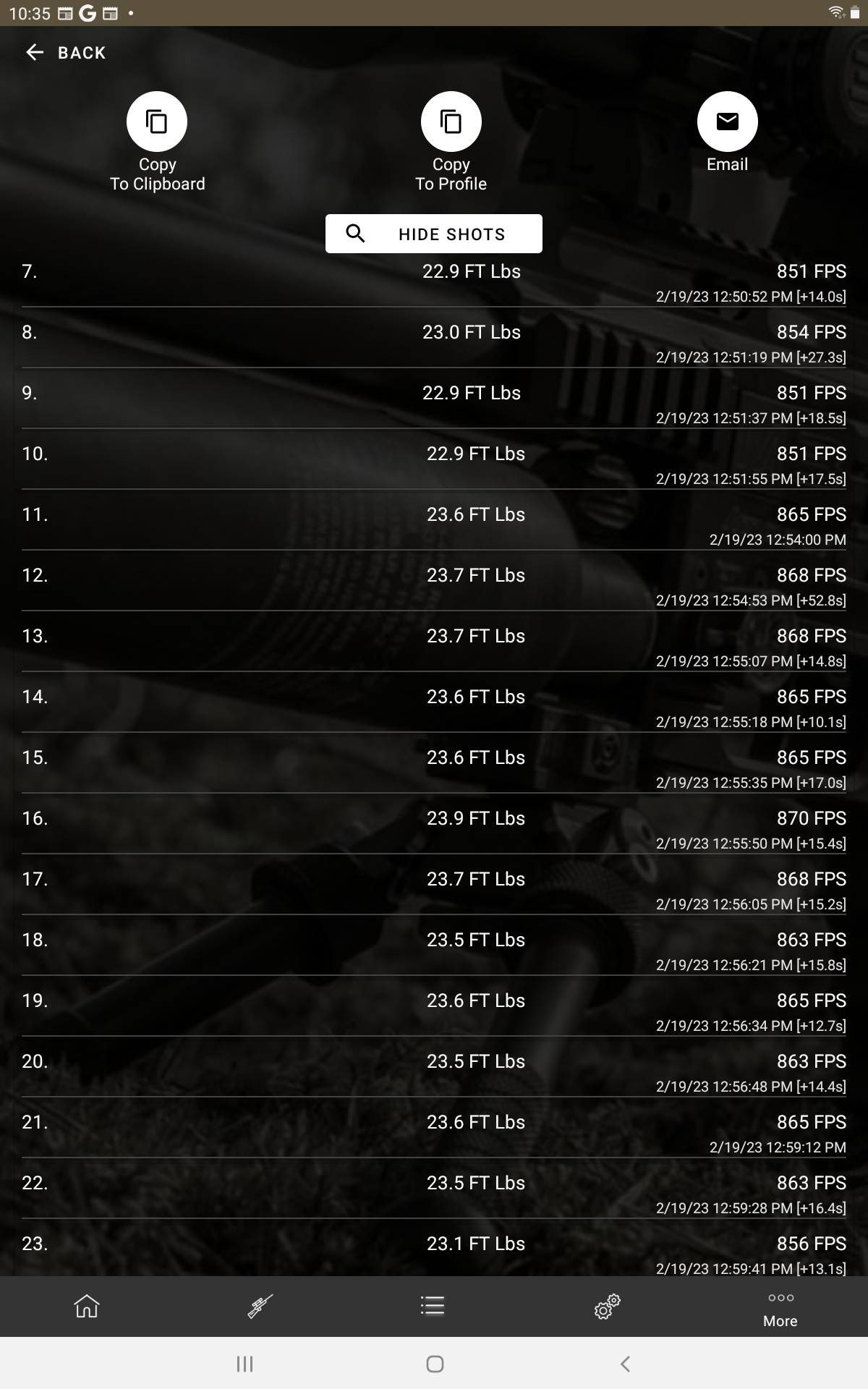

Here is a shot string from my Urban shooting 14.3 g chps . Never felt the need to adjust it .
Notes
Pellet:chps
Weight: 14.2 gr
Shot count: 30
Low: 798
Hi: 870
Avg: 851
STD Dev: 17.6
Spread: 72.0
2/19/23 12:49:16 PM,849
2/19/23 12:49:32 PM,830
2/19/23 12:49:45 PM,849
2/19/23 12:49:57 PM,849
2/19/23 12:50:11 PM,851
2/19/23 12:50:38 PM,851
2/19/23 12:50:52 PM,851
2/19/23 12:51:19 PM,854
2/19/23 12:51:37 PM,851
2/19/23 12:51:55 PM,851
2/19/23 12:54:00 PM,865
2/19/23 12:54:53 PM,868
2/19/23 12:55:07 PM,868
2/19/23 12:55:18 PM,865
2/19/23 12:55:35 PM,865
2/19/23 12:55:50 PM,870
2/19/23 12:56:05 PM,868
2/19/23 12:56:21 PM,863
2/19/23 12:56:34 PM,865
2/19/23 12:56:48 PM,863
2/19/23 12:59:12 PM,865
2/19/23 12:59:28 PM,863
2/19/23 12:59:41 PM,856
2/19/23 12:59:58 PM,849
2/19/23 1:00:10 PM,842
2/19/23 1:00:23 PM,835
2/19/23 1:00:39 PM,828
2/19/23 1:00:53 PM,823
2/19/23 1:01:08 PM,810
2/19/23 1:01:24 PM,798
