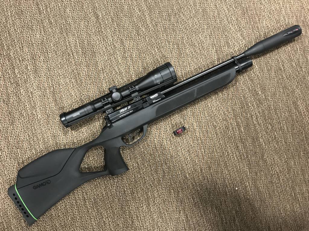

I got a new Gamo Urban 22 a couple weeks ago and I think I finally have it dialed in.
The bore was full of crud and took a whole evening to get clean. I finished with a light coat of Renaissance wax and mounted a Hawke 4-12 X 50 AO.

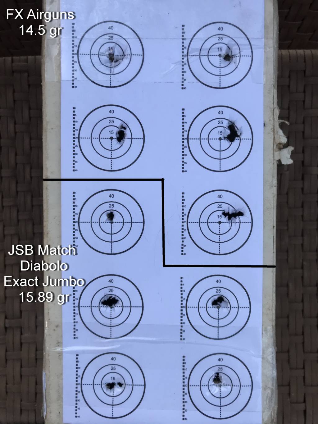

For the first week I was busy experimenting with different pellets trying to find what it liked. Initial groups were a let down, but I figured it would take some number of pellets to get it loosened up. I ordered another assortment and kept shooting. After many rounds fired, I started getting pretty nice 25 yard groups with the FX 15.9 gr pellets . Air Arms 16 gr Diabolo Field also group nicely.

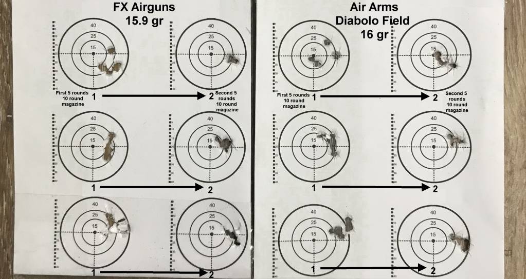

I realized this weekend, that the two 10-round magazines I have are more accurate if only loaded to with 5 pellets. (see pic)

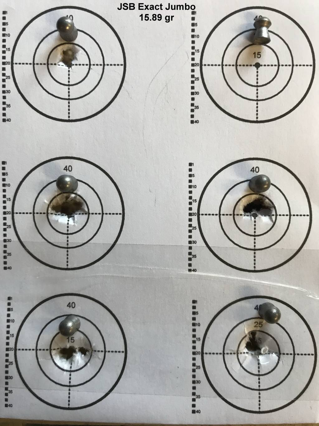

Another interesting discovery today, was the JSB Jumbo 15.89 gr pellets that were rejected 2 weeks ago for lack of accuracy, are now the most accurate of all the pellets I've tried, at least at 25 yards or less.

So I bought my dad a Gamo urban in hopes that he would get the bug and come to the dark side with me. He loves it and I do too. Power could be a little better but the accuracy and shot count is amazing. I'm surprised that your gun is being pick at all because mine shoots everything great. It's hard to find a pellet it doesn't like. Cph are almost as accurate as jsbs! I suggest you look closely at that mag. I suspect that it is deforming pellets and hurting your accuracy. Especially if putting 5 in yields better results. Also on my dad's the holes in the mag didn't line up exactly square and it was cutting the oring on the probe and deforming the pellets. I bought a new mag and problem solved. You might want to start there. The gun is really a very accurate gun. I recommend buying a Charlie da tuna trigger. This is the single best upgrade you can do. It transformed that gun into a whole new animal and only cost 35 bucks or so. God bless buddy Thanks for sharing.
"I suggest you look closely at that mag. I suspect that it is deforming pellets and hurting your accuracy. Especially if putting 5 in yields better results. Also on my dad's the holes in the mag didn't line up exactly square and it was cutting the oring on the probe and deforming the pellets. I bought a new mag and problem solved. You might want to start there."
I bought a spare magazine before I received the gun, so I'm running 2 magazines, both with the same results. The first 5 shot groups at 25 yards are not bad when loaded to 10 rounds, but when I load to only 5 rounds with either magazine, the groups tighten up to about half the CTC measurement.

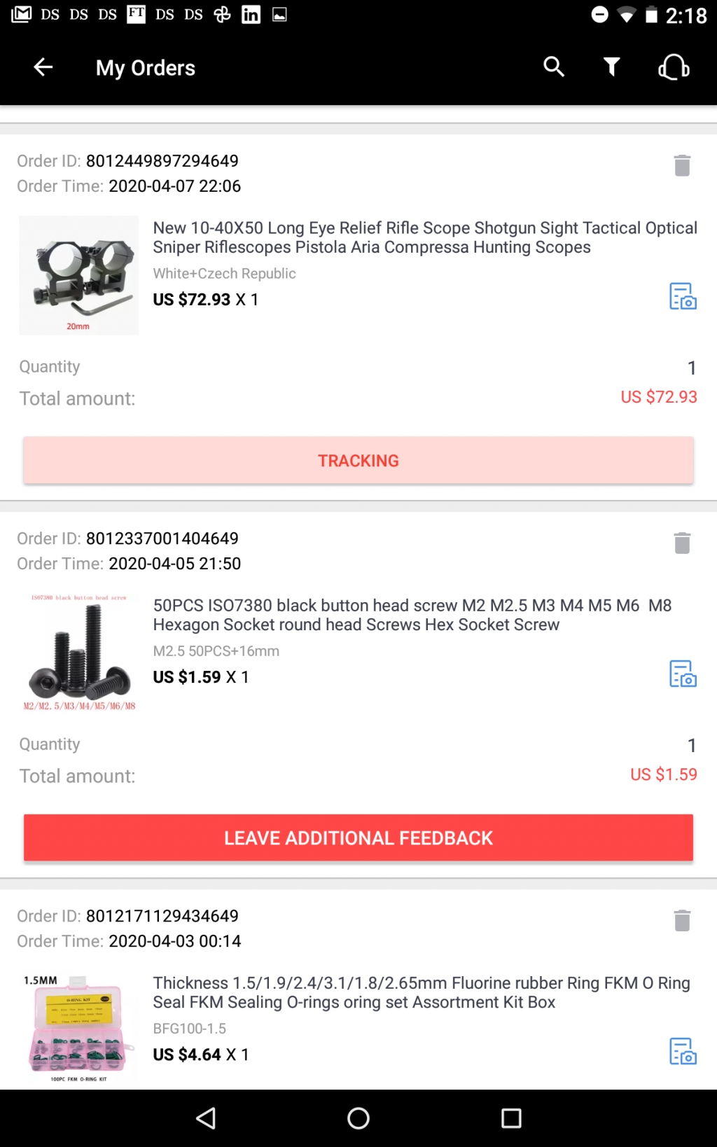

Parrotculler,
Thank you for letting me know to look in the barrel band for an M2.5 x 8!
I had already ordered 10 of them on ebay for $3.97, but with your info, I made the change immediately. I'll replace the barrel band screw when they arrive.
In the mean time.... WOW! What a difference the longer screw made!
I watched the Airgun Depot video and followed Travis' method using a rubber mallet to test the trigger. I began with the typical long 2nd stage that broke consistently around 2 lb. 5 oz. The end result is an extremely short 2nd stage breaking at 1 lb 4 oz.
