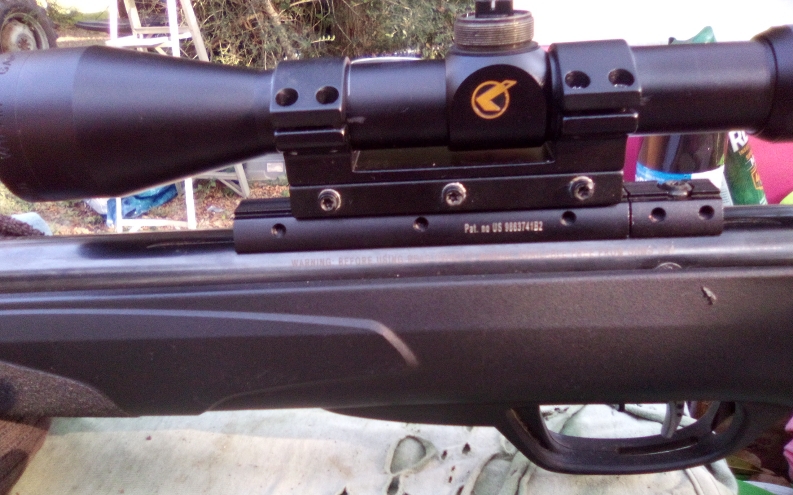

Or it is not you at all. My new Gen 3i bone collector that factory scope loved to walk the walk backwards and after egging the pin hole the recoil pin sheared right off. All of a sudden my shots were off and looking at the mount it was jammed all the way back to the rear screw they have in their recoil reducing rail.

If you look at the scope it is a Hawke 4-12 airmax and once again to use it versus the crappy factory scope I had to file the rear stop screw down a bit and using a cobalt drill made a recoil pin hole in the stop screw itself, this allows the use of a full size scope mounted all the way back on the magical recoil reducing rail.
