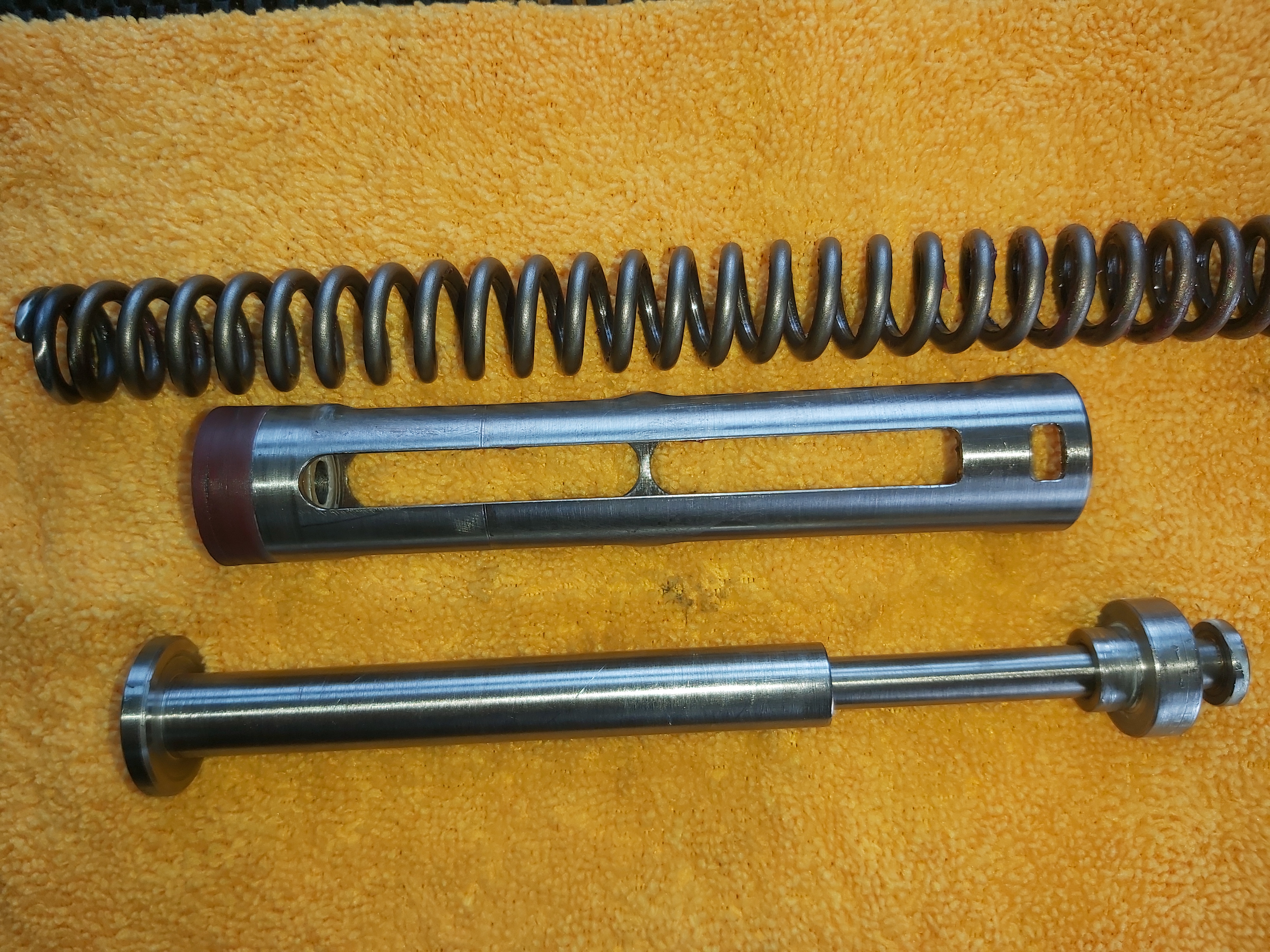

Am new to air guns, and find it a interesting hobby. Made a lighter piston just to prove that it will slow down the speed of the pellet, as opposed to the expected increase. Since at it, would like to bring back the speed. Not to 1000 fps, but close to 900 would be nice. Factory speed was mid 700. Will try with a stronger helical spring. Was wondering if anybody has converted a Gamo NP to spring and willing to share the experience. I will do it anyways, just for the fun of it! :) No PCP for me. At least, not yet!

If is a scope killer, why not go back? If you want that extra 70 fps, can get a stronger or longer spring, or just shim it up a little. Hope you don't mind me asking. What caliber and what speed did it have factory? Mine is a Gamo Bonne Collector Gen.3 in .22 cal. With a 14.66 gr. Premier pellets was getting 770's, and with the 30% lighter piston 730's fps. Have ordered a spring and Weihrauch style seal. Other than spring guide don't see a need for anything else. May make a top hat, but the piston I.D. is close to the springs dia. so don't think will need one.

All worked out. Like the way it shoots with spring. The spring guide and top hat are guided as well.
In the pic. the guides are steel, but made them from delrin as well. With this lighter piston shoots smooth 820 fps with Premier 14.3 pellets, and fairly accurate. Still need to try with factory piston, and with extended top hat. Maybe even a slightly longer spring. Used a 260 mm long, and have about 1' compressed at assembly. May try longer top hat or 270 mm spring. Is nice that Vortec cuts and grinds the spring ends to size.
