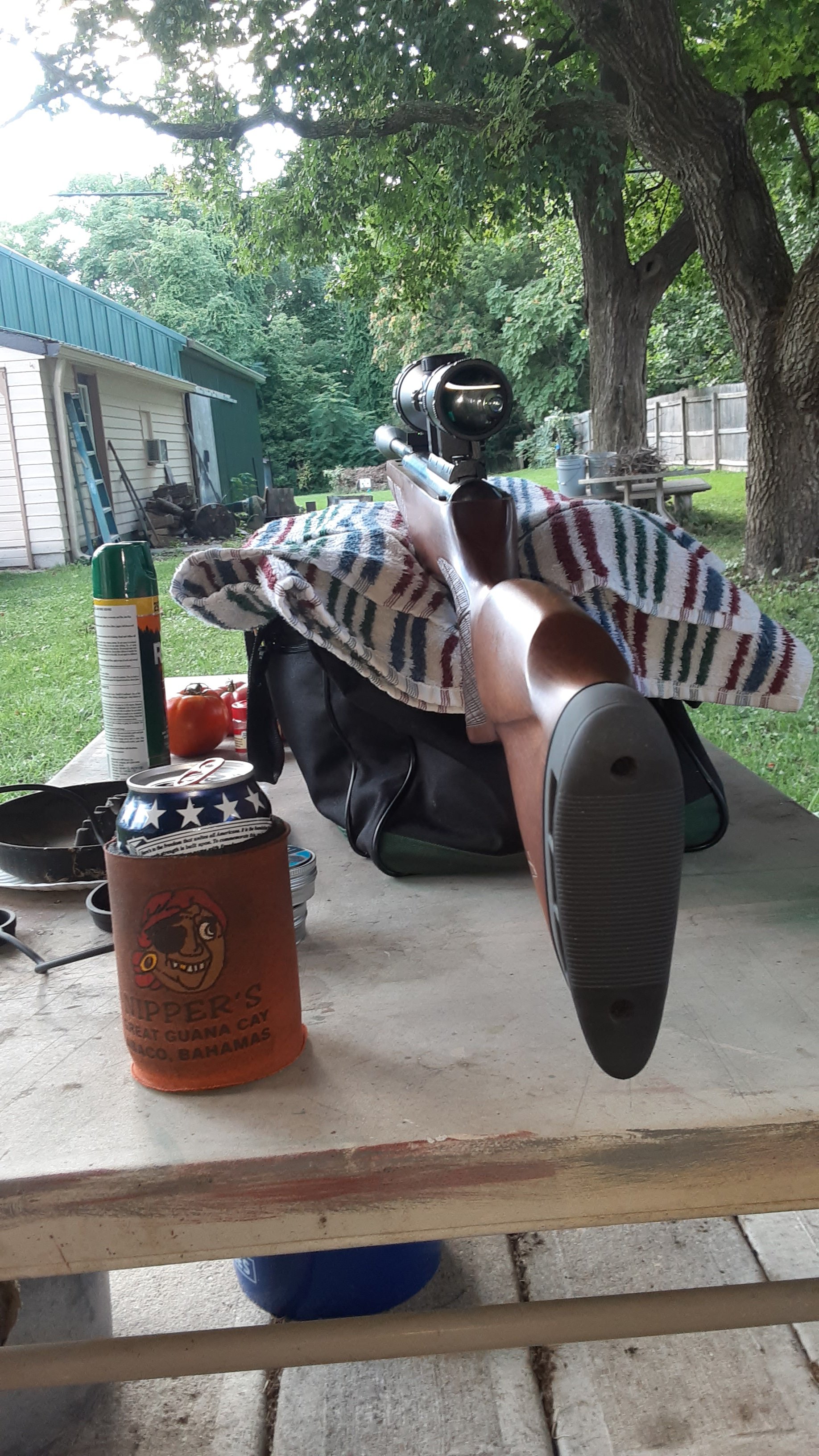

Hello, new guy here. I grew up playing with a crossman 760 and a while back inherited a whisper fusion 177 from my dad (still my favorite plinker). I recently purchased a 22 hunter extreme pro and want to know what amo fellow gamo magnum shooters like.
I have 63 yards to work with and looking to eliminate some ground hogs, please let me know what you all like.

Yeah, I didn't think my groups were bad. I'm about to place an order with pyramid (labor day sale) and looking for opinions. Thanks for your input JSBs are in my cart.
