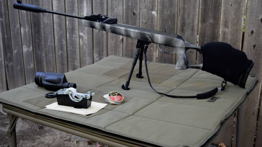

Since I only have 25-yards for 99% of my shooting, I just said screw it and left it off. Now it's my almost daily shooter.
Pic of my precious, after a few changes. I just can't leave a gun lookin' like everyone else's. :)
