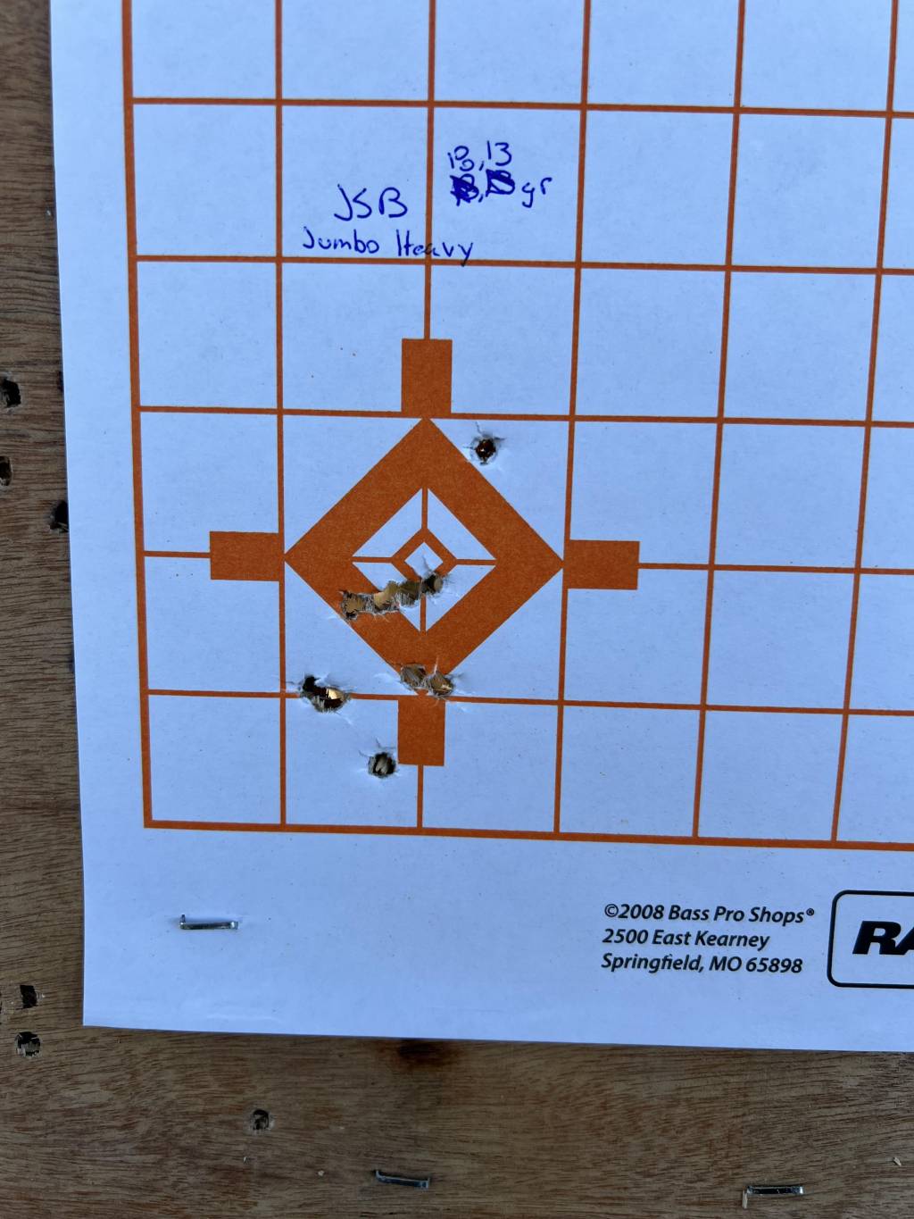

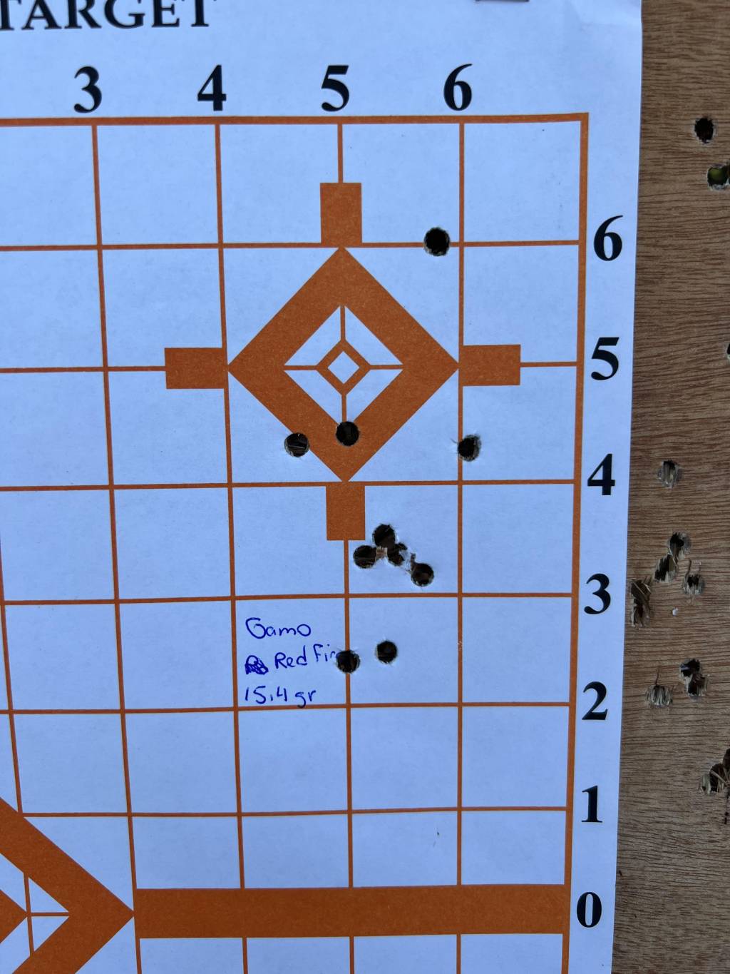

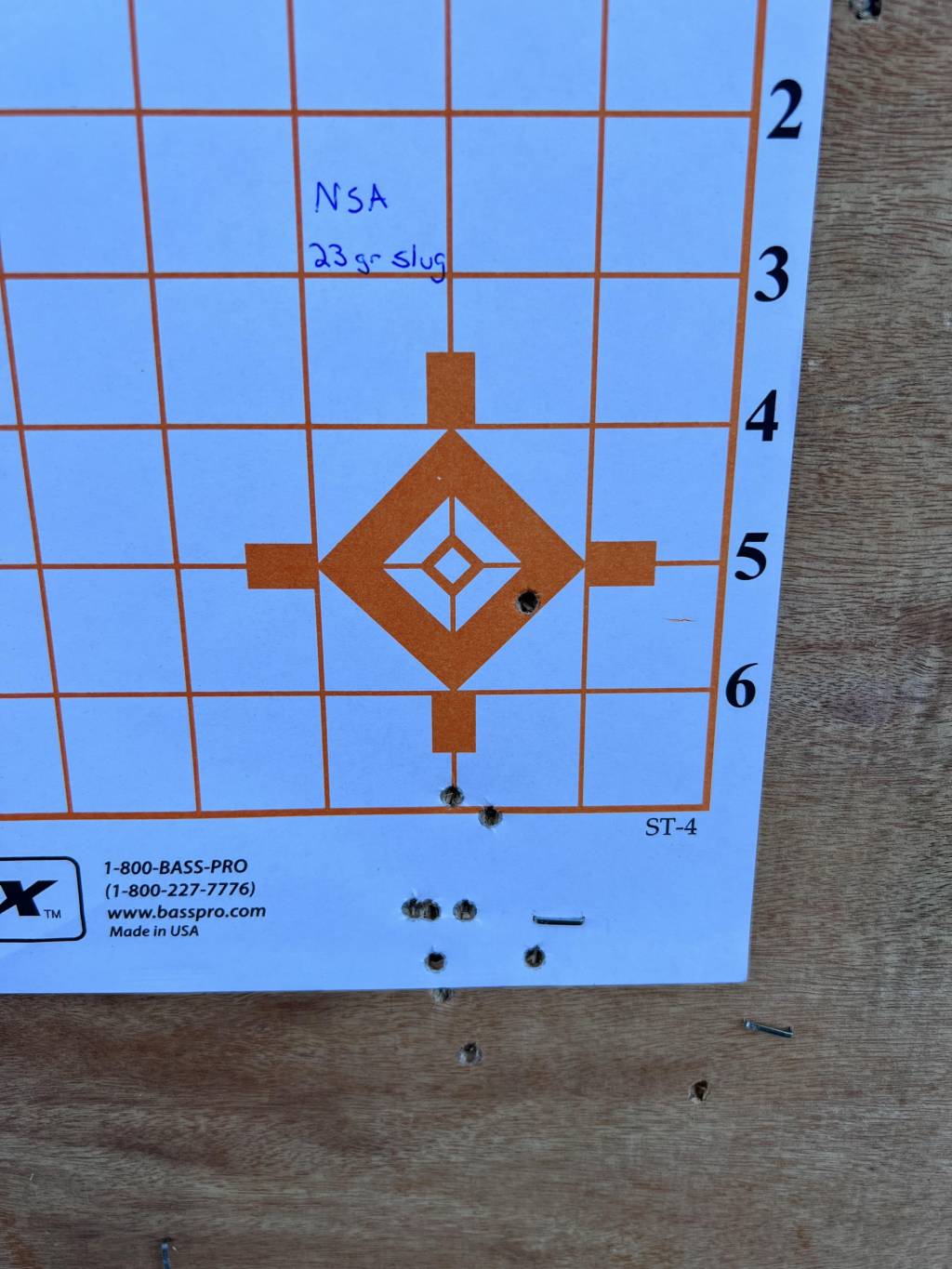

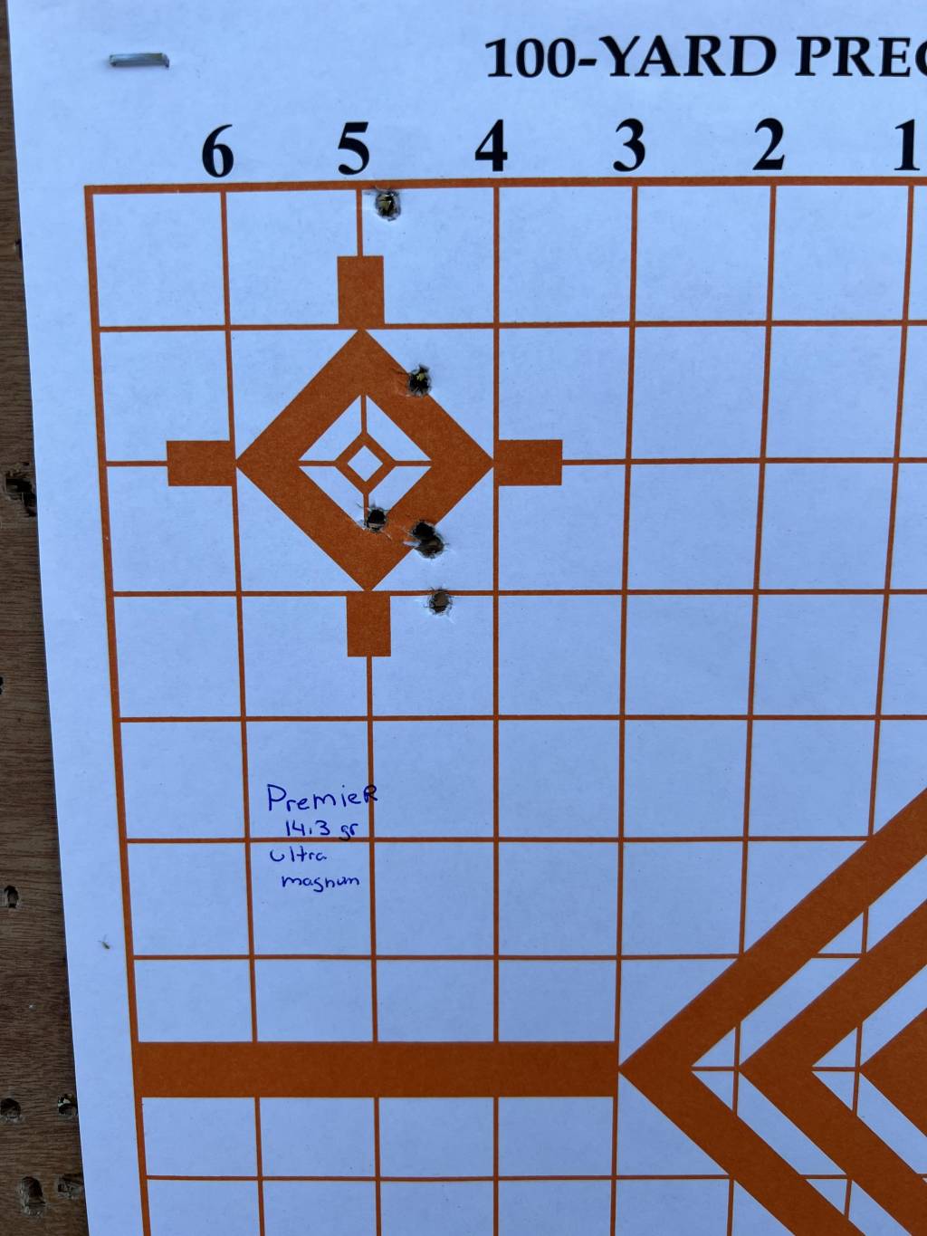

I did some testing today with a Caldwell chrono. It’s touchy. Didn’t ready a lot. This is on a rest at 26 yards
Sure looks like dieseling. Lube still seeping out when first couple shots taken.
