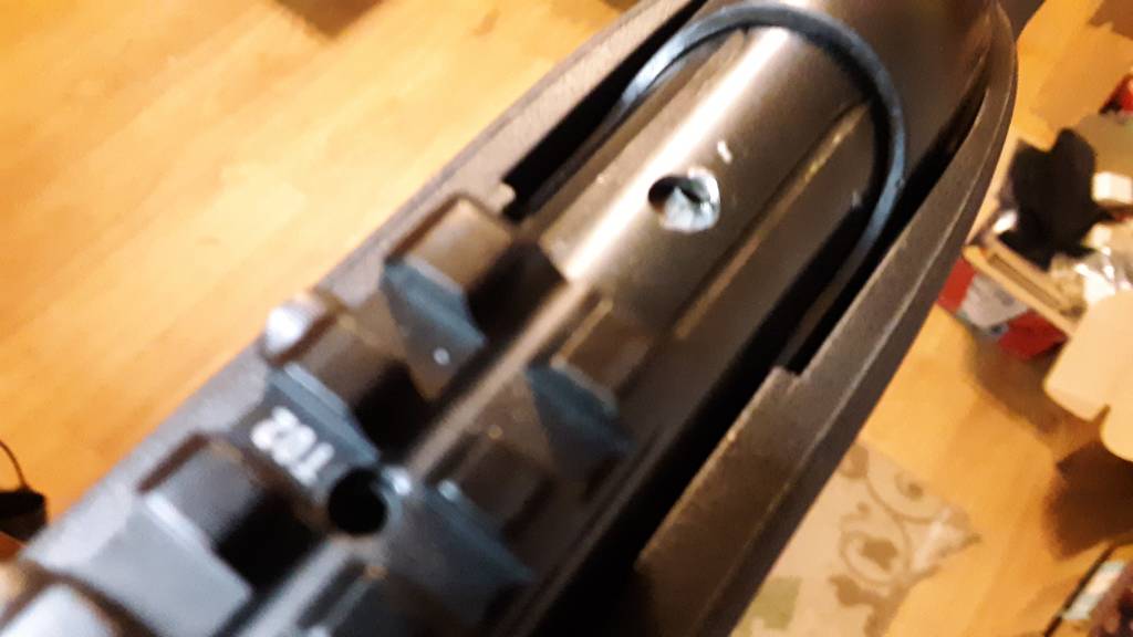

I have about 300 pellets thru this thing. Can't get the thing sighted in because everything on the gun shoots loose every 10 shots. The scope rail on the thing is soft aluminum and any scope mount adapter with the vertical pin to stop linear scope travel simply starts battering a groove in the rail. The aluminum rail adapter is actually made in two parts connected by two short rods made of a hard plastic. I don't know why they have the rods because they do no good. I tried removing the adapter and mounting the scope rings adapter directly to the receiver but the same thing happens. The pin simply begins battering the hole in the receiver. Gamo needs to incorporate a weaver type attachment to the gun and quit trying to get a 3.5 mm diameter threaded pin to take the load to prevent scope travel. I have used blue locktite on all fasteners with no real luck.

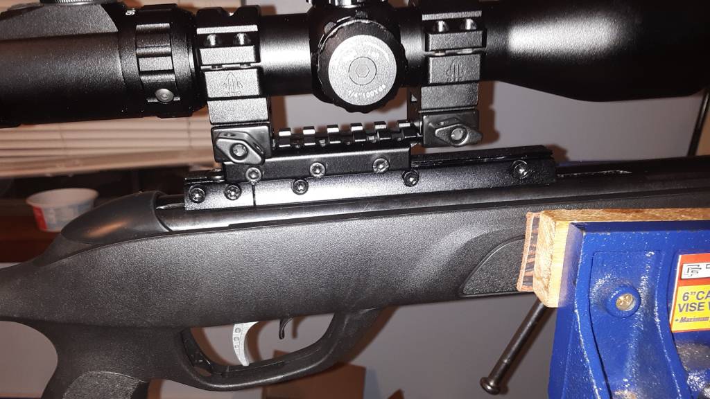

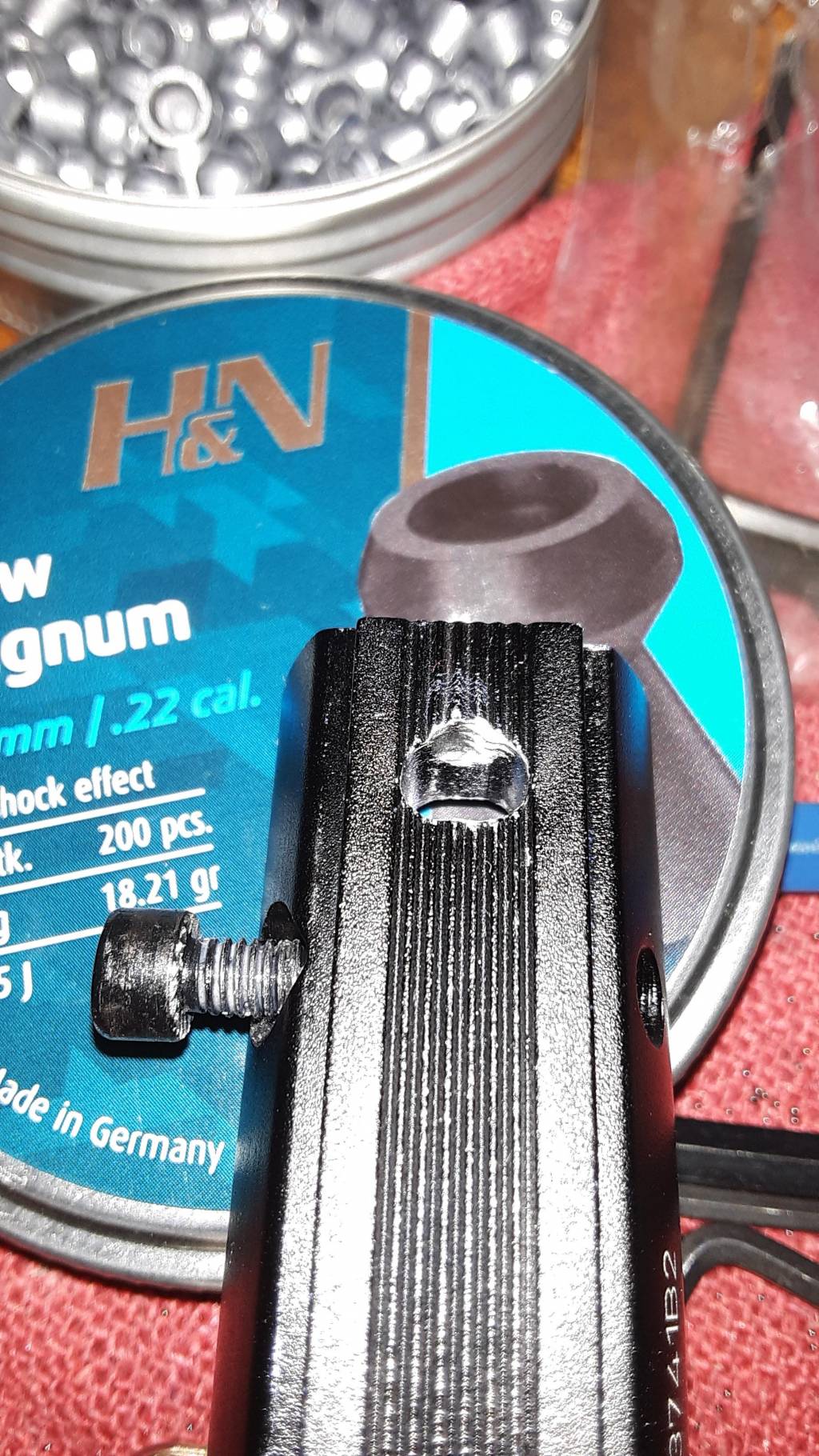

Sorry for the delay. This is the set up I have been using. The factory rail (11mm to 11mm) attached to the receiver. Then a mount adapter (11mm to weaver with three cross screws) ) with the scope attached. The factory (11mm to 11mm ) seems to serve no purpose except to raise the scope about 9mm. The second picture shows the hole in the adapter which is being pounded by the pin. The whole problem is to a great extent caused by the fact that the size of the pin and the size of the hole are mismatched. I tried mounting the 11mm to weaver adapter directly to the receiver with the pin entering the hole in the receiver. The third picture shows that the pin is pounding the receiver hole. It had raised a large burr which I have dressed down. (It was razor sharp which sliced my finger). Sorry for the poor quality pictures.
