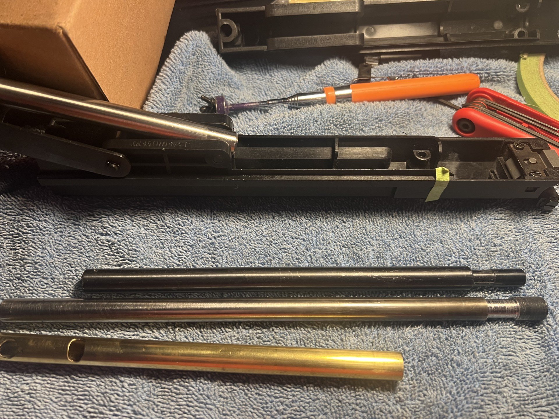

the barrel search started and not much found and then i remembered i had extra Crosman SSP-250 barrels and this journey began

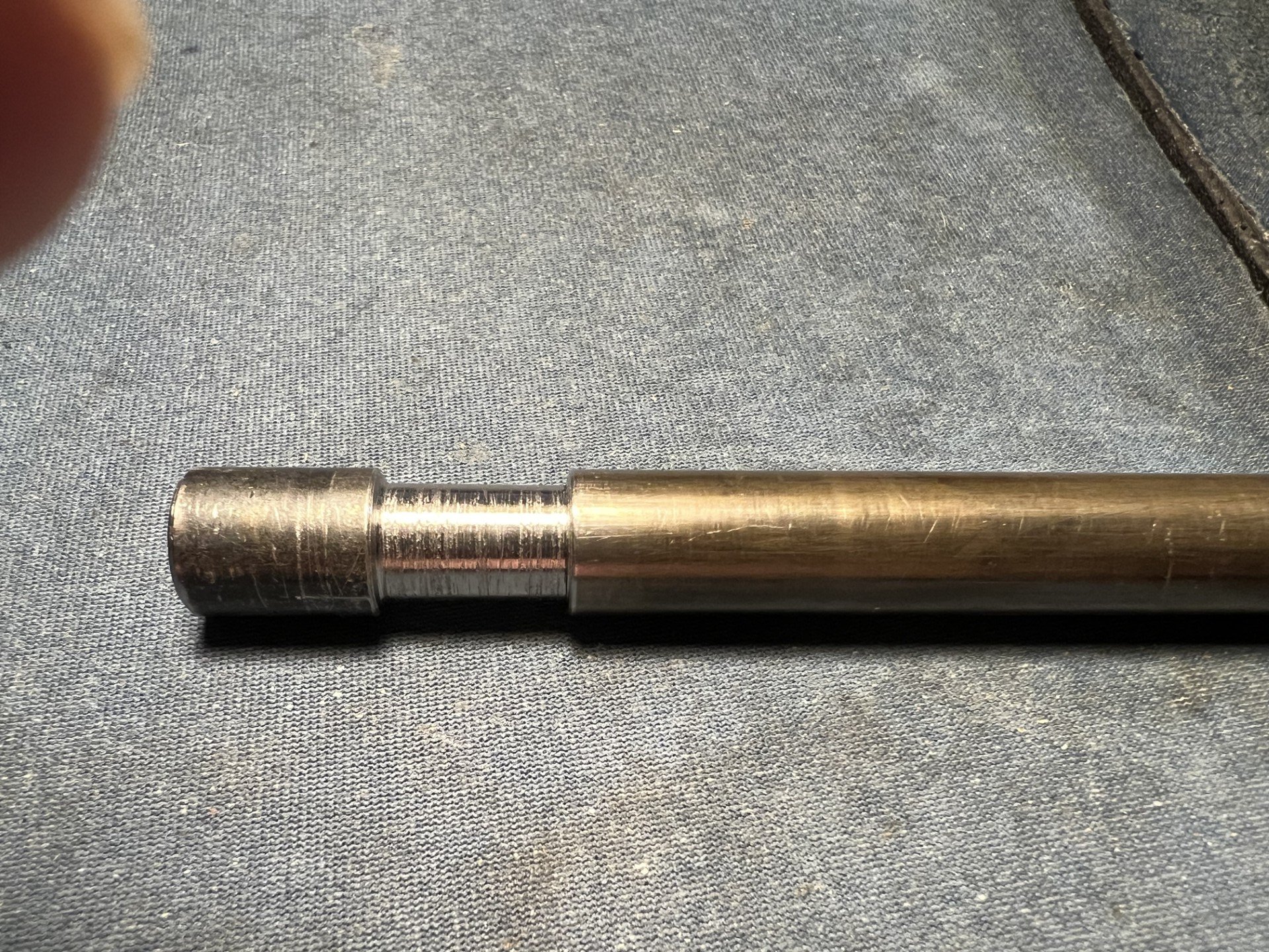

barrel was at about 11.7mm OD length was good out past the cocking handle
the barrel in the Compact is larger in OD so a shim would be needed out front and found some brass tubing that was close much time to make the two slide over each other but i ended up with a net-net fit

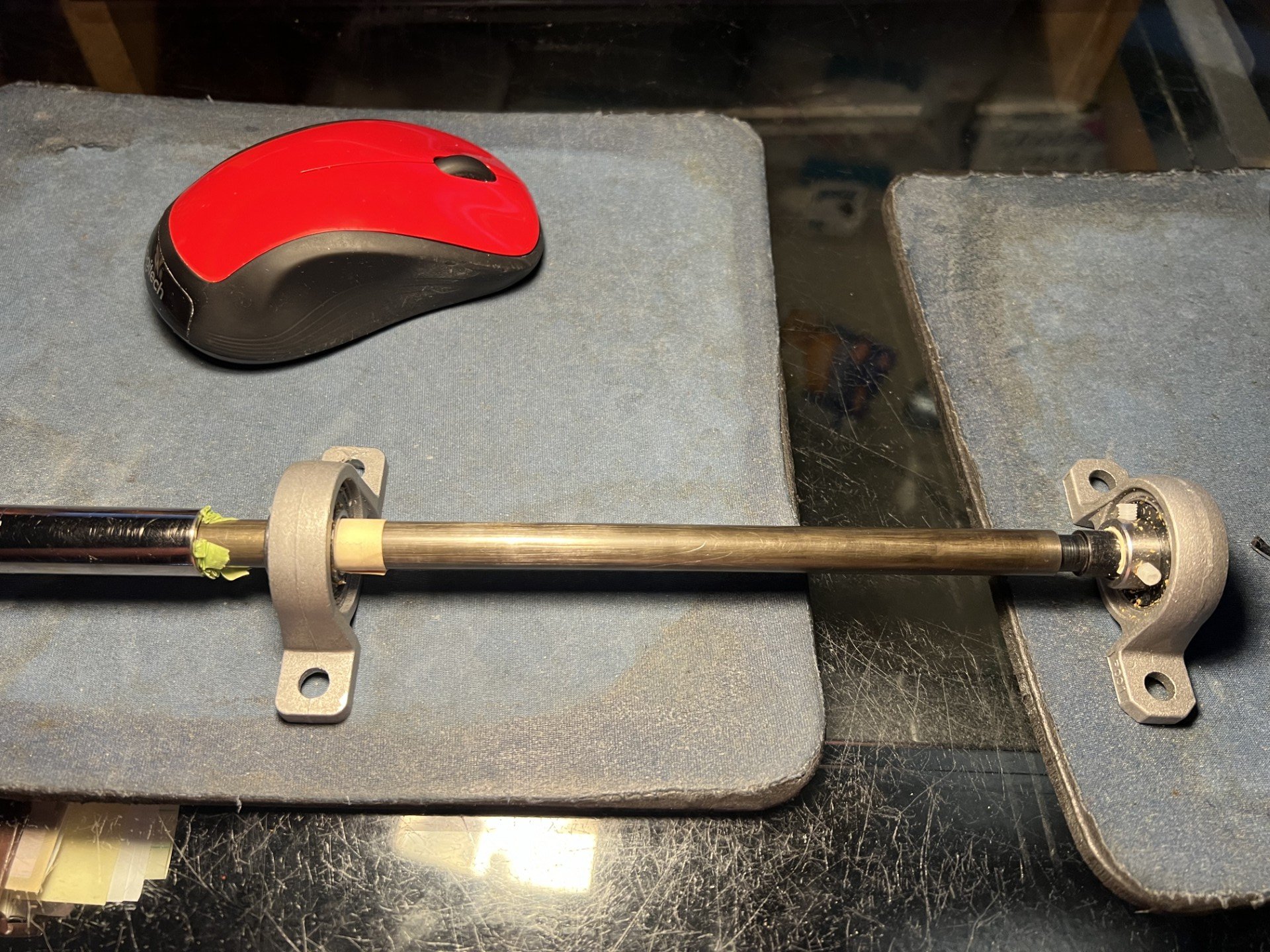

then i needed a little more barrel cut out at the clamping band and made my pillow block lathe for that

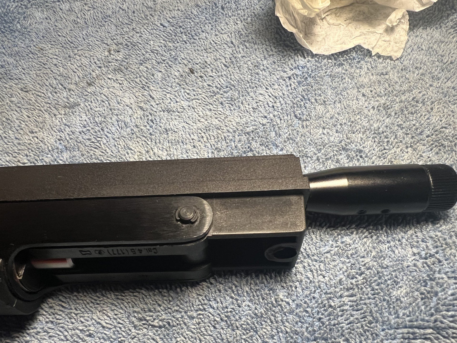

in the picture you will see some of the bit and pieces and the end result is and longer barrel that could be used for that silencer but maybe not

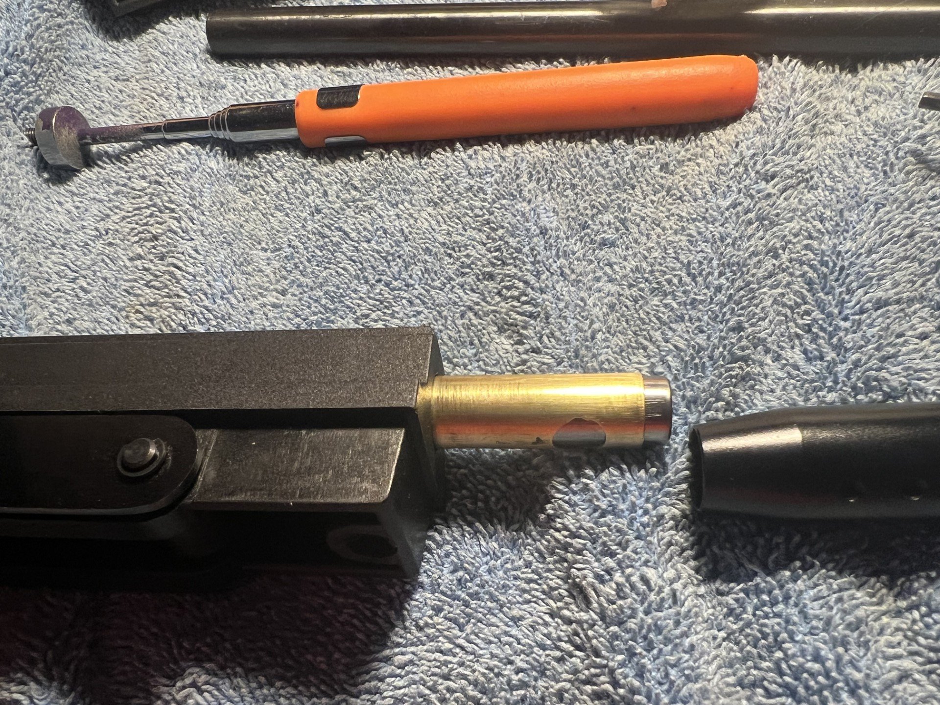

in the picture you will see i have a little brass showing it happens
and there you have it the cocking handle doesn't open that far but the silencer would hit
and there you have it the cocking handle doesn't need to open that far but the silencer would hit
