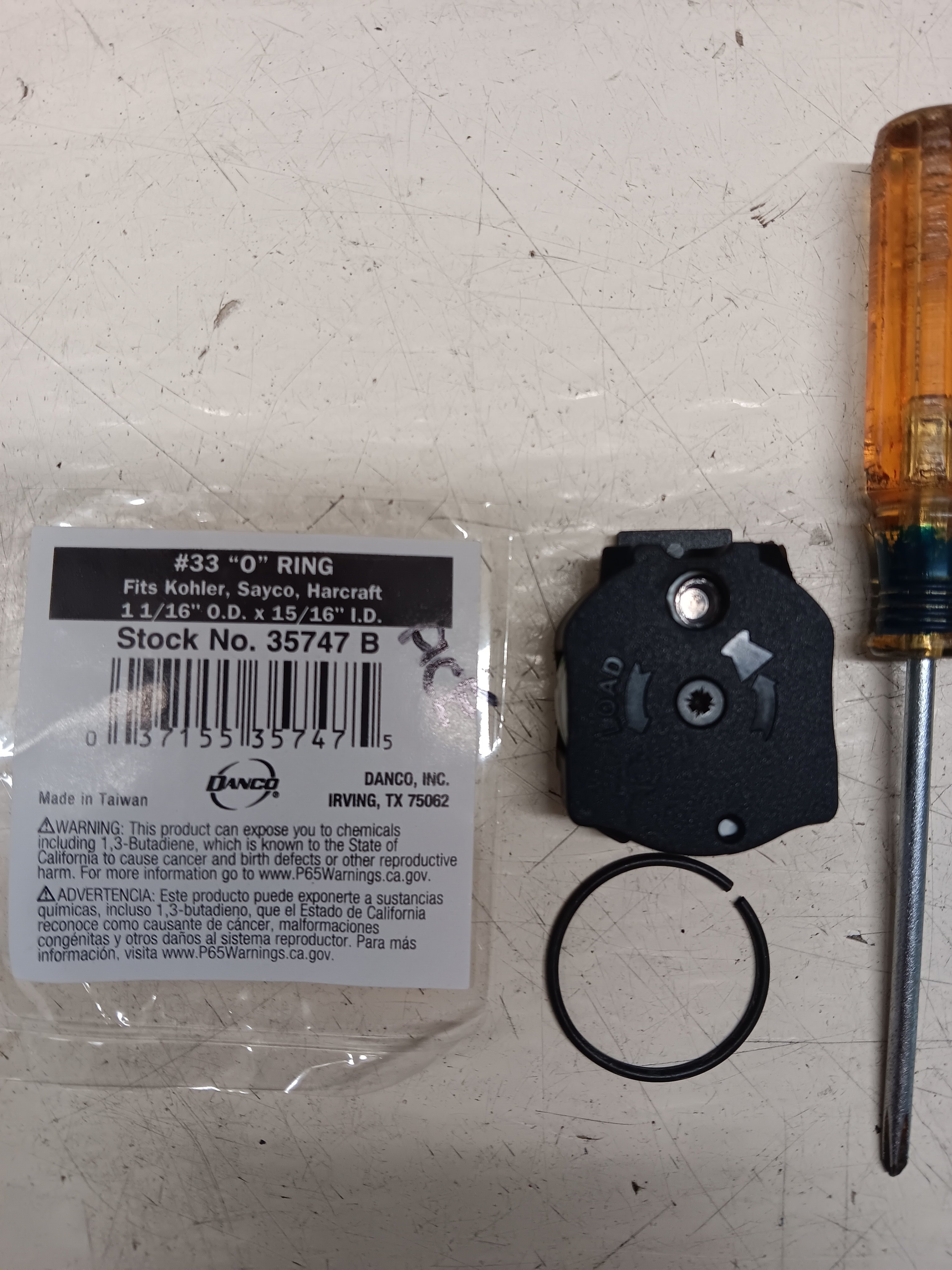

It's easy to fix the Gamo Swarm magazines when the rubber retaining ring stretches or breaks and the pellets are loose and fall out. Take out the tiny Phillips head screw in the center of the magazine with a size 0 phillips screwdriver. Remove the rotating hub that the pellets fit in and replace the rubber o-ring that goes around it and holds the pellets in place. I took the hub to Ace hardware and bought a 1& 1/16" O.D by 15/16 "I.D o-ring and it works fine.
Also, when loading the pellets in the magizine, "snap" the pellets in position using a little punch. You will hear a little "snap" when the rubber O-ring catches the "waist" of the pellet and locks it in position.
