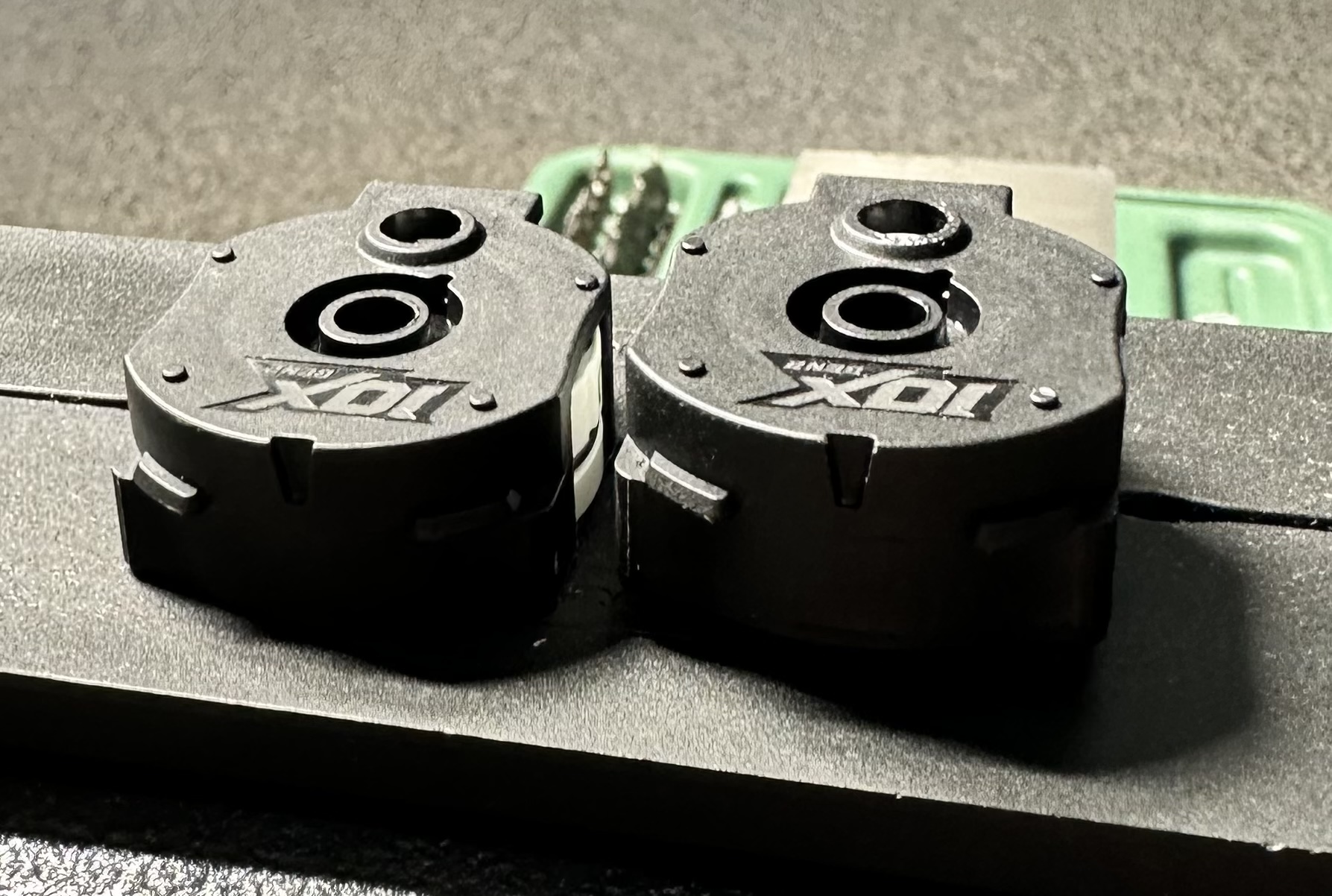

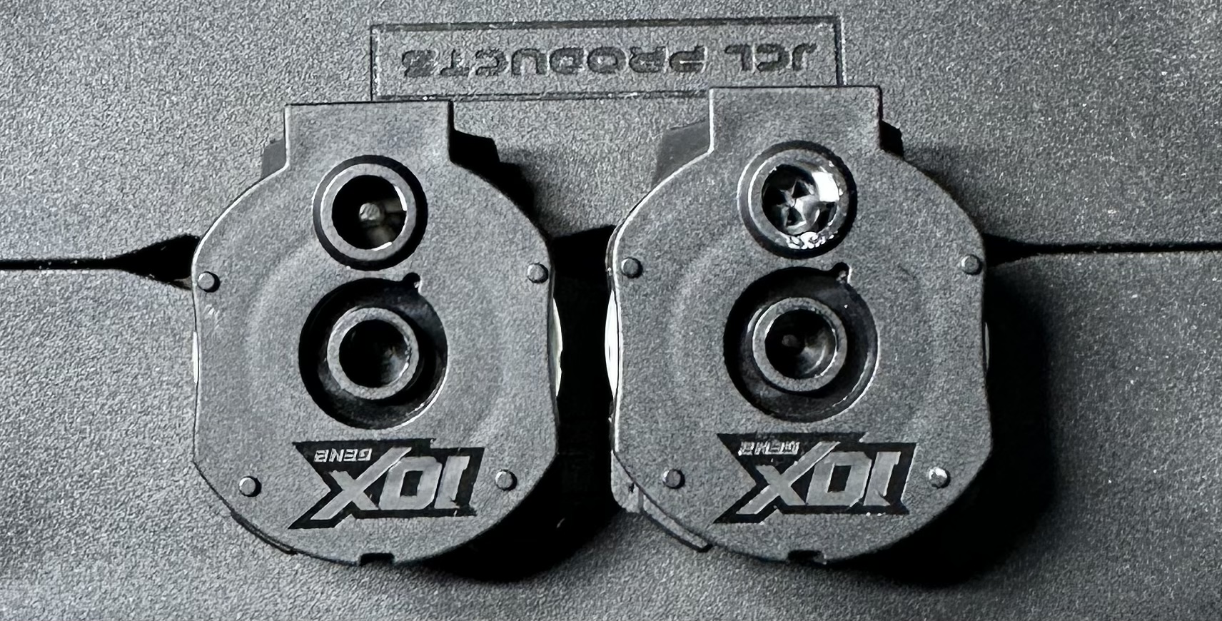

Mounted a Hawke Scope (fit perfect) and loaded a magazine and broke/cocked the barrel and it didn’t load a pellet… tried a Gen-2 magazine (didn’t load) tried several different Gen-3 magazines with different pellets (doesn’t load a pellet) what am I doing wrong?

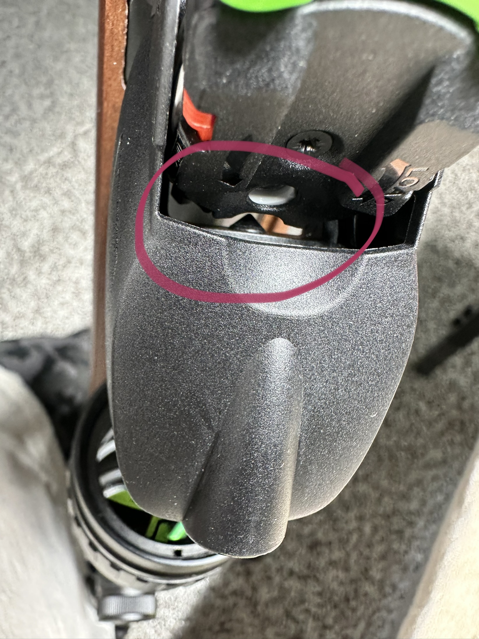

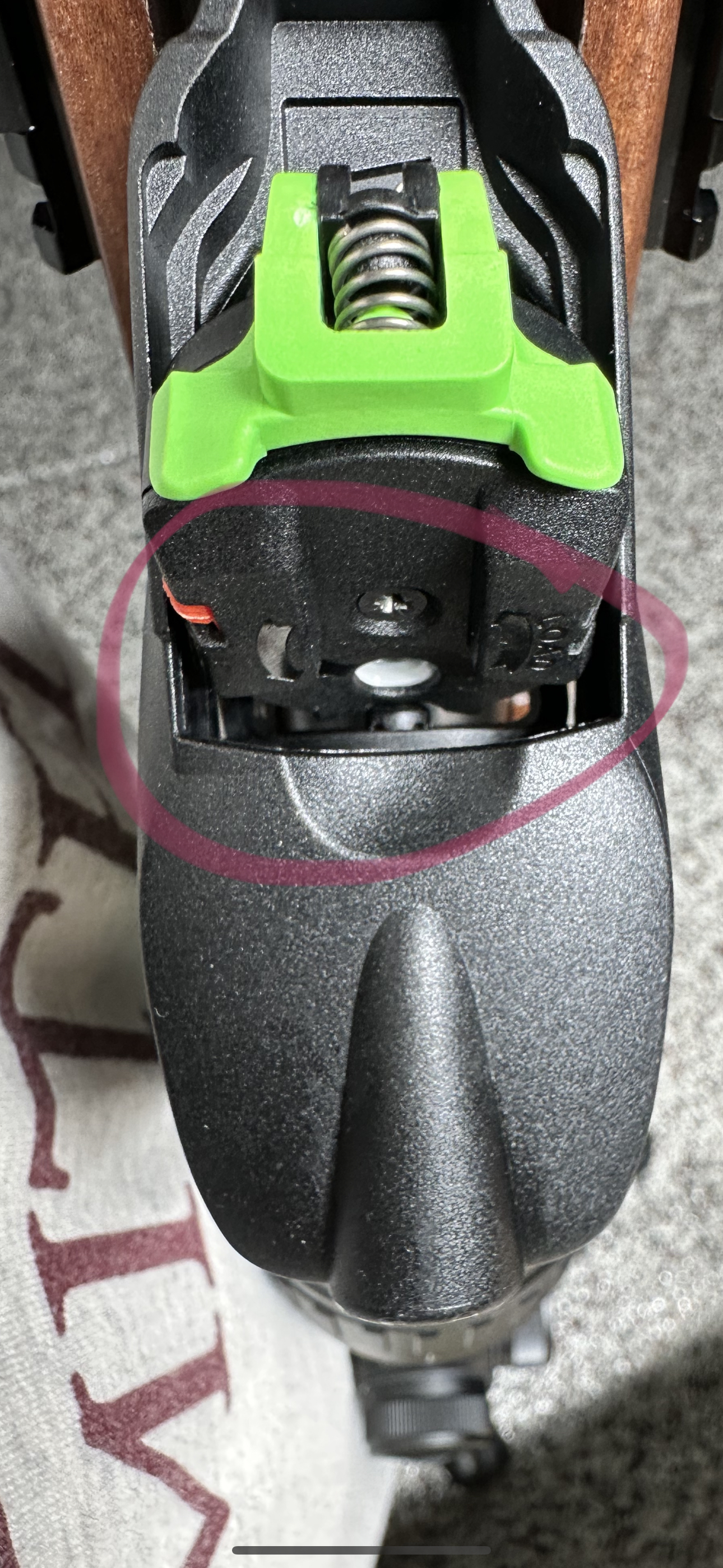

The problem is when you break/cock the gun the inertia system is malfunctioning.
In Pic #1 can see it’s in the wrong position to line up with the pusher pin. It should automatically align (tilt forward) with it but it’s not.

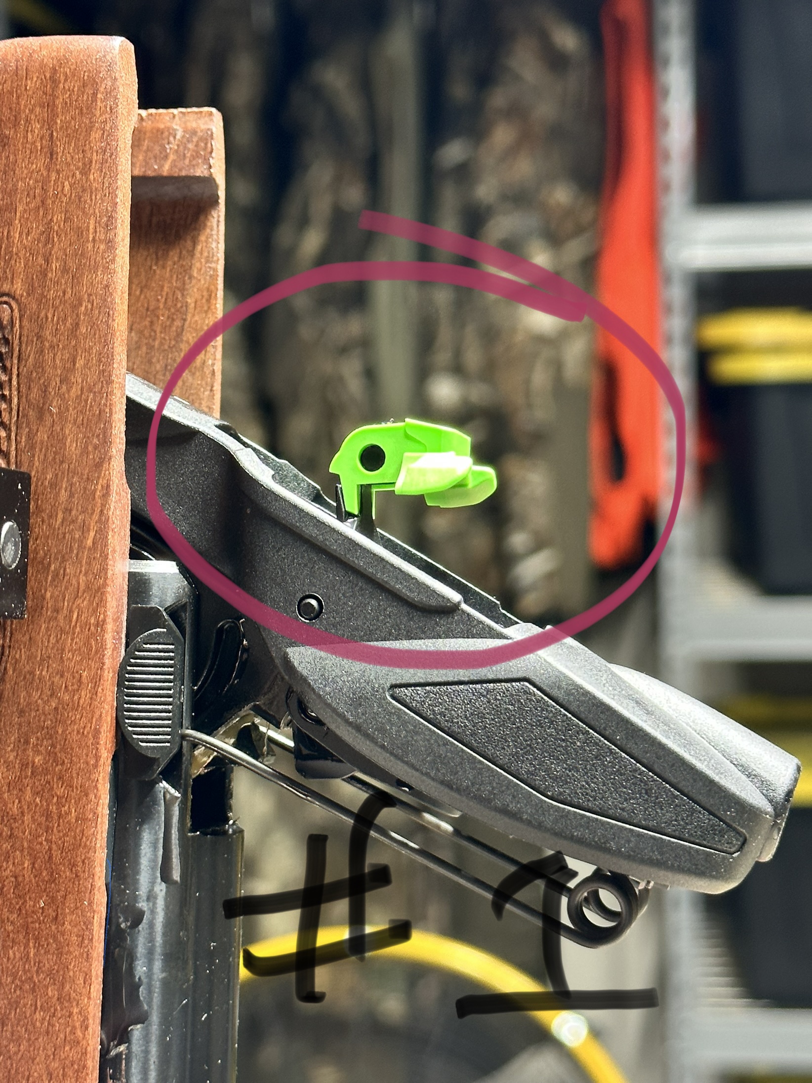

In Pic#2 it’s in the right position but I had to manually push it into the correct position (it moves easily) but once a magazine is in the loading dock (for some reason) it doesn’t automatically line up?
