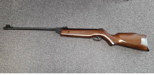

Only have two Gamo pellet guns. A Expo 2100 and a PR776
