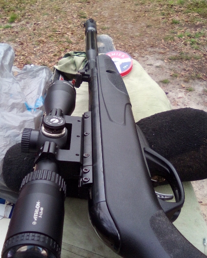

I went through a hand full on my whisper fusion mach1 .22. But this athlon talos on the gamo package scope mount held up under it.. of gamos package scopes only one holds zero but poor focus..
Talos
Gamo package
Outside them its pretty much rattled them out ..

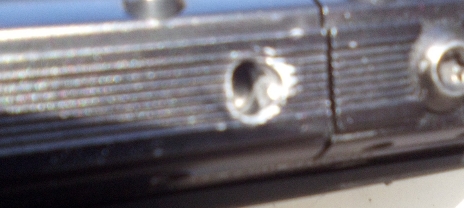

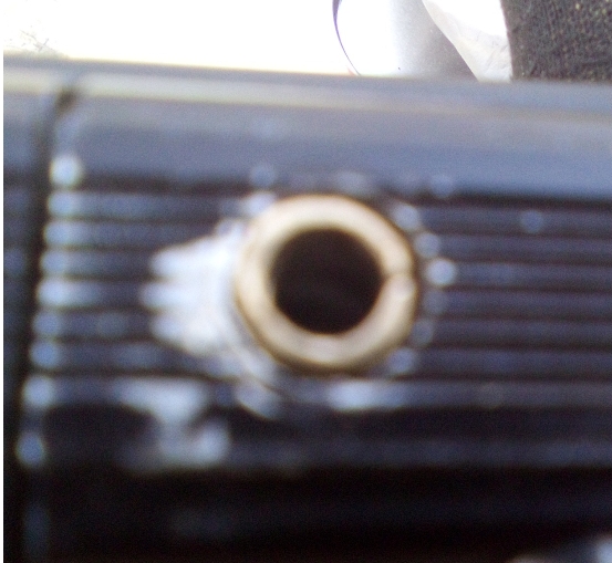

Anpther thing is the gamo rrr its soft and the stop pin hole would egg out from recoil with thin or skinny pins and cause scope shift .. i made a bushing to help stop this and its worked great .
Also a fresh new gamo is pretty harsh bit should calm down a bit with lots of shooting . Just takes some time for one to.. i cursed mine often but ended up one of my better shooters in the end..
I’ve got the egged out locking hole, and the drills, reamers and bushing to correct it, thanks will give it a shot

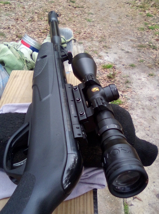

What kinda scopes and mounts?
Talos
Gamo package
