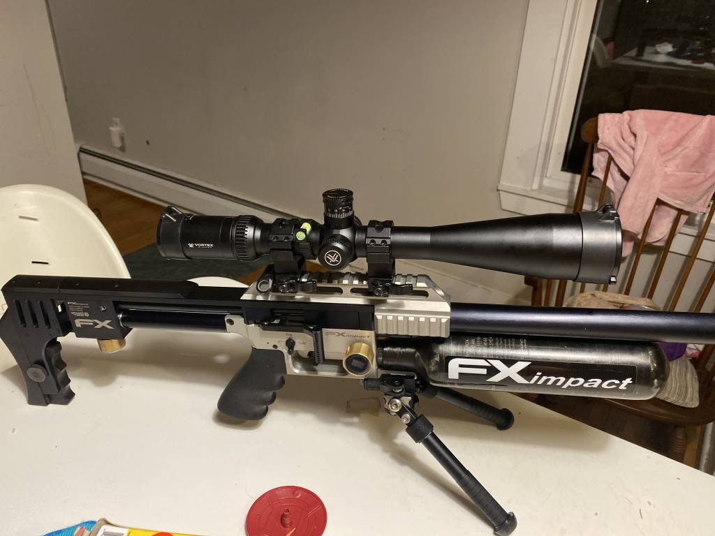

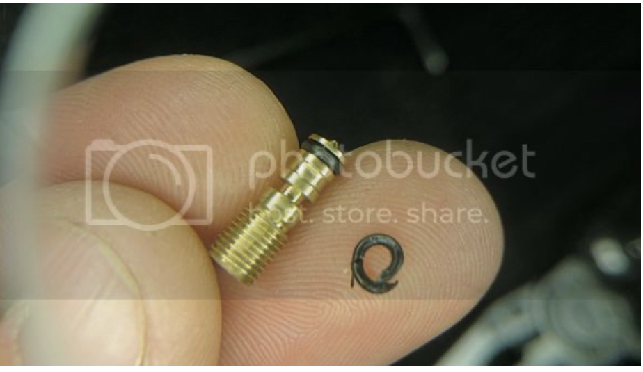

Did fx has better o’rings o regulator for the fx impact gen 1 mine always has given me the same problem.. I when shooting after like 2 years and leave the rifles in the truck two days today I bring them in and nothing the reg gauge was showing the bottle pressure, after checking it notice this
I already replaced them and switched the barrel for a .22 tomorrow I’ll be doing the tuning..
Sometimes when adjusting people go past the point of no return on reg adjustments and the o-rings get damaged as a result. I think it is a pretty common problem. Might blow out completely right away or, if only slightly damaged, cause a leak later
I think the quality of o-rings has slipped over the years as well. Good that you were able to figure it out and that it is not too difficult to replace.
