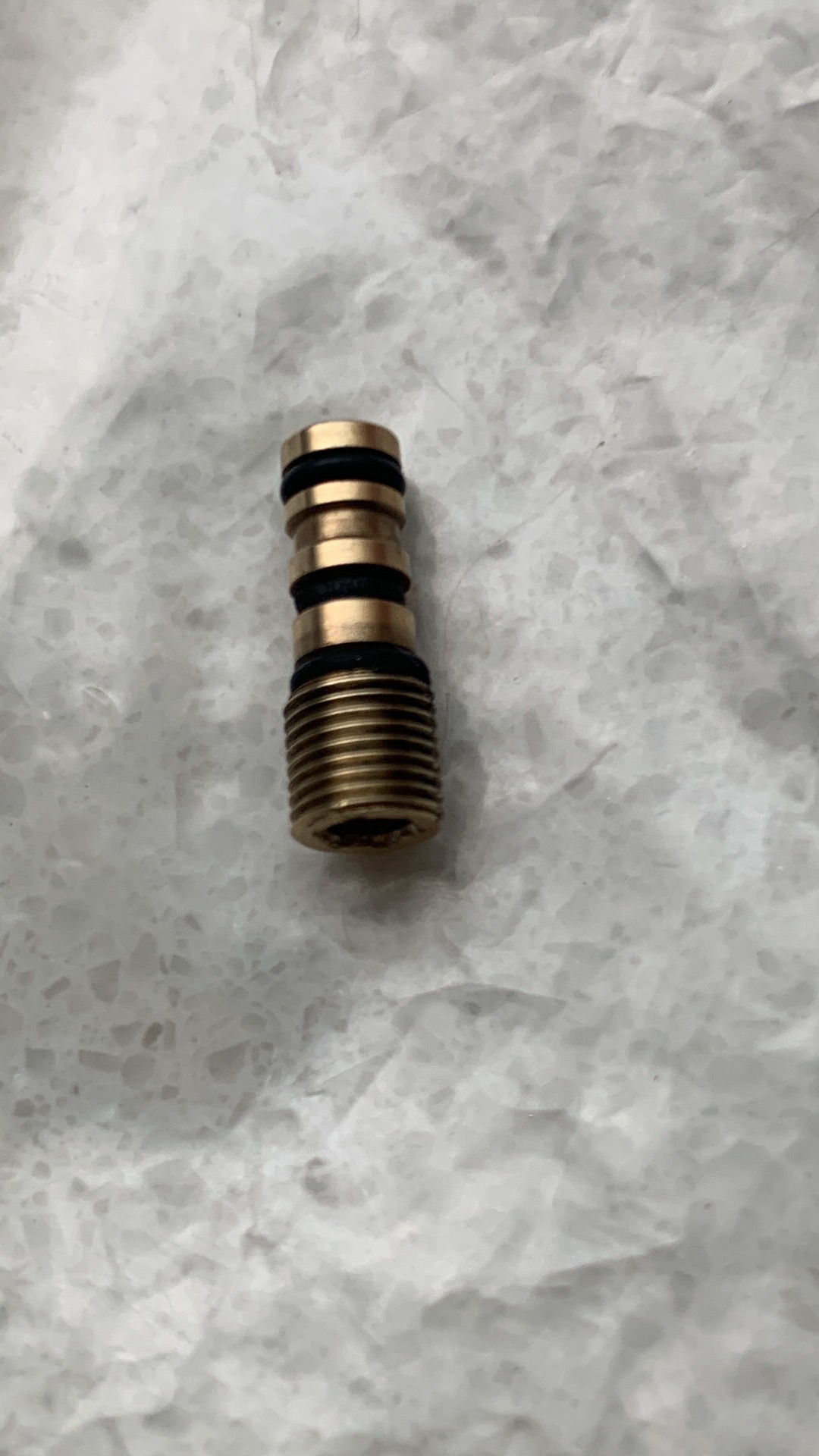

Der zweite Regler scheint nicht richtig zu sein
What is it doing. That gauge on the end is your tank pressure
In English please
the problem is the regulator. think the transport without pressure in the bottle has damaged the seals.
I took the little one out but I can't see anything.
