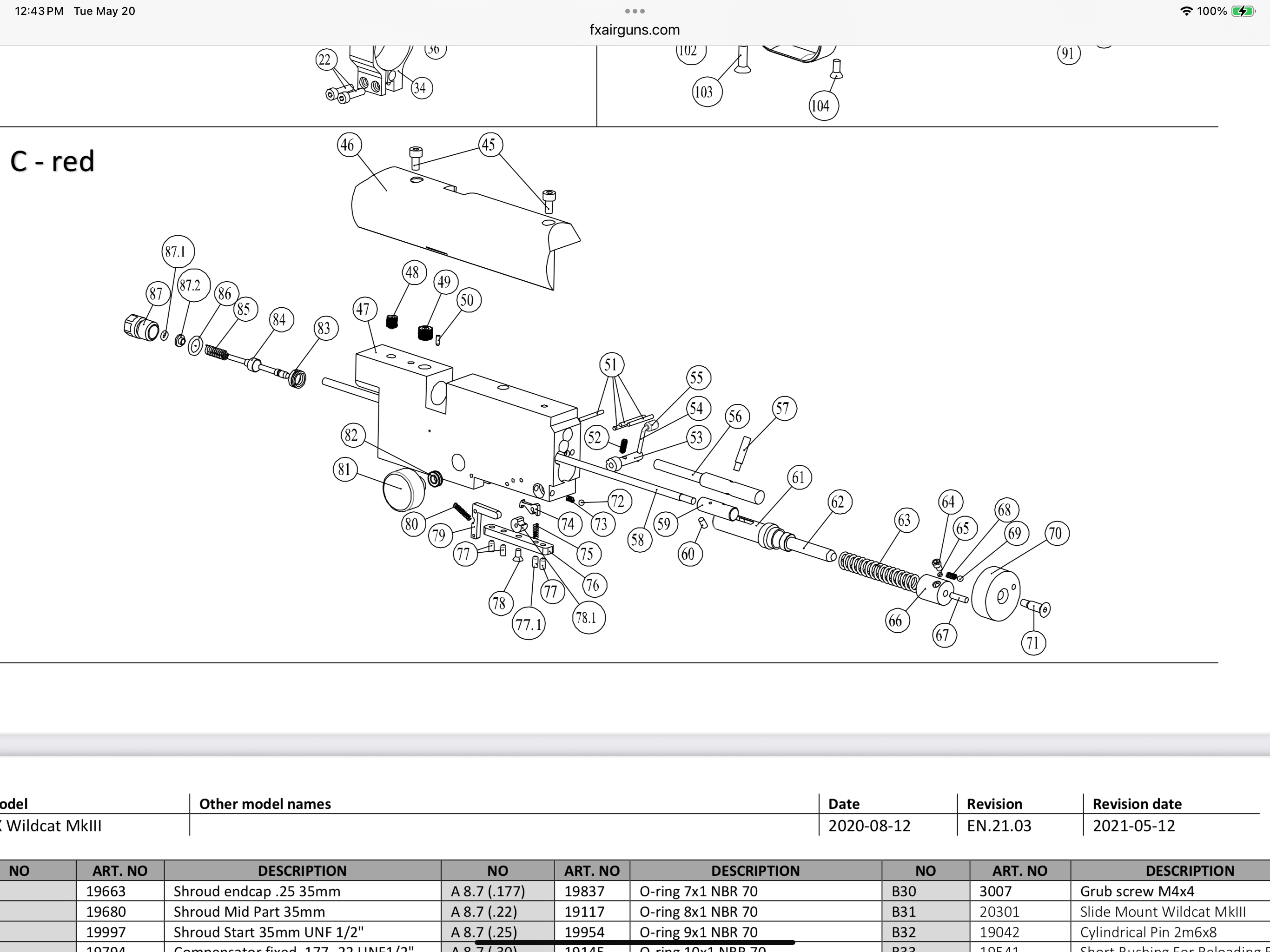

Check if parts #68 and 69 are in place. This is the ball and spring for the power wheel detents, to keep power wheel from rotating freely.
Reactions: MongooseV8
FX Wildcat MK3 power adjustment wheel moves a lot. Does anyone know how to prevent accidental movement?
