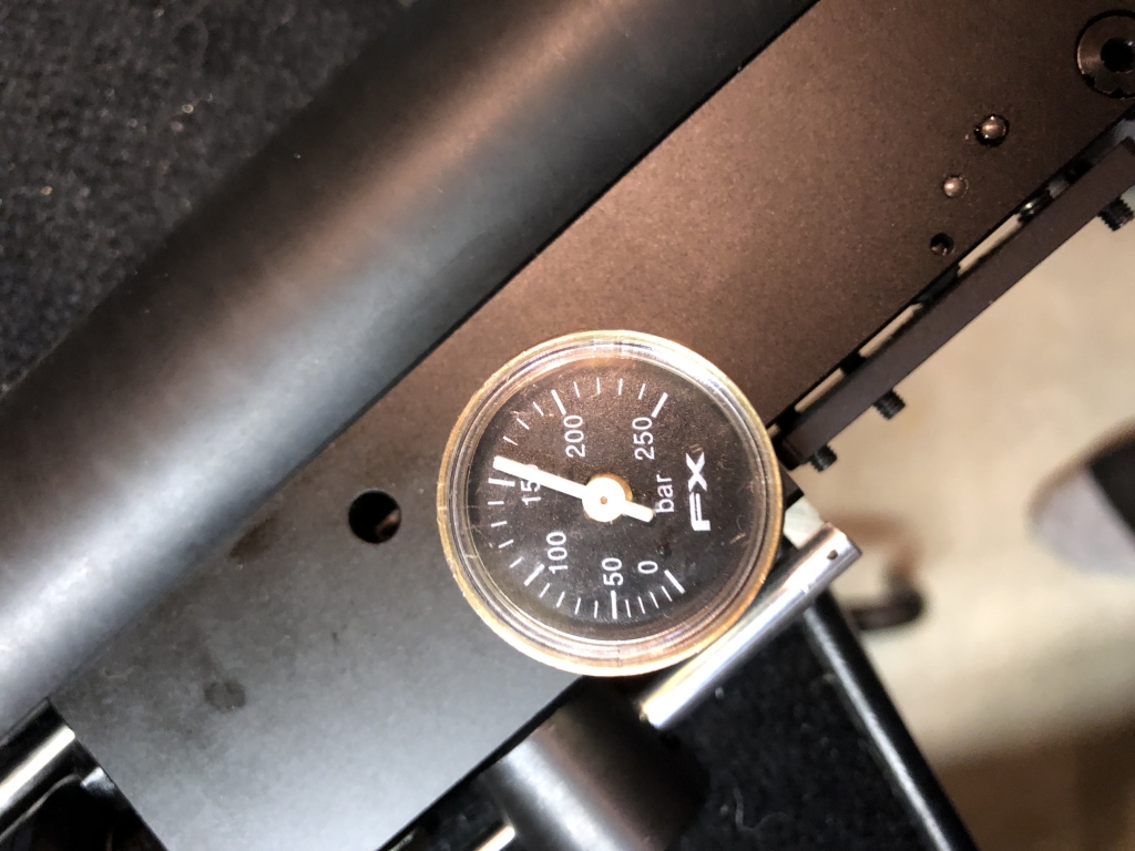

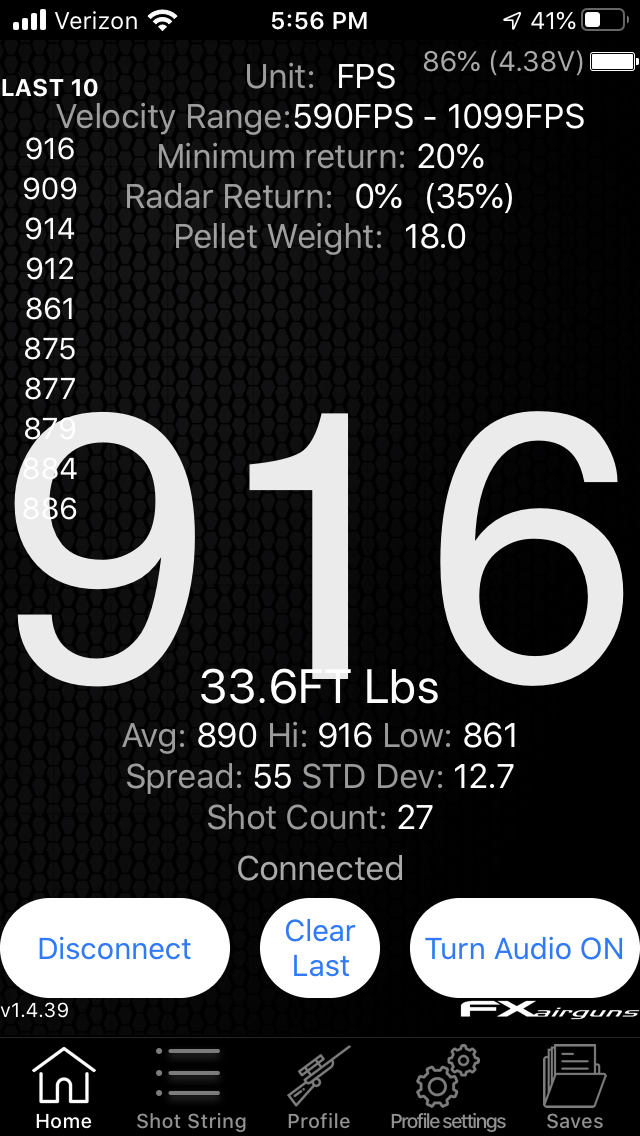

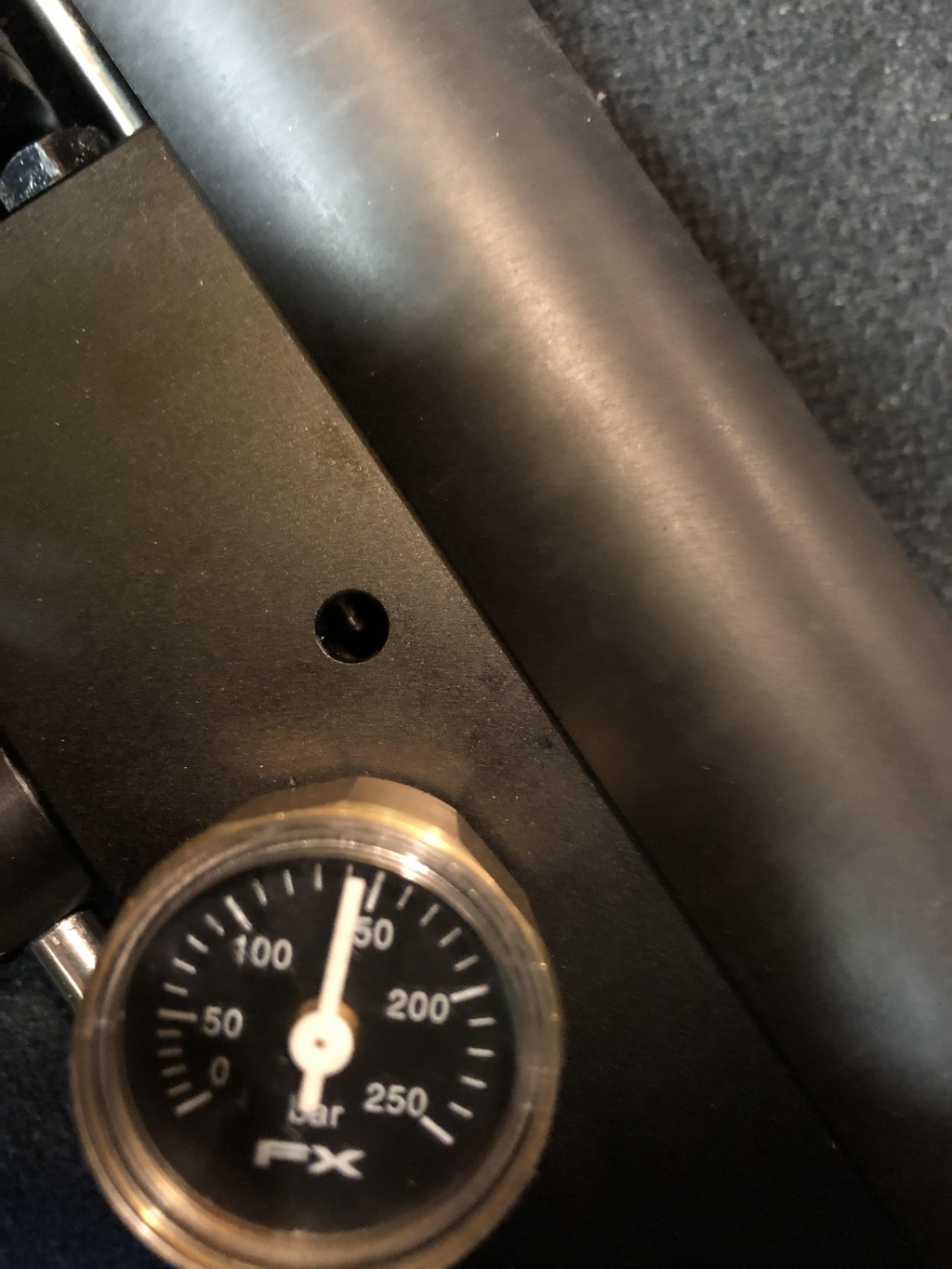

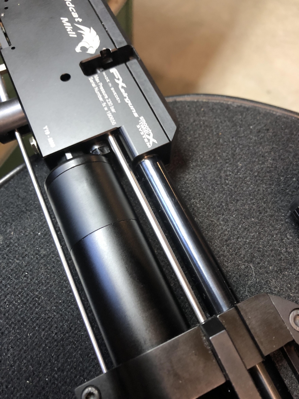

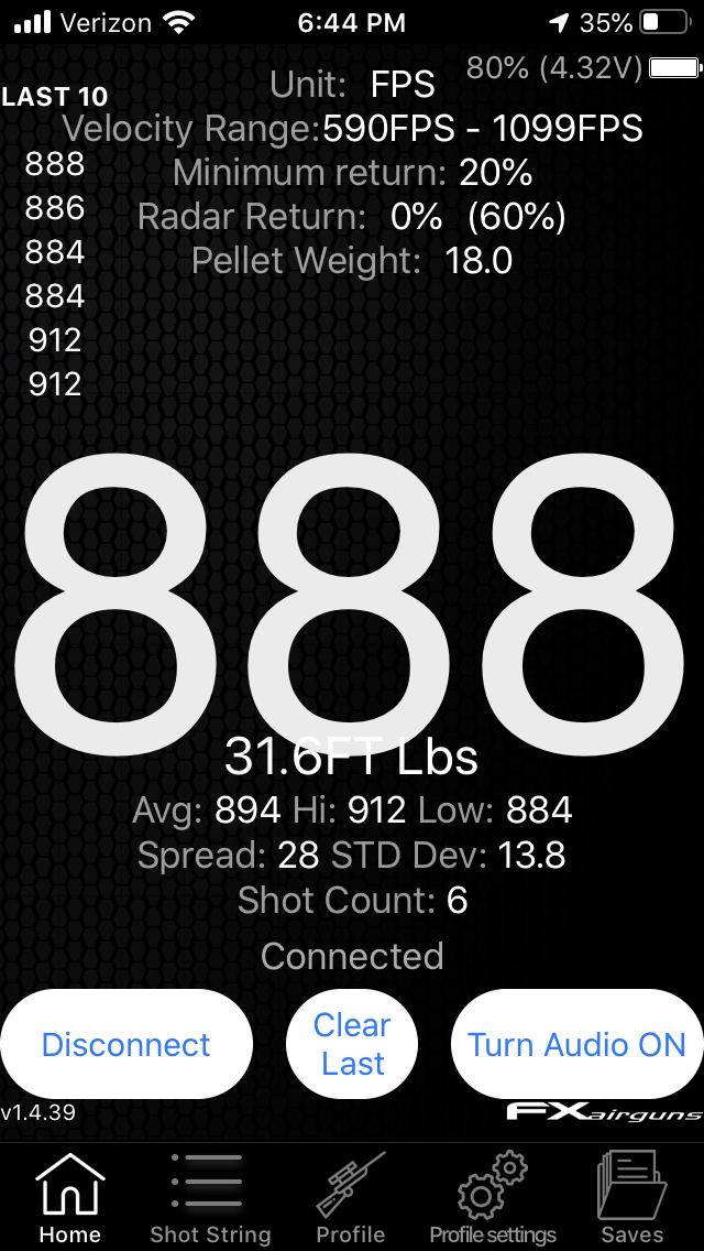

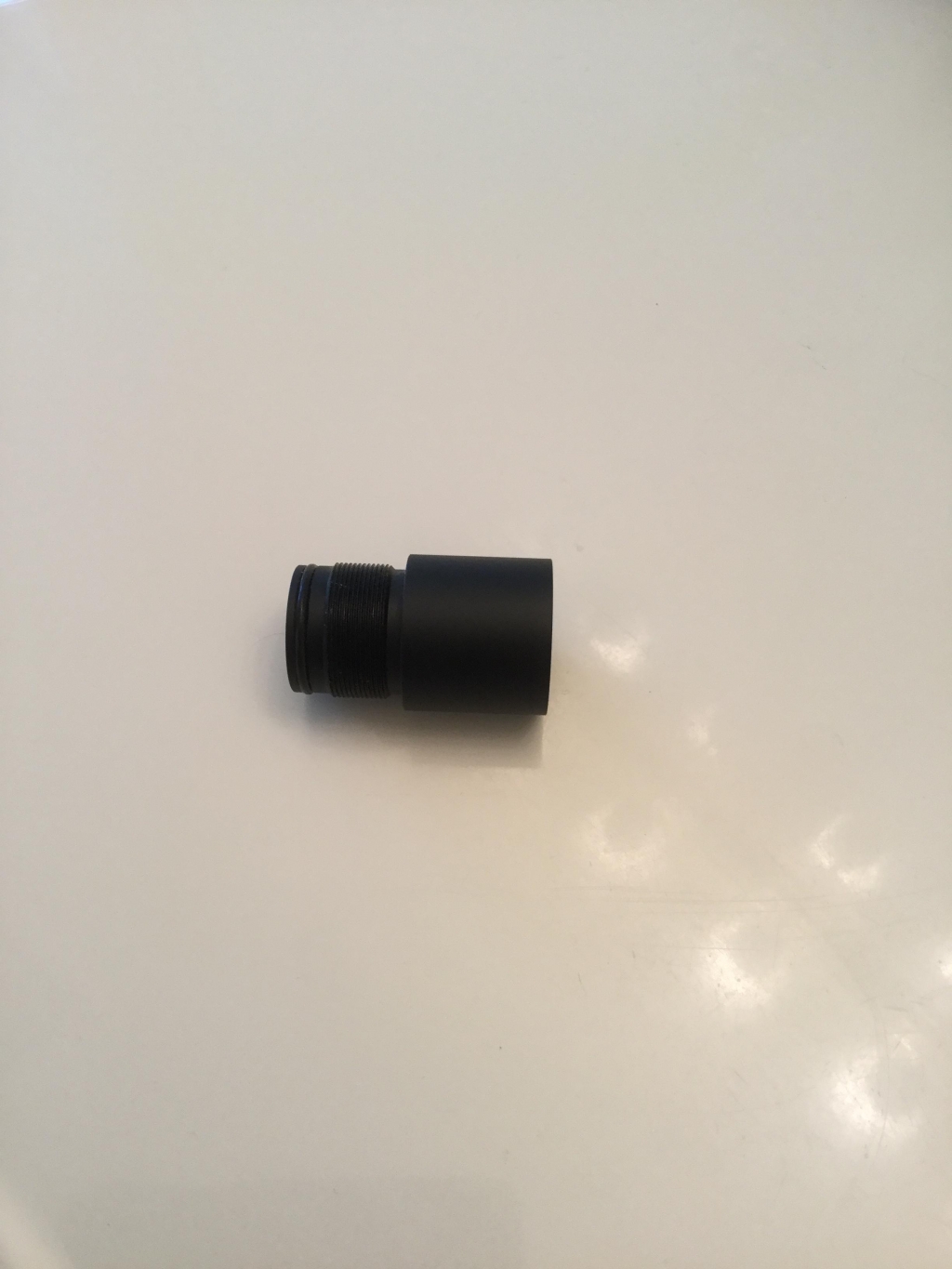

Ok, set up target early this morning because the wind finally died down, from a 230 BAR fill I was able to get 38 shots before I noticed a POI change, I looked at regulator and the needle pointed right at 120BAR, so even though velocity starts to drop after the fourth magazine I was still hitting the same aim point. The POI really dropped dramatically right at 120 BAR. I am thrilled with the addition of a plenum to my WC, wish I also had a standard size .25 and a .22 to test as well. On a side note I can hear the plenum filling with air with each shot just like my Impact.
