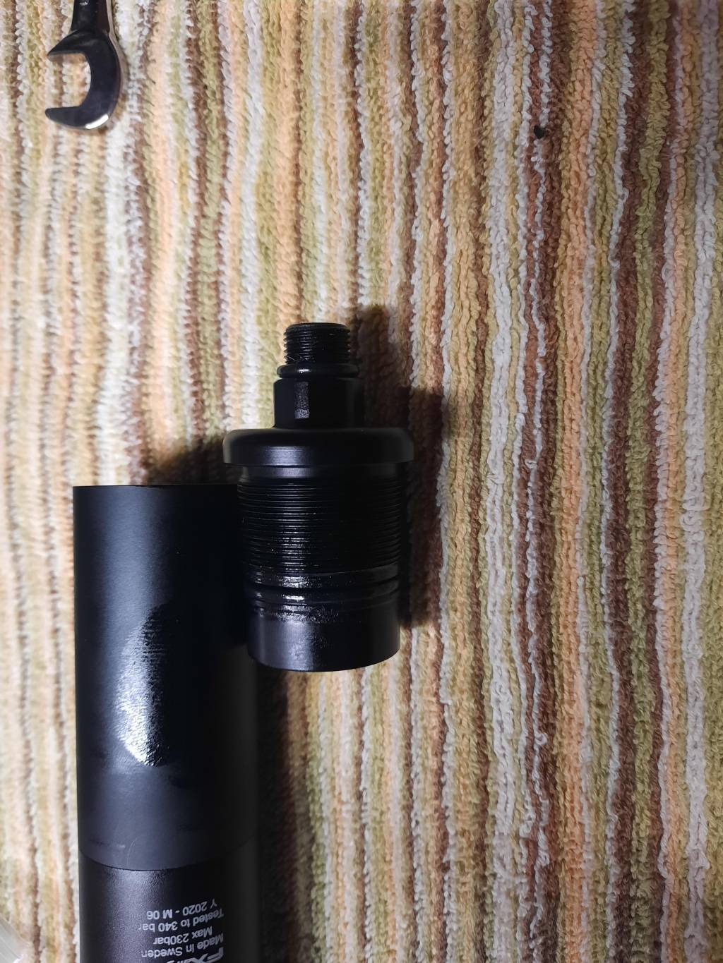

More to it than the size of moderator you can use with the plenum extension. The cylinder end cap doesn't thread fully into the plenum extension due to a plenum spacer that is incorporated into the end cap of the newer MK3 Wildcats. Also a spacer needs to be inserted between the regulator and the plenum extension to keep the regulator adjustment screw accessible. If you have access to a lathe you can modify the end cap and make regulator spacer so you can use the 2.5 or the 1.2 plenum extensions from 910 airguns. If you don't have a lathe or access to one you are S O L.
Above is the newer design.
Below is the older end cap for the plenum on previous WC's and apparently only the first X number of MKIII's.
Hopefully you can look at your WC MKIII and see which type you have.
