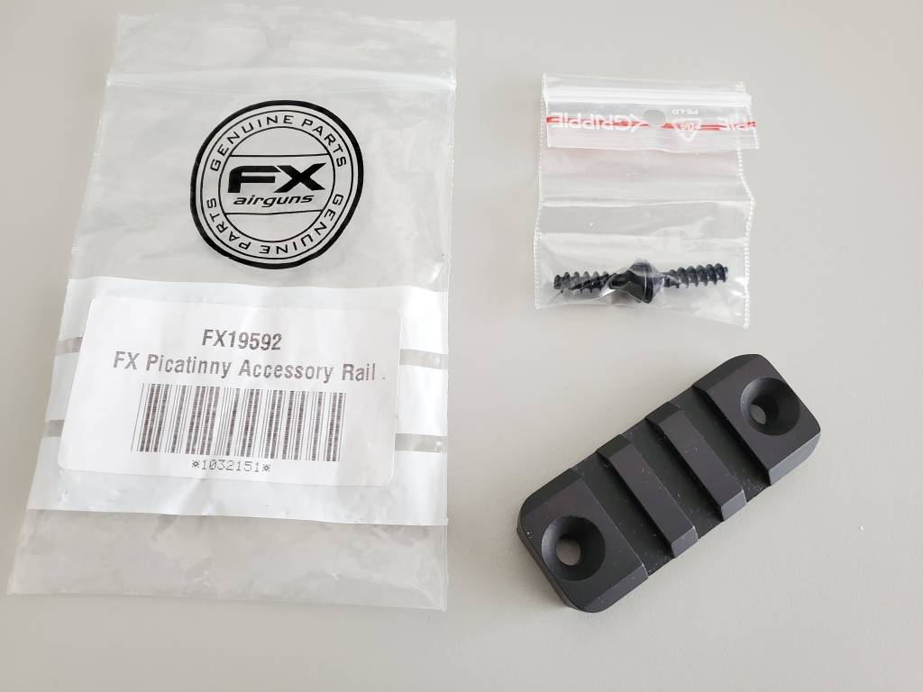

I bought my Wildcat from Utah Airguns. Great shop, they sell a polymer rail for the Wildcat:
https://utahairguns.com/picatinny-rail-install-kit/#product-description
I got the FX brand picatinny rail from Airgun Depot. The UA version is plastic and has more slots. The FX version is shorter but is aluminium.
There are certainly no wrong way to go here, just personal preferences. Considering the Saber Tactical piece to avoid drilling into my stock.
I wouldn’t trust those tiny screws to keep that rail in place. All it takes is a few sessions on the bipod, leaning forward into it, and those screws will wallow/strip out. What gets me is those same two screws issued out with those rails are suppose to work on all three types of stocks offered in the wildcat platform- walnut, laminate, and synthetic.
If you’ve ever pulled the stock off of a synthetic stock more than once, you’ll understand when I say in time those screws will strip/yank out, as the stock screws in and out on synthetic start like “reaming” out the holes in the stock. Just the spring back snap when the bipod is deployed open will start yanking on those screws.
The best method is to bore out and use the inserts like TOMINCO has posted up in the past, and epoxy in the inserts for a tough, forever strong, bolt on deal.
