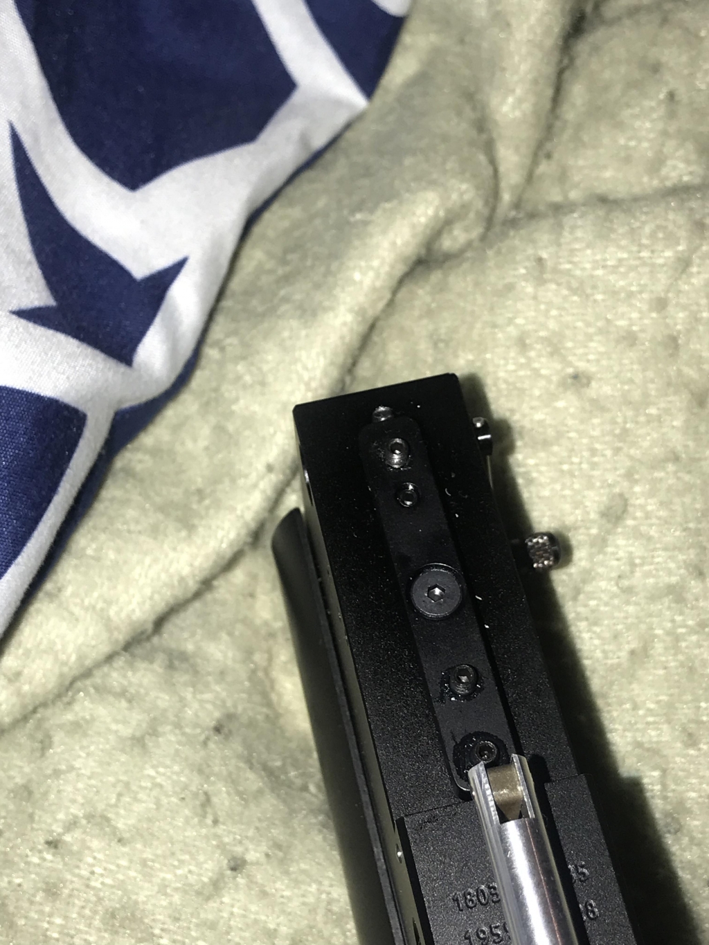

Does this have the amp regulator in it.
It is not possible to tell from this picture of the trigger adjustment block. Look at the rear of the air tube and if it has two large 1/4" holes with a round black rubber ball in one of them then you have the model with the AMP regulator in it. If your air tank has only one tiny little vent hole in it then you have one with the old style regulator in it.
